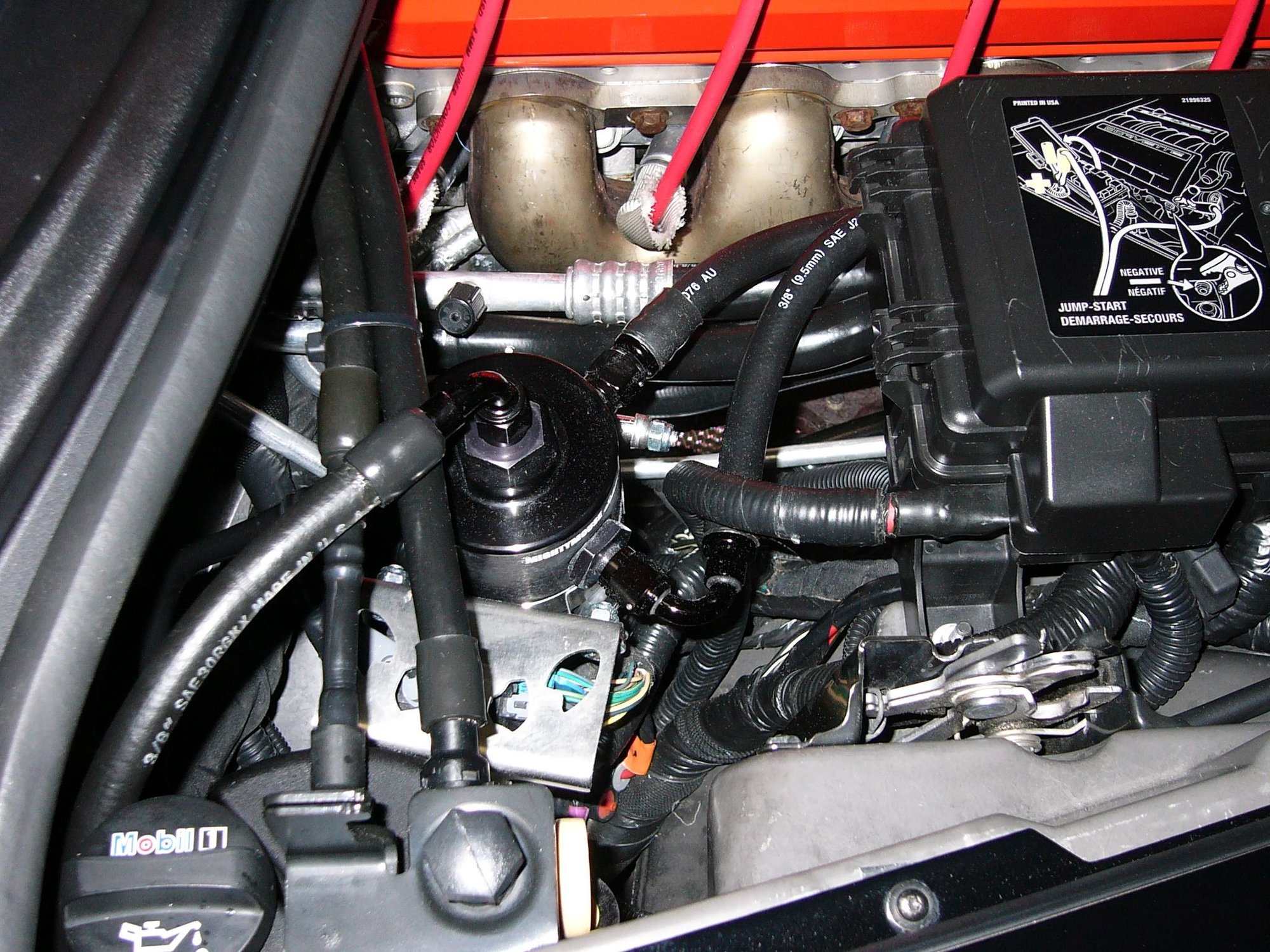

Mostly I just read other post here. But I thought what a great place to get some feed back on this issue. Looking to put a catch can set up on my Z06 600 rwhp. I finally have this thing sorted out. With the issue with the heads taken care of etc. Now looking to do a few track days in it. (Road Racing) here and there. I see the Might Mouse set up seems popular with a little different plumbing set up for this use. I've looked at a lot pf the different possible set ups. But based of the space limitations. I was sure how many different set ups are viable. Any feed back would be greatly appreciated.

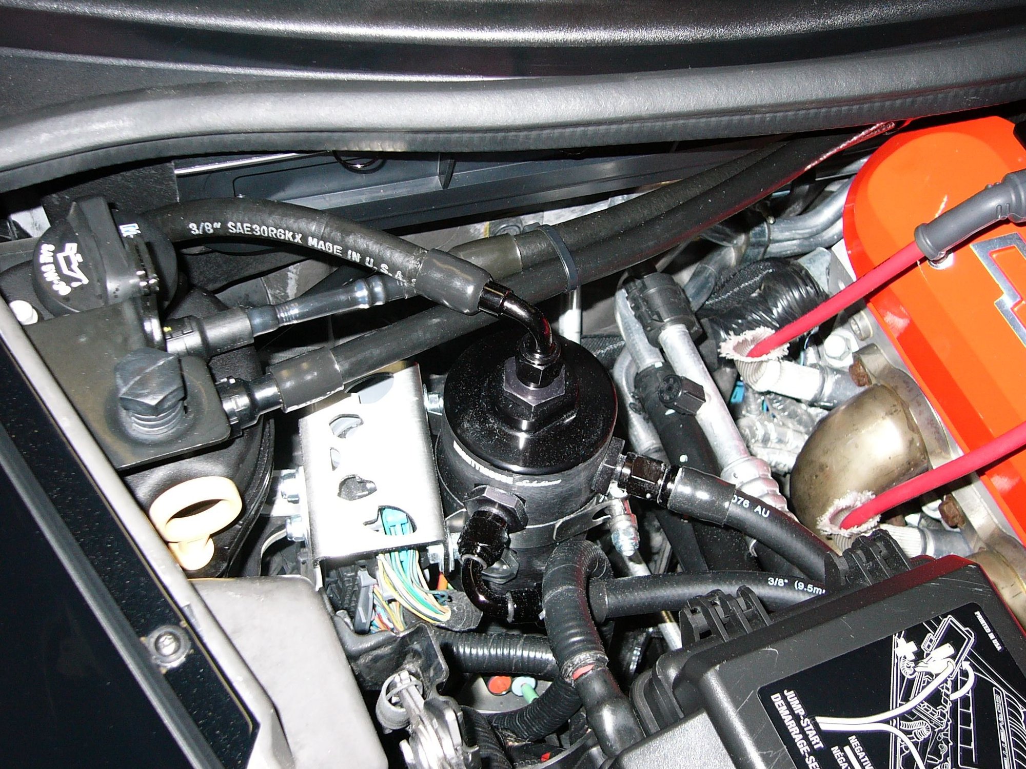

Here's a Mighty Mouse catch can with the "road race" top fitting on a Z06. Easy install using the supplied brackets & hose fittings.
