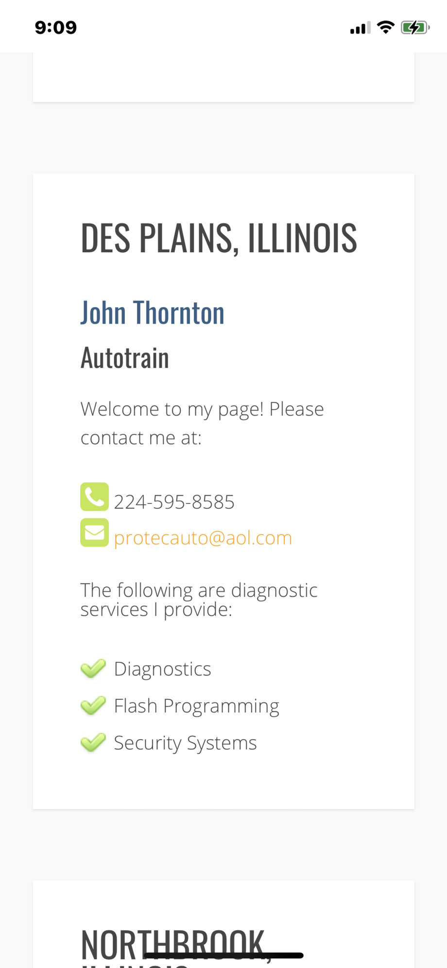

Sorry to hear about your car but dealerships and “Corvette Specialists” sometimes aren’t the best diagnosticians and that’s what you need…call this guy below…John Thornton is the country’s foremost automotive instructor and operates a mobile diagnostic company…if he can’t fix it NO one can !!..video below so you can get the scope of his knowledge and has done instruction on push start ignition diagnostics !!

Thank you, C5 Diag. I super appreciate this lead that isn't too far away from where it is parked now. This may be something I pursue. I've found that the car will not be applicable to lemon laws and doubt i can make any form of insurance claim on it. Whether or not it gets fixed by this new sensor, whenever it really shows up, I'm left with some difficult decisions that I never fathomed I would have to make so close to after purchasing it. Until then, my life frozen with an ever growing hole in my bank account, anxiety, frustration, and absolutely no fun to show for any of it.

No problem !!...like I said if John can't fix it no one can...I'd try to offer help but my knowledge of these push start systems is limited...I may just have to buy his webinar on this topic...with it not starting it may just be a communication issue but you'll need a labscope to diagnose this !!
