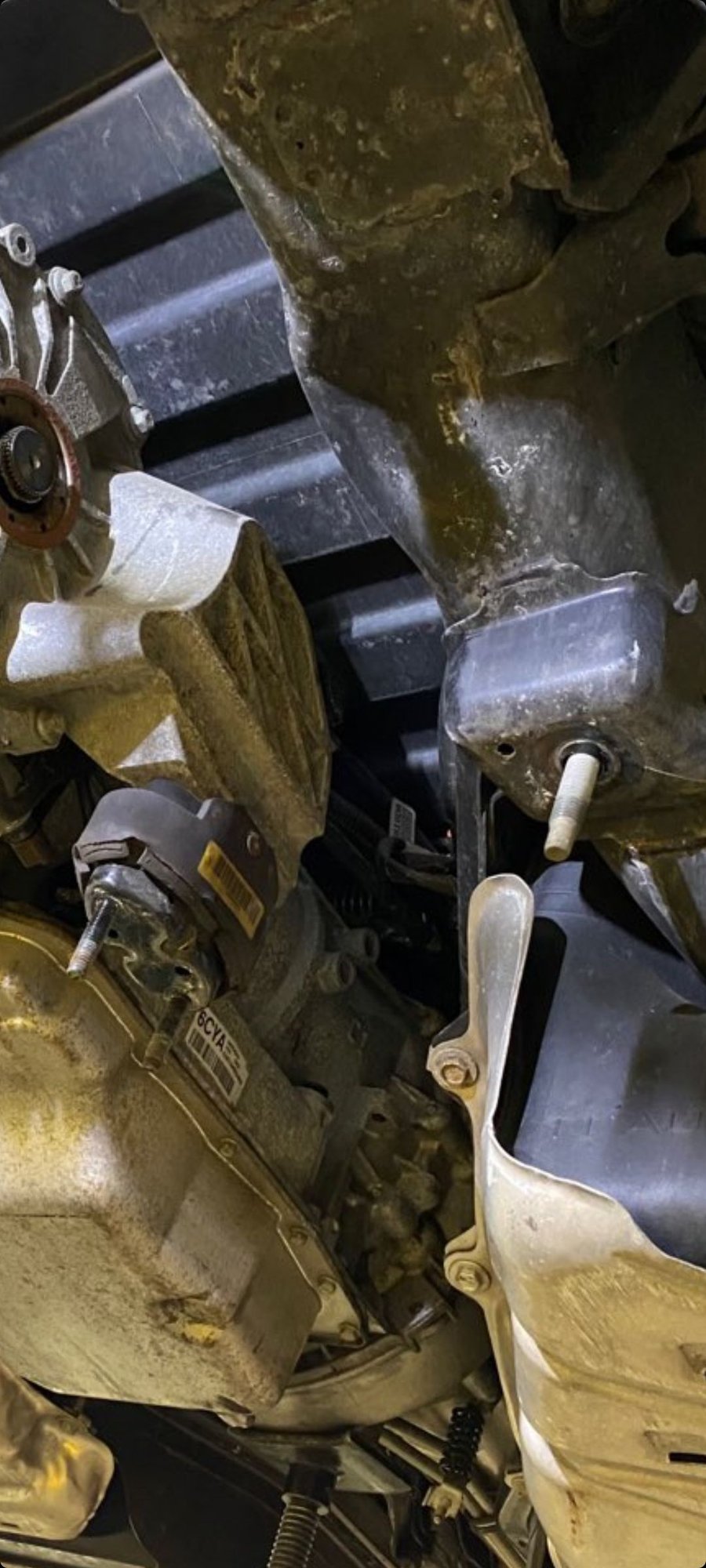

Right rear frame rail looks crushed or is that how it supposed to be?
Yep, that's definitely been crushed and not supposed to look like that.
wow.

Agree, mine is not dented in like that.
Maybe axle snapped and knock the crap out of it? I dunno.

probably been in a rear end crash. the frame buckles over the cross shafts. nearly impossible to straighten out properly w/o lots of pull and torch heat, big hammers. i bet the rear cross member was replaced and the car has been on a frame machine.

Pull a CarFax report to see if any damage repair is listed.
