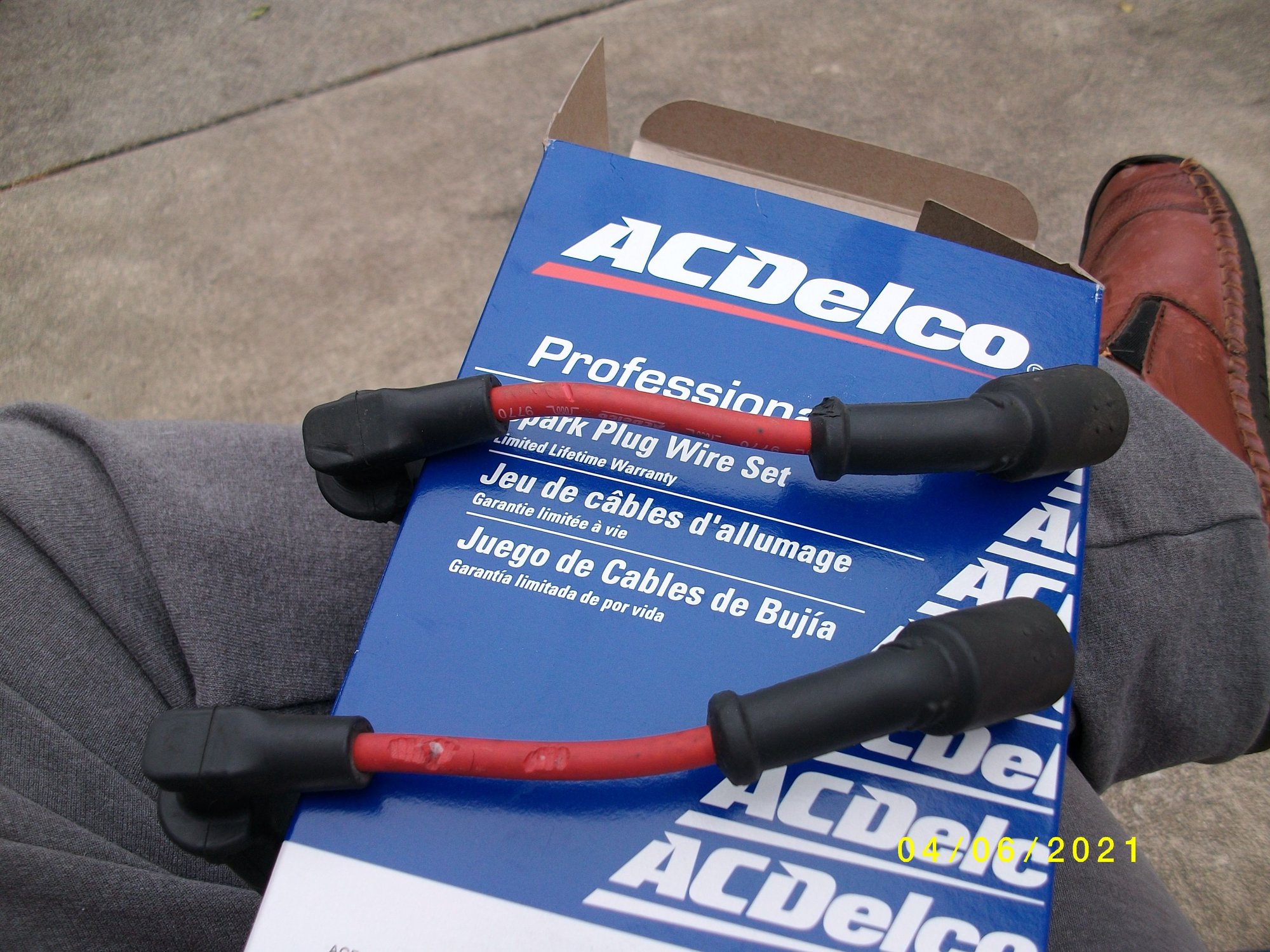

Well the rain let up and I took it out for a nice, fast 10 minute drive, and the miss, the one that I paid $159.99 at the useless, stupid Stealership to fine, and couldn't was just a worn out set of wires, and there wasn't any corrosion or a bad plug/s, I checked as best possible to see if there was any carbon tracking down any or the plug insulators, and I was pretty sure a set of AC Delco Iridium plugs don't wear out in 21K miles. So it seems it was just a bad set of wires, all I could find upon inspecting them is these two ?
