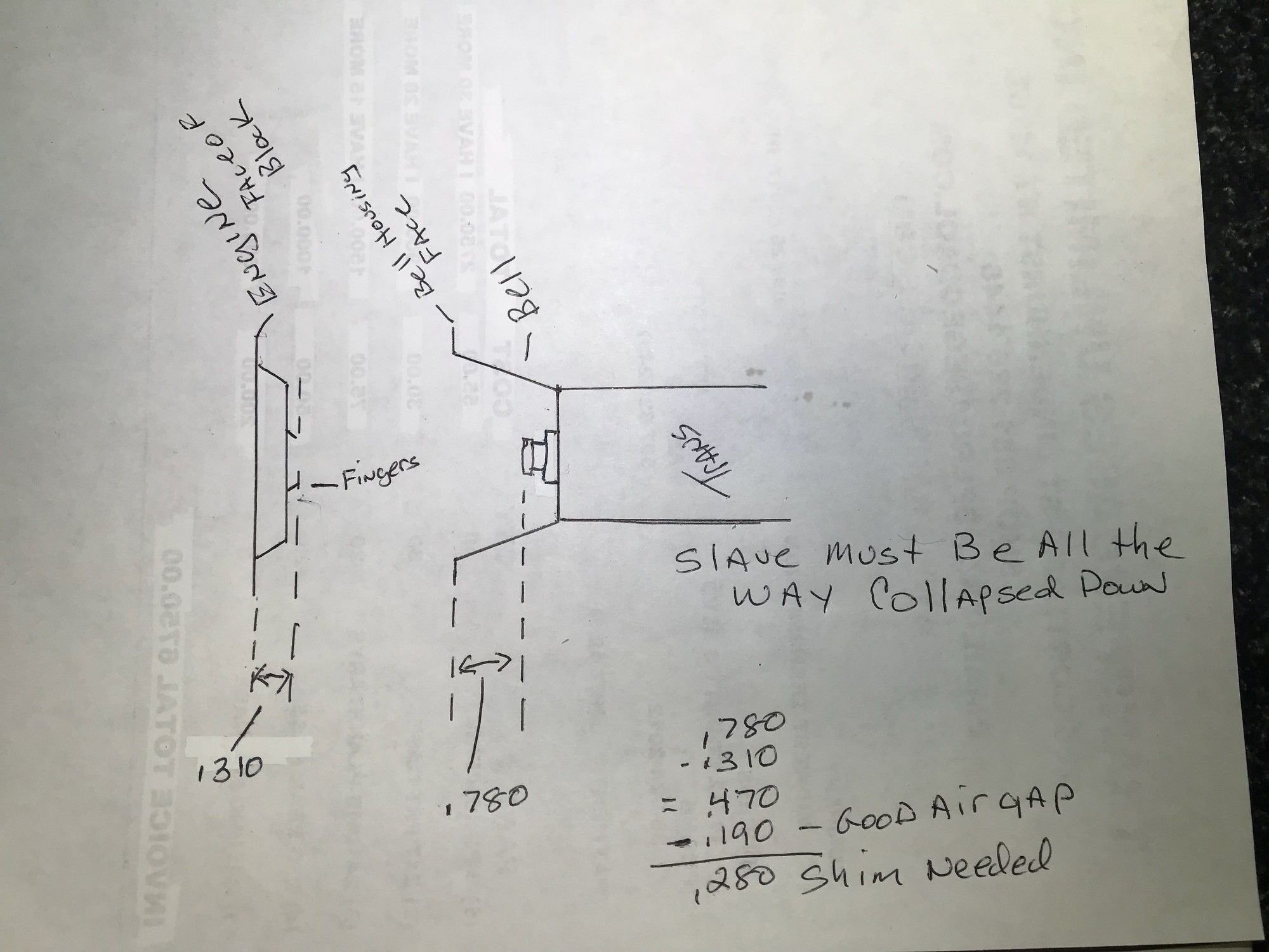

whatever clutch you choose, make sure you measure the air gap. numbers are for reference only, yours may not be the same.

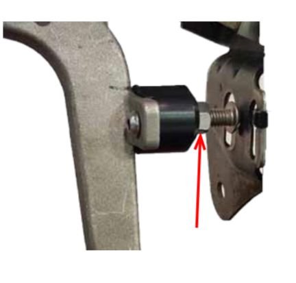

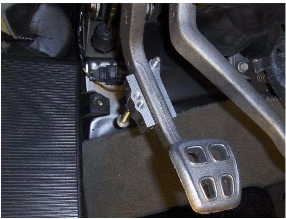

Lingenfelter clutch stop
I’ve been using the Lingenfelter clutch stop for awhile now. Works great and it’s 1/3rd the price of the ECS unit.

Ya the ECS one look like it was 100$. It looks a lot beefier than the one you posted here, but I cant imagine that matters much on a part like this. If it works, it works.

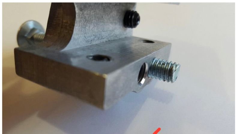

Looks can be deceiving.
The ECS is held on by 2 set screws that pinches the pedal.
The Lingenfelter has a larger bolt that goes through the pedal and into the clutch stop block.

Mines a ’09 so my clutch switch is a rotary sensor so the clutch switch stop adjustment on the ECS wouldnt do anything for me. I think it was either ’08 or ’09 when they switched. If you have to older microswitch, the ECS version would be the one you want to ensure you can engage and disengage the clutch switch.
Just saw your profile. So assuming it’s going on your 2011, the ECS clutch switch adjustment will be a useless feature. Keep in mind the ECS requires you to cut off the tab on the pedal, so you wont be able to install the Lingenfelter if you decide to switch because that’s where it mounta. You may still need to go to a dealer/shop to relearn your clutch position depending on how much adjustment you’re making.
