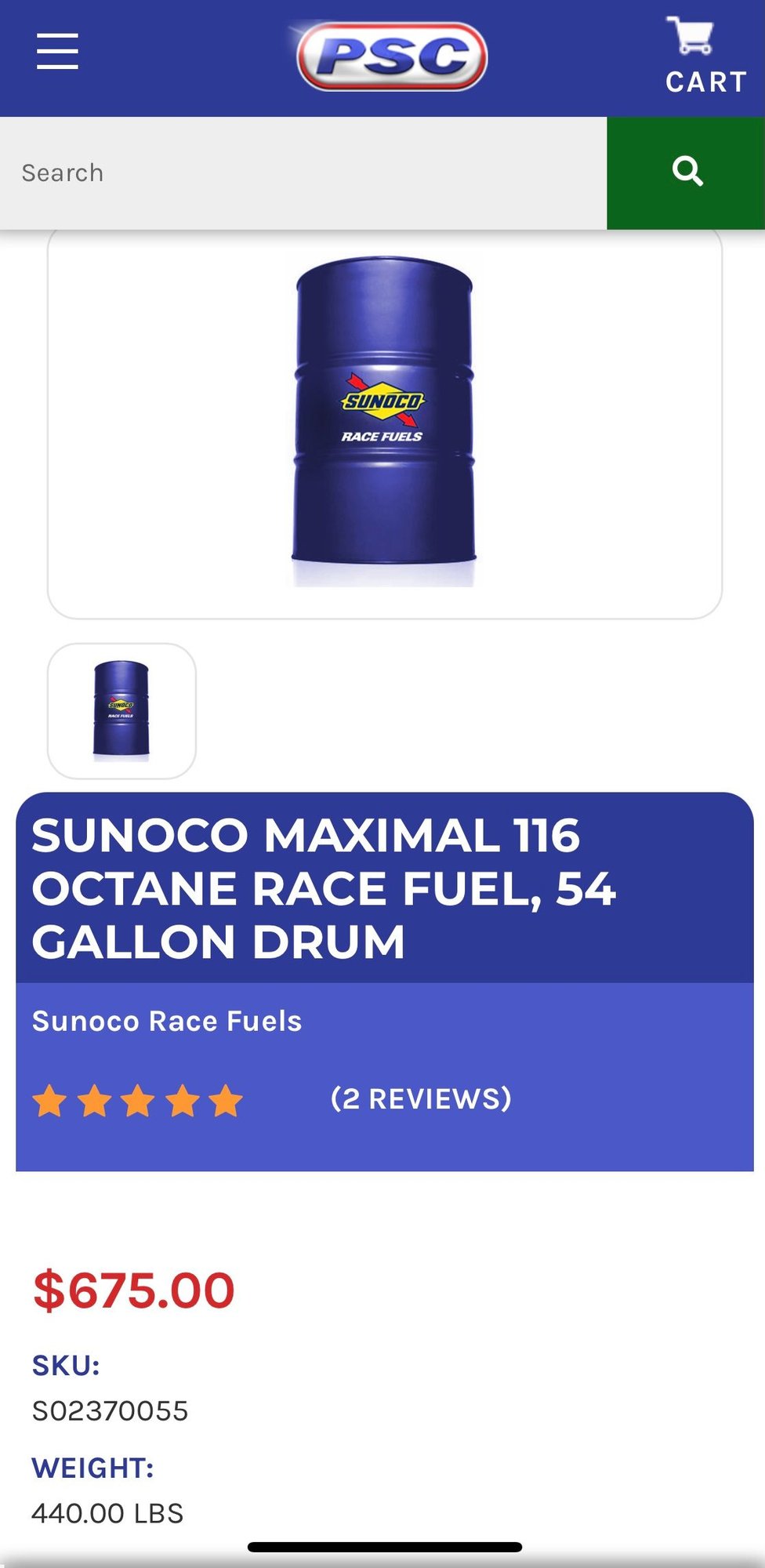

If you want 116 octane you can get this !!
