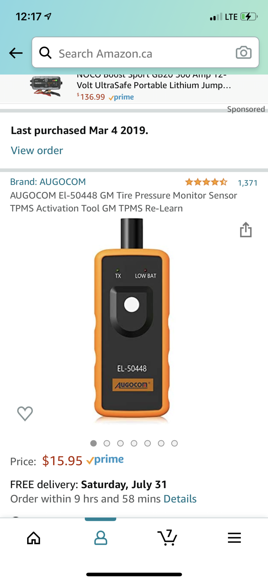

Thanks for the reply guys. I actually tried with the tool (picture below) but it didn’t last long..after abit of driving around it would come back.

Are you stating that your did the relearn procedure with EL-50448 with the car in ACC mode. Did the car indicate that it was in relearn mode? Did you get one horn beep when you did the LF, then RF, then RR and two beeps when you finished with the LR?
