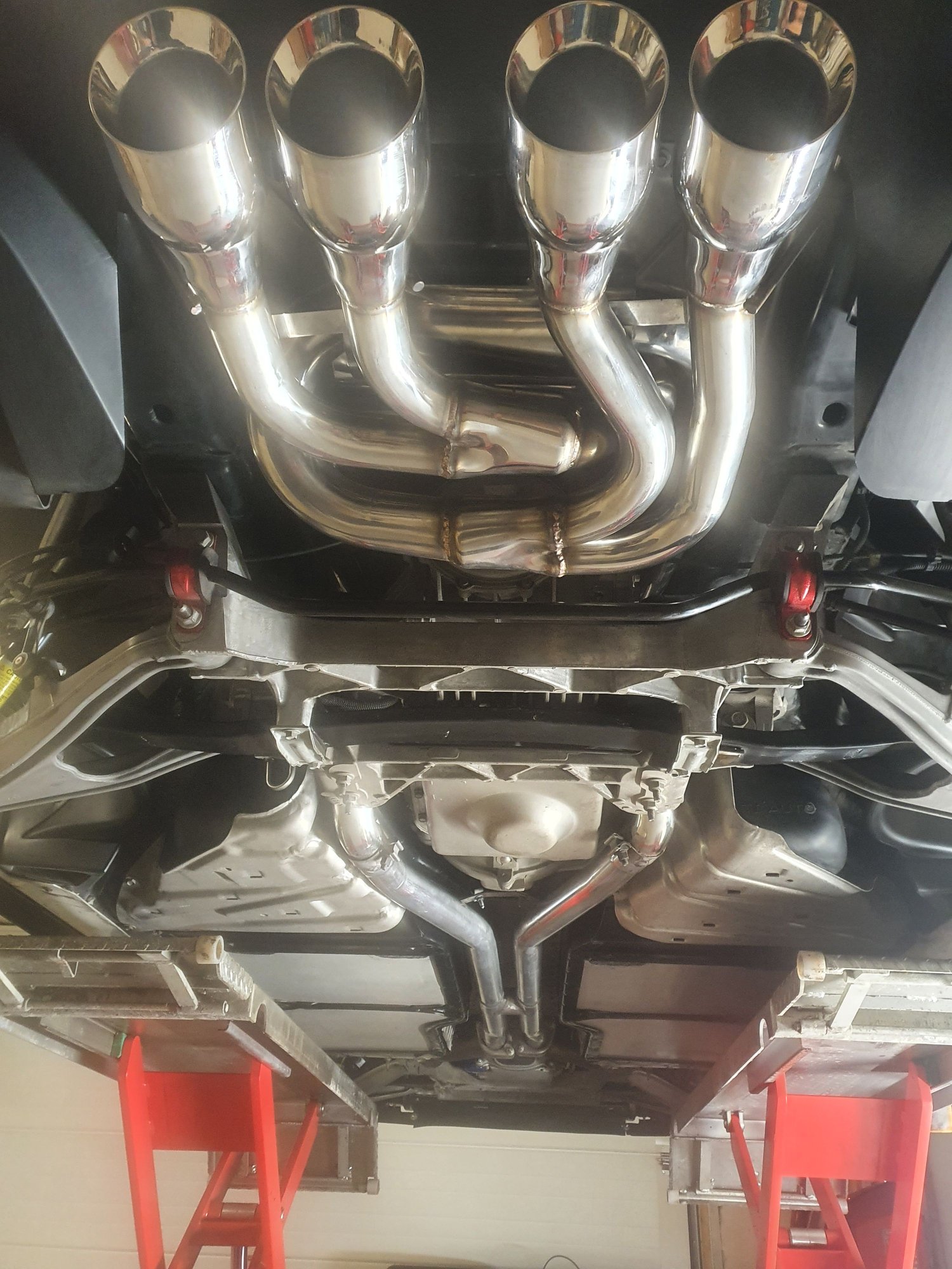

I bought a NXT axle back exhaust for my 2007 C6. It doesn't appear the right pipe that goes over the axle and connects to the H-pipe is correct. The left seem fine. Anyone have any experience with this and a solution?

Old Aug 15, 2021 | 01:18 PM
corvettenorway's Avatar
corvettenorway
Joined: Feb 2013
Posts: 1,173
Likes: 152
From: norway
nice fit on mine !

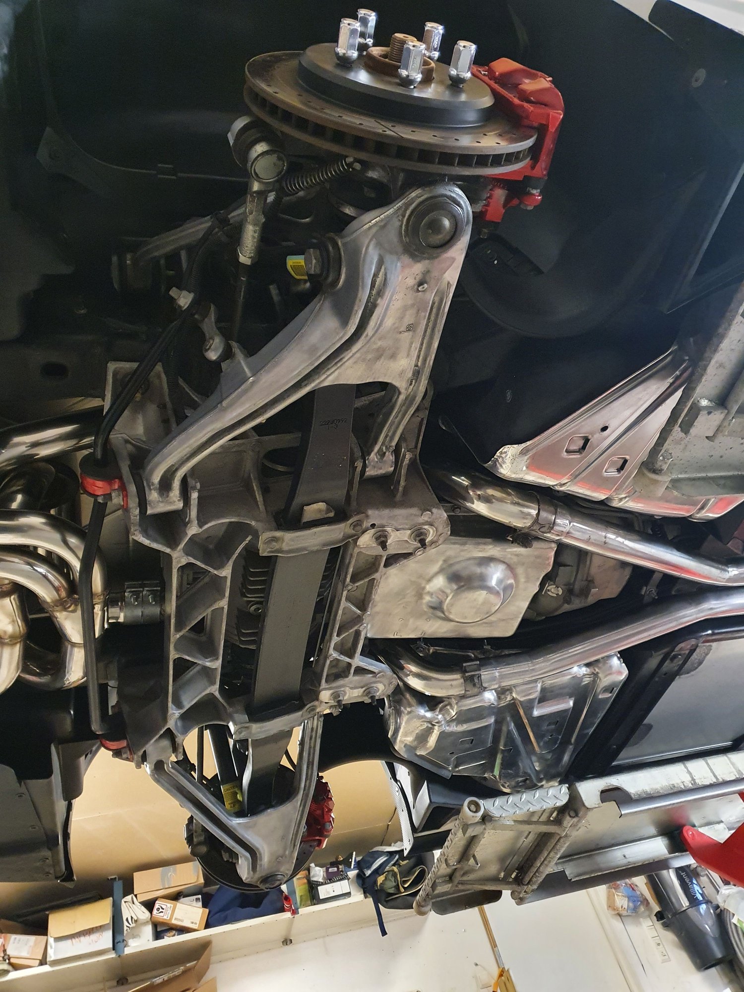

Old Aug 15, 2021 | 01:21 PM

It sounds like the mufflers you bought are for 2009 and newer, they changed the angle of the over axle pipe where it joins the X-Pipe in 2009. That or you have 2009 and newer X-Pipe.
