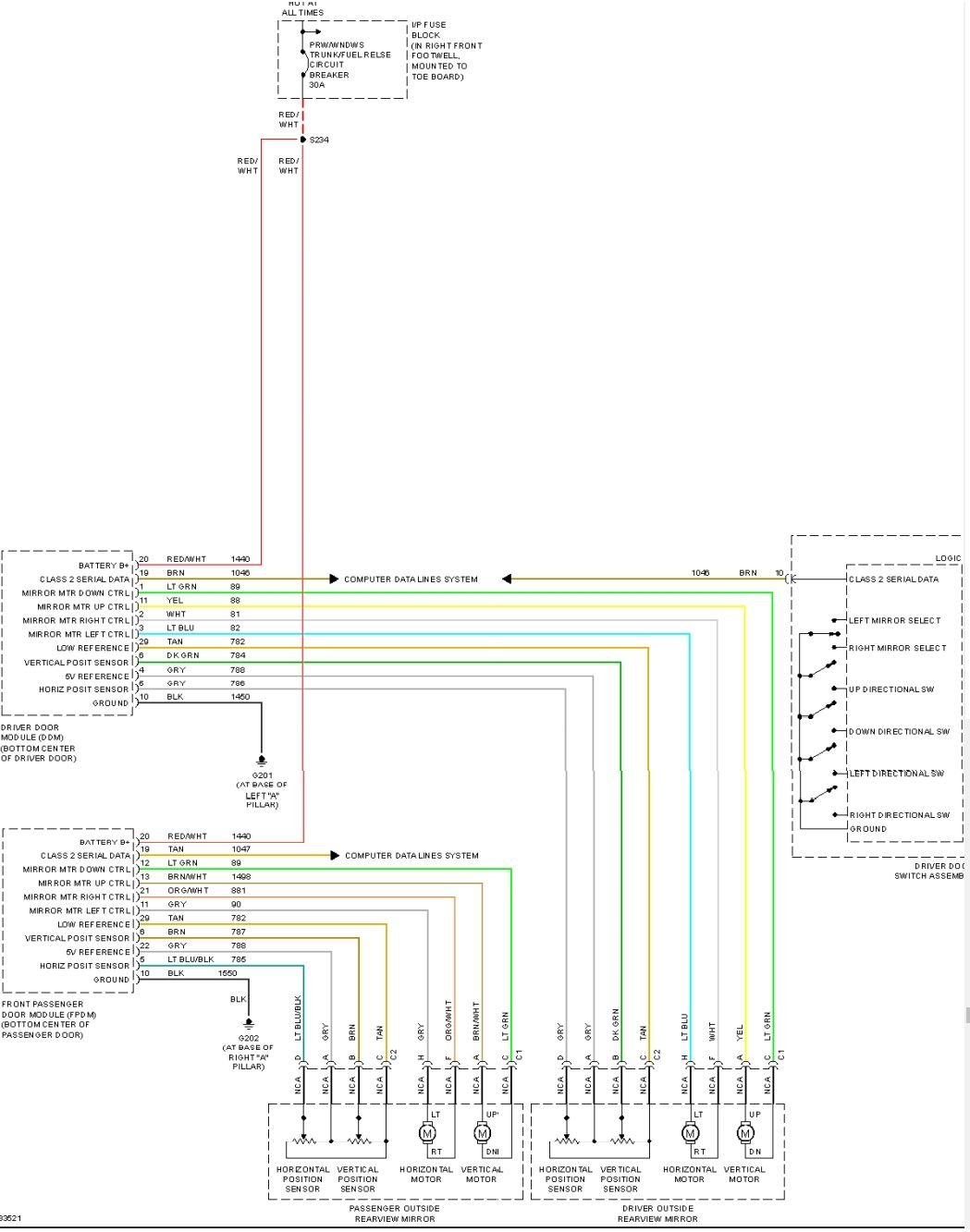

Here is the service manual section on the mirrors. Hope it helps you.

I apologize, the fuse was not listed on the electrical schematics on the first few pages. It just hsds the line coming from the electrical connection. The fuse also is for the power windows, trunk release and fuel door release, so if those are working, it's not the fuse.
The fuse is in the passenger footwell PWR/WDWS/Trunk/FUEL RELSE 30amp
If it's not the fuse, look at the window switch connector on the driver door, then the DDM (driver door module) connector and wires.
