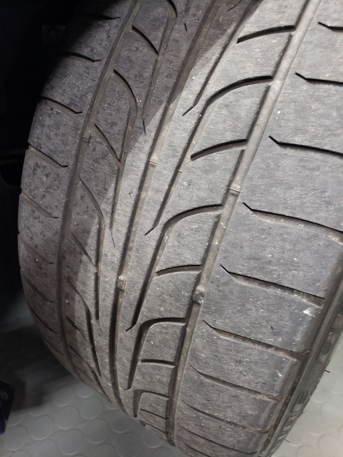

Good point on the tires - The rear tires are 305/30/19 Nitto drag radials , but the front are wide oval firestone firehawk 245/40/18 . I have had them on the car since I bought it (5 years ago) and the previous owner said they had 14k miles on them when I bought (so that makes about 25k miles on them total?). I plan to replace them over the winter while car is on jack stands in my garage - inspection garage that I've been going to for 15+ years said I should replace them by next summer.
I had the sway bar , ends, rack, etc out when I installed the SC and HB and everything "looked" good but wasn't sure on how often things start going bad. I would think that mechanic would say if something was loose/worn during the yearly PA inspection....
as for the shocks.... I was hoping they aren't bad. but when they do finally decide to go, I'm considering doing something aftermarket
appreciate the reply! I will look closer at the front tires when I get home.

The tires look like thry msy be down to 4/32" tread depth. I always fiund that they started to be nousy when they got to thst depth or lower. Also, the age of the rubber is not working in your favor either.
I'm convinced that once you get new rubber all around, you will notice a huge improvement.
Tire Rack is a great site for tire reviews. Rule of thumb is stay away from Goodyear RF's, or any Goodyear tires. Not many on here will give a thumb up for Goodyear.
