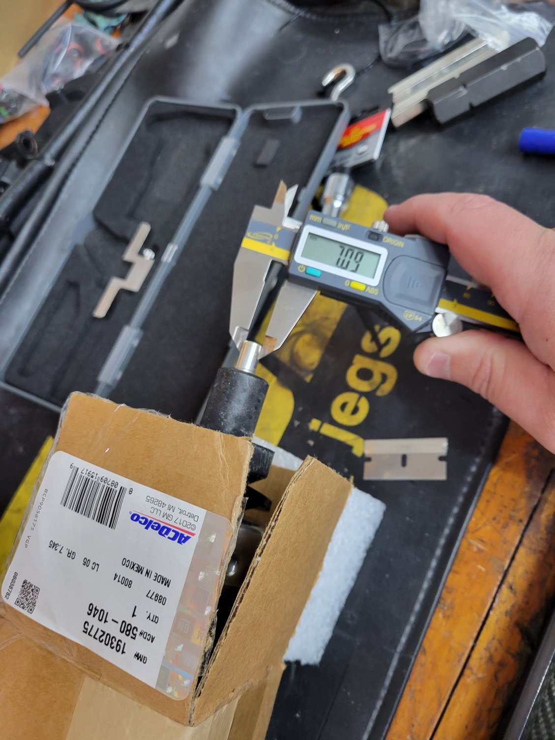

so i need to swap in some new mag ride shocks on my zr1 and i can't find a "double d" socket to fit the end of the shock tower....
i've read that people just use locking pliers to grip the end, but that feels sketchy to me...

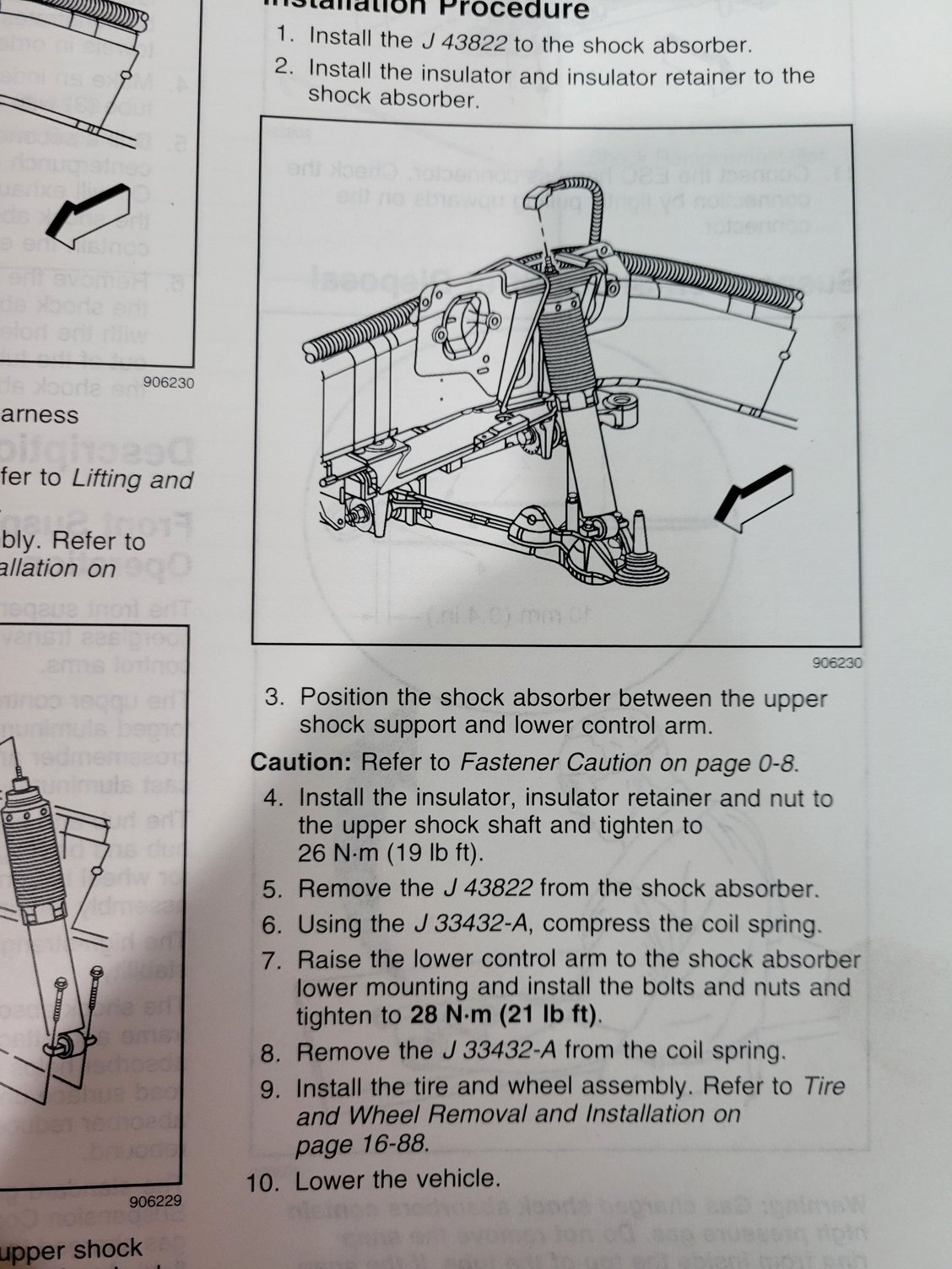

the helm manual doesn't have a kent moore tool number that i found....

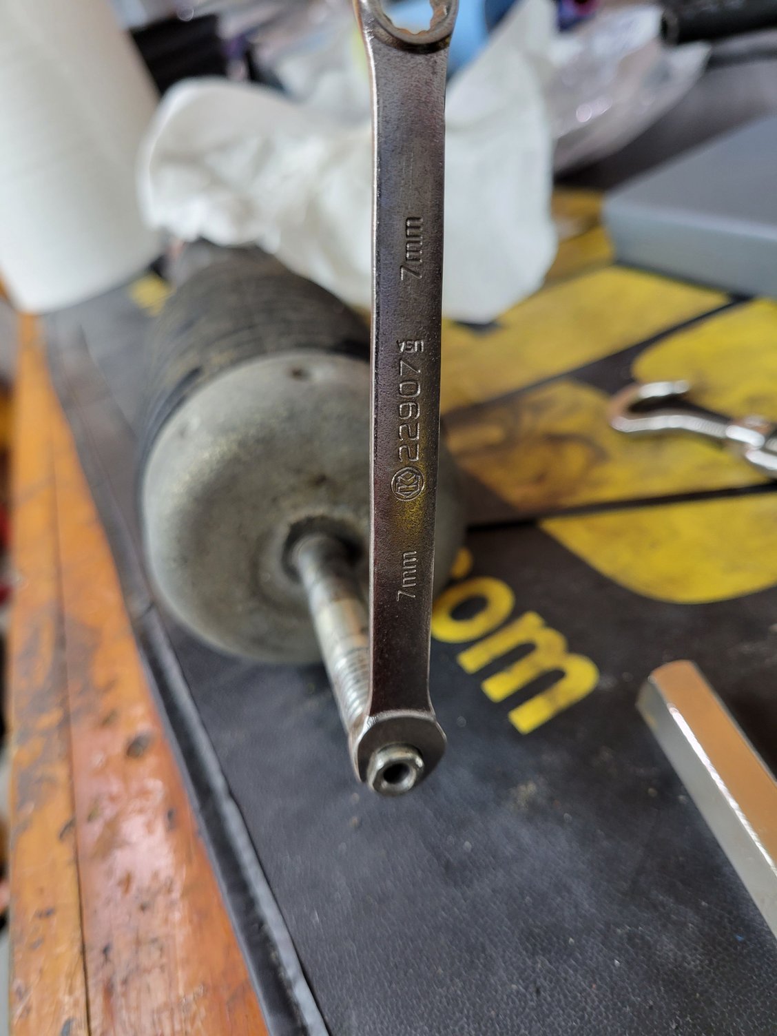

the end appears to be 7mil at the flat....

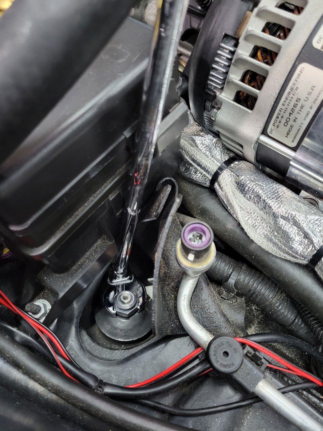

i tried this, but no way to get at it when its mounted....
and i can't really get at the end when i put the nut on....
the helm manual isn't particularly helpful....
i thought i was just crazy but i double checked....
it looks like they just copied the c5 man pages....

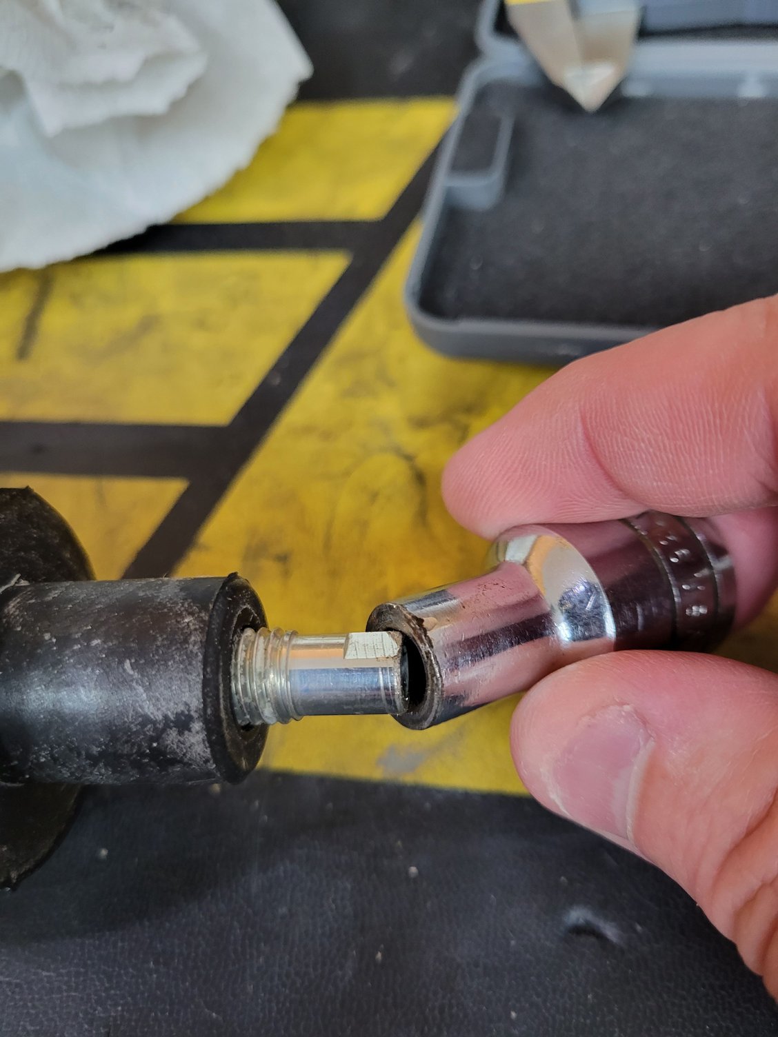

i picked up this one and its too small by a lot...
https://smile.amazon.com/gp/product/...?ie=UTF8&psc=1
the a139 sounds familiar... but its not the 7 mil....
https://shop.snapon.com/product/Shoc...er-Socket/A139
says 6 and 8....

​​​​​​all 3 snap on sockets are the wrong size..... too small....
https://shop.snapon.com/product/Shock-Absorber-Sockets/3-8%22-Drive-Shock-Absorber-Socket/A139
oval width is 6mil
​​​​​https://shop.snapon.com/product/Shoc...er-Socket/A137
1/4 is 6.35mm
https://shop.snapon.com/product/Shoc...er-Socket/A138
15/64 is 5.595mm

considering it only needs 19lbft that shouldn't be hard to achieve....

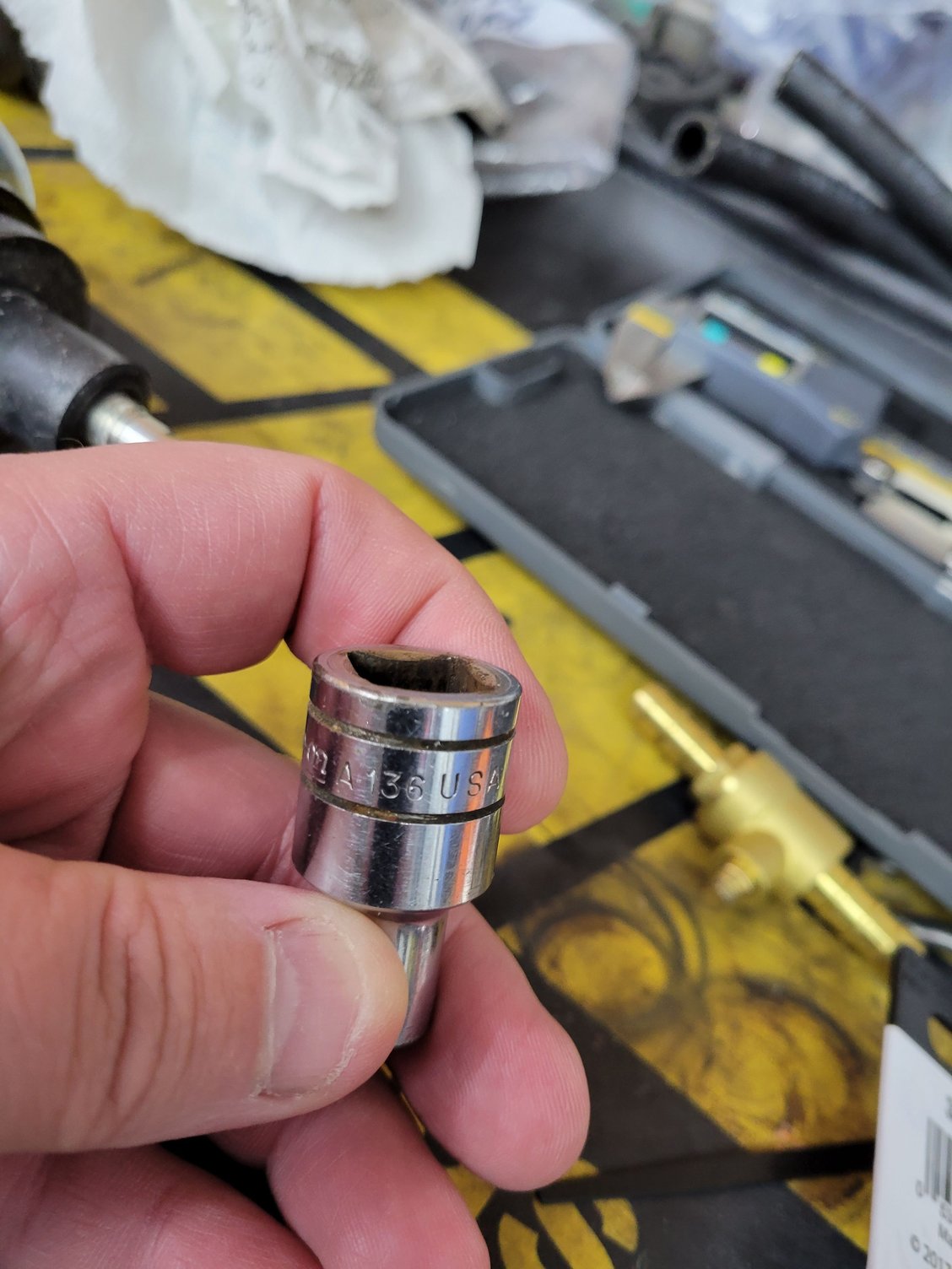

Old Sep 21, 2021 | 02:52 PM
drewz06's Avatar
drewz06
thing knower
Joined: Mar 2017
Posts: 3,404
Likes: 942
From: wpb

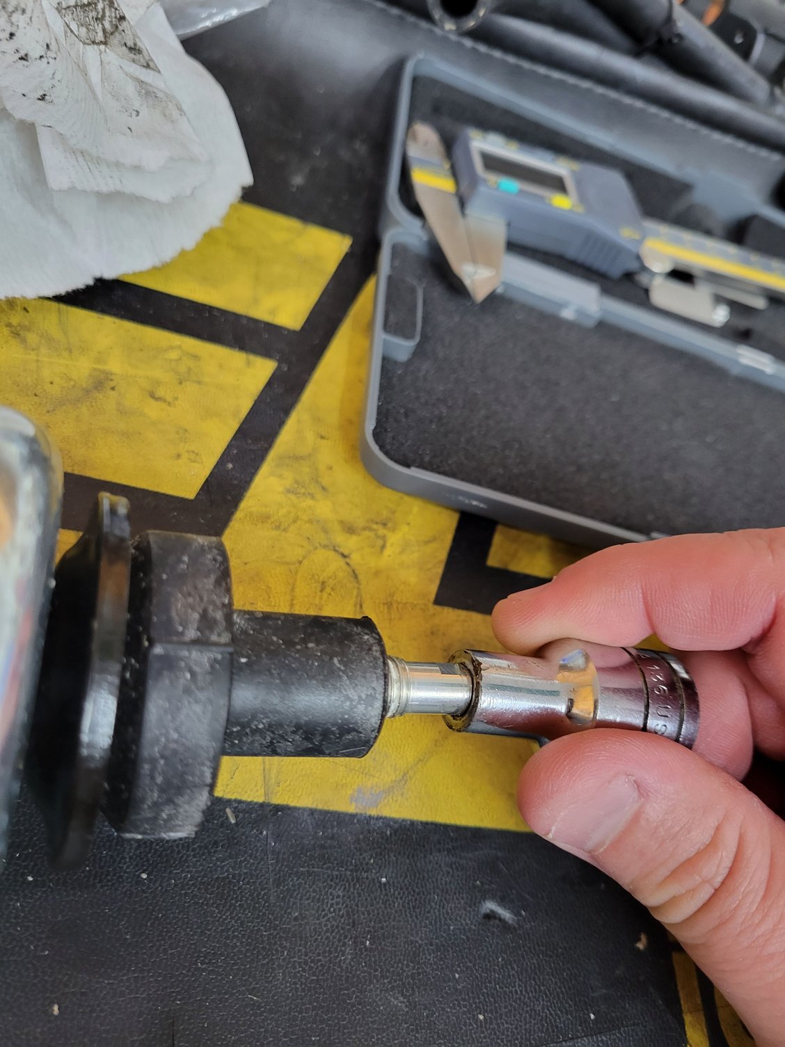

i dont get it...
doesn't fit by tenths of a mil....
