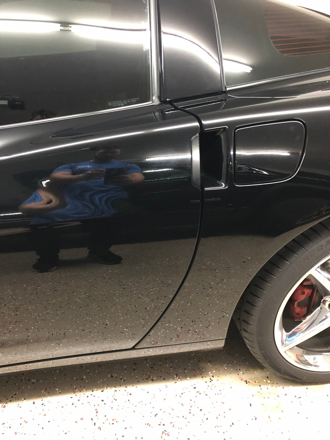

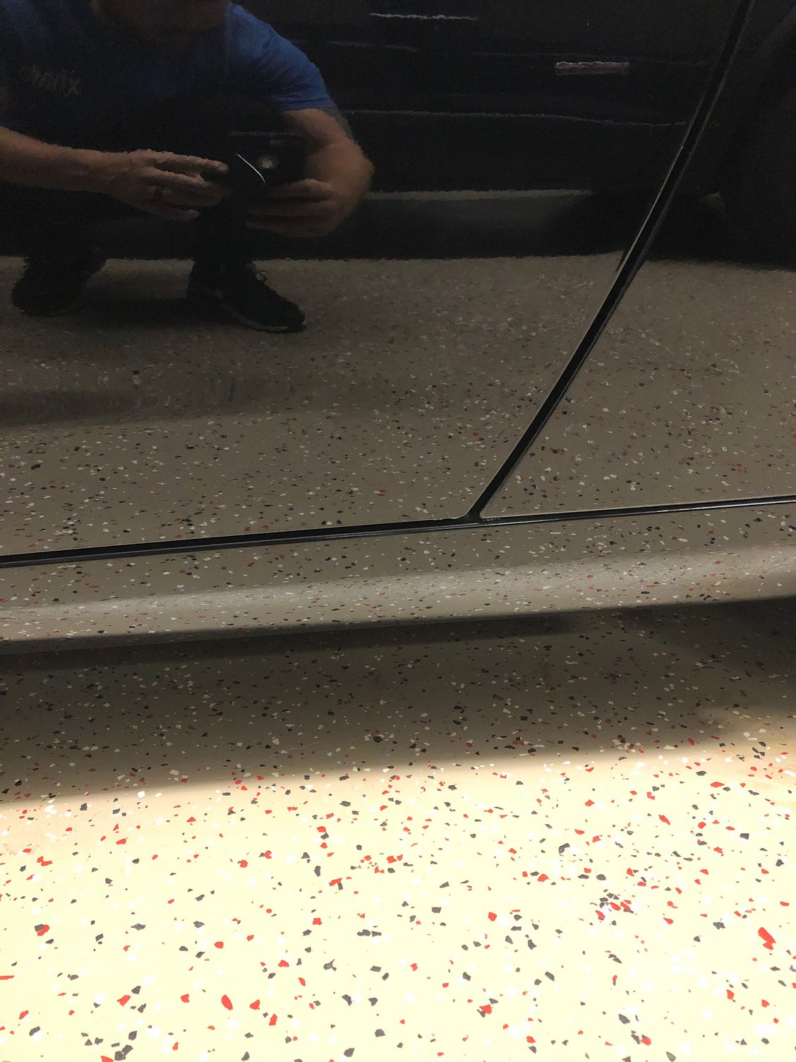

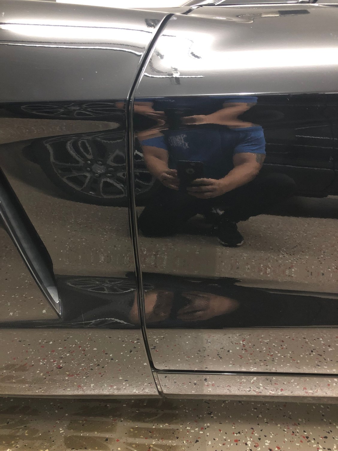

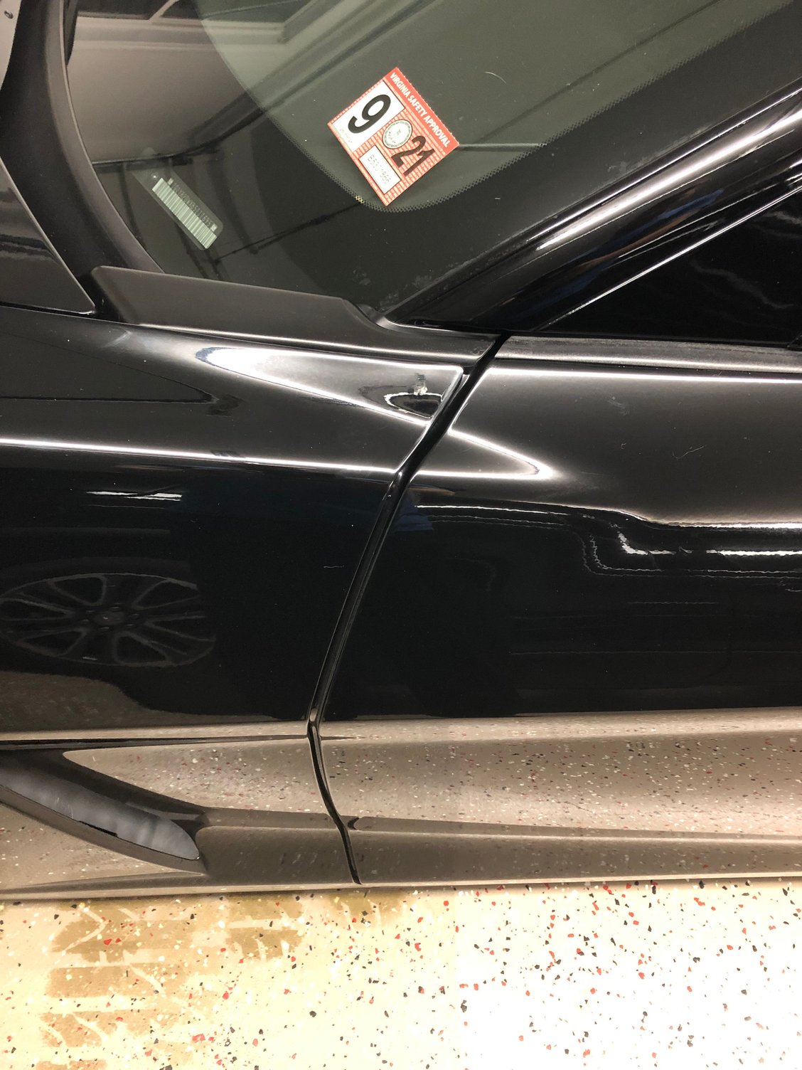

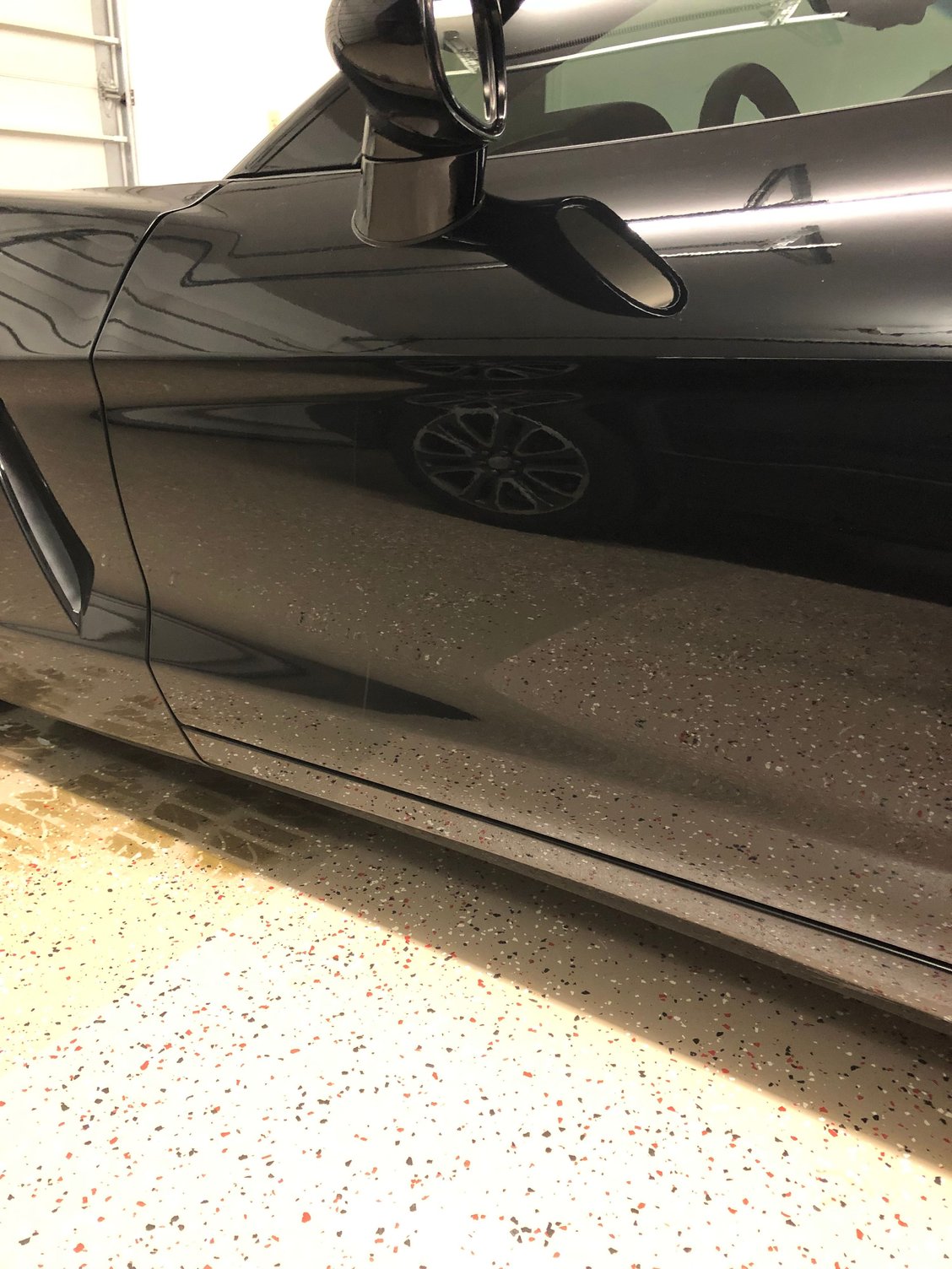

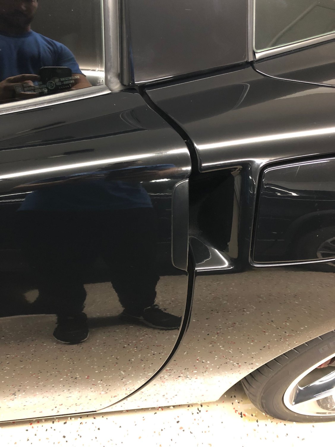

For awhile now my driver side door makes a popping/cracking sound when I open it.. almost sounds like something sticky separating but it isn’t…It’s kind of painful to hear because it’s about 3 or 4 pops that sounds like something is getting ruined. It’s significantly louder when opened for the first time after sitting for awhile. I cannot pinpoint where it’s coming from and I don’t see what it could be because the door alignment seems fine to my eyes. The roller is working fine on the hinge so I don’t think it’s related to that and the spring seems fine too. What I did notice is that the inside of the door is cracking in the crease. I have no idea what could have caused this. Here are some pics of the door to get an idea of the alignment. In the pic with the red circle you can see the cracking. I have tried white lithium grease and wd40 and neither has fixed it. Any ideas what’s going on here? I have to assume the sound and the cracking have to be related, but what could cause that? I’ve thought about loosening the hinge bolts and repositioning the door but I’m afraid I’ll just make it worse.

If the fiberglass is cracked through, as you seem to show in that red circle, then that is probably where your popping sound is coming from. The fiberglass on each side of the crack moves relative to the other side as stress on the door varies during opening. That causes vibration, and thus the sound. I think to do a good job of fixing this, you will need to remove the door and repair the cracked area. Repair it soon because it will only get worse. If you don't want to do it yourself, just take it to a body shop that is experienced in fiberglass repair.

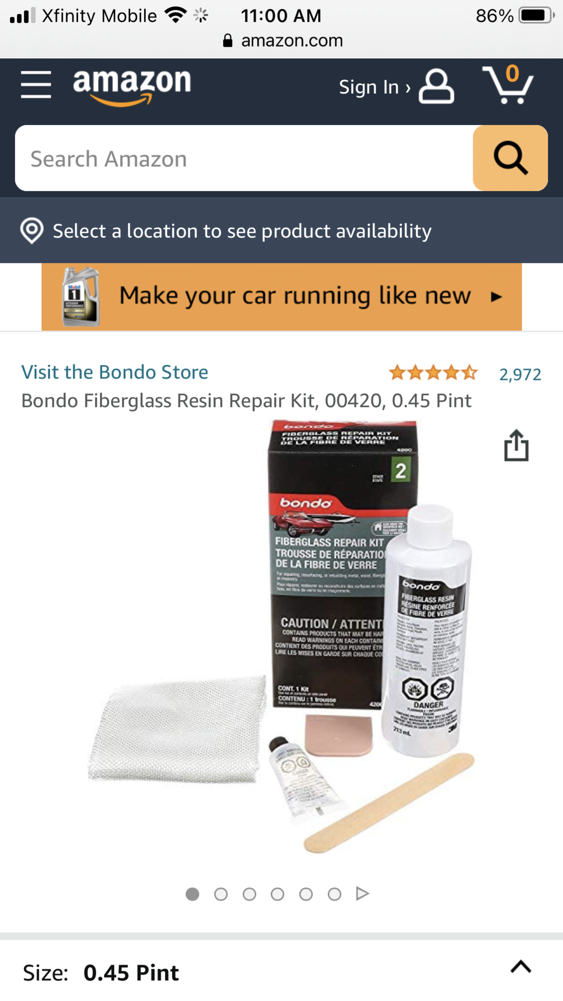

I would imagine that’s where the sound is coming from but I wonder what could have caused that?!
so do you think something like this would be good enough to try on it?
I don't feel qualified to answer that. Obviously, the crack occurred because stress in that area is very high. Therefore, the repair will need to be very strong. It may even involve embedding a strip of thin steel into the bond. I defer to a fiberglass repair specialist.

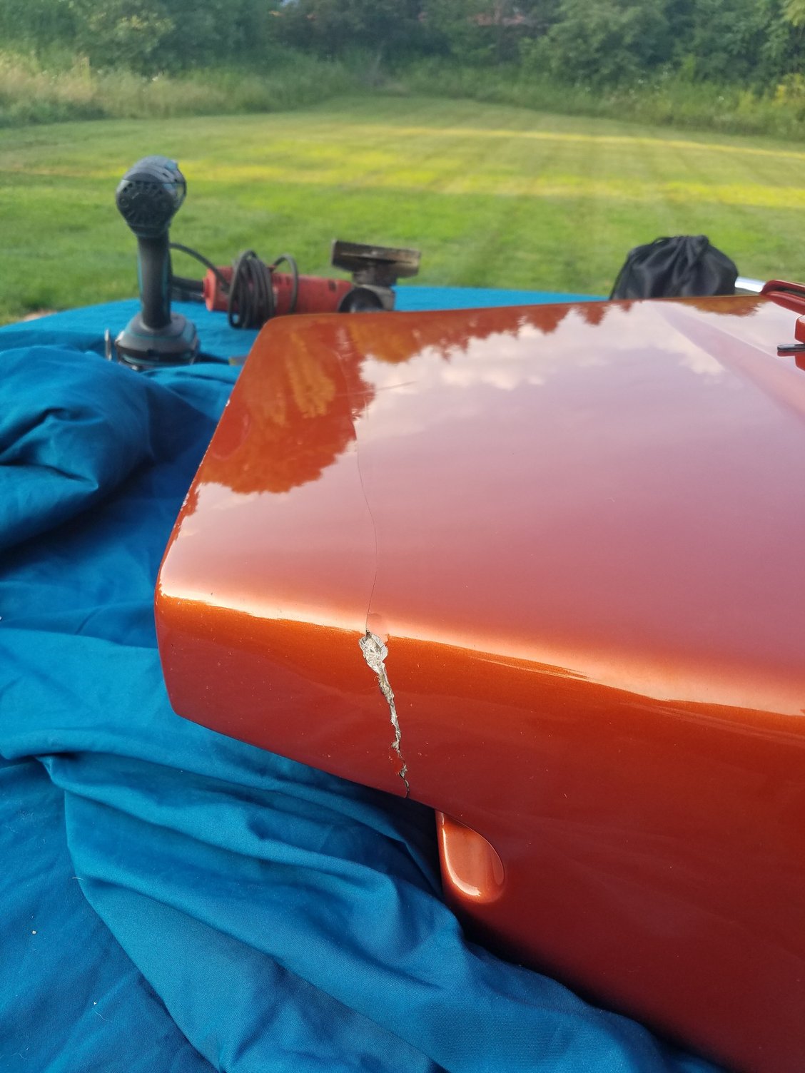

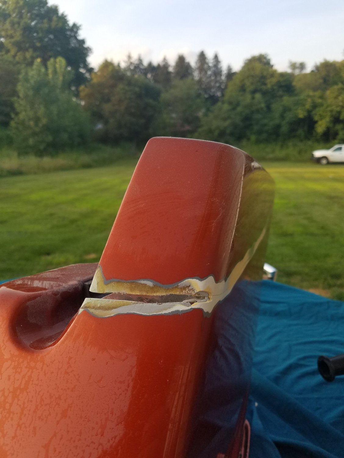

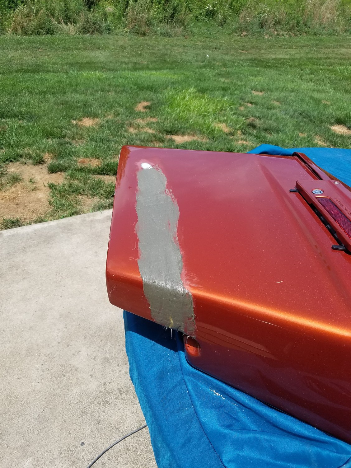

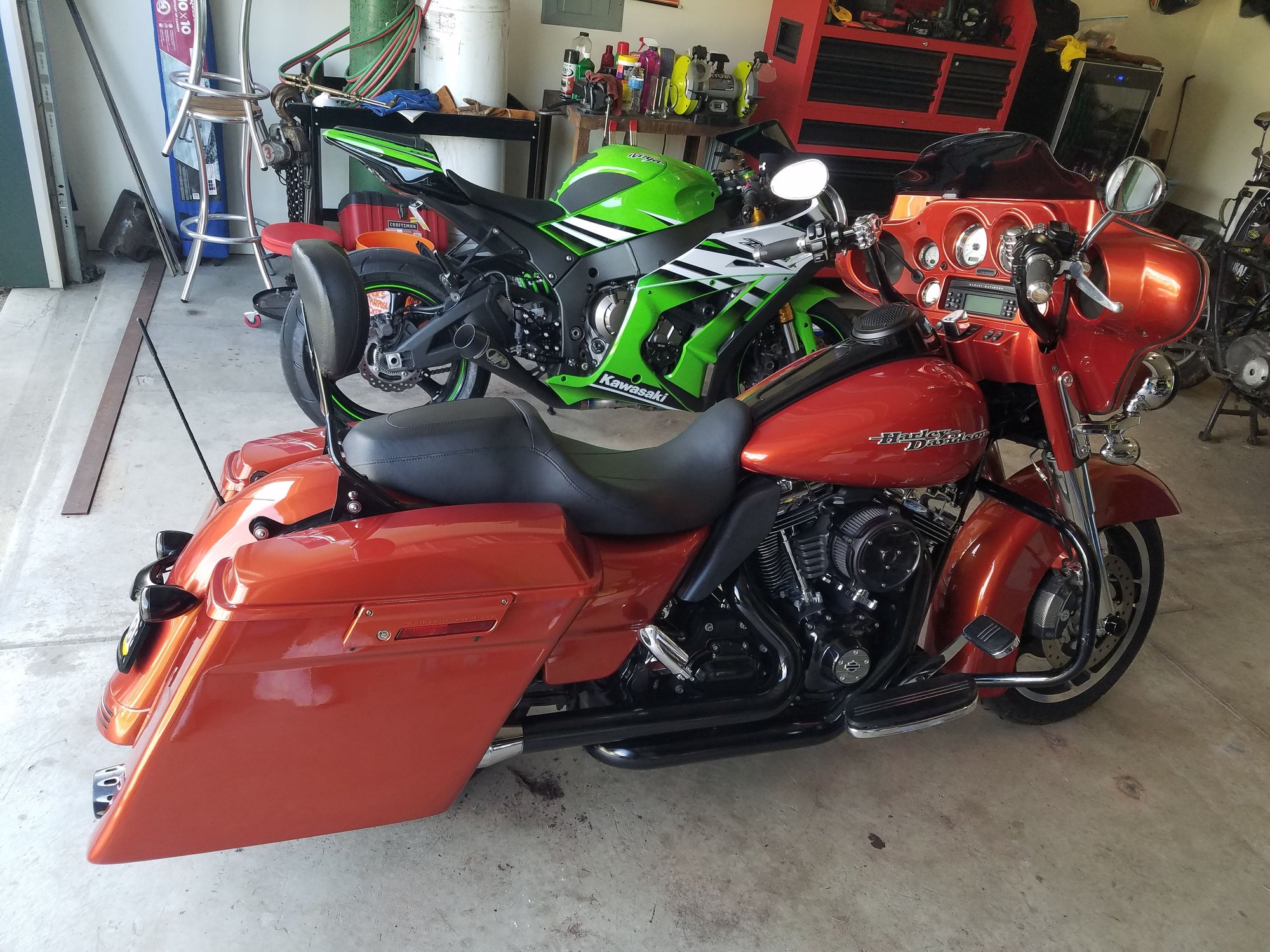

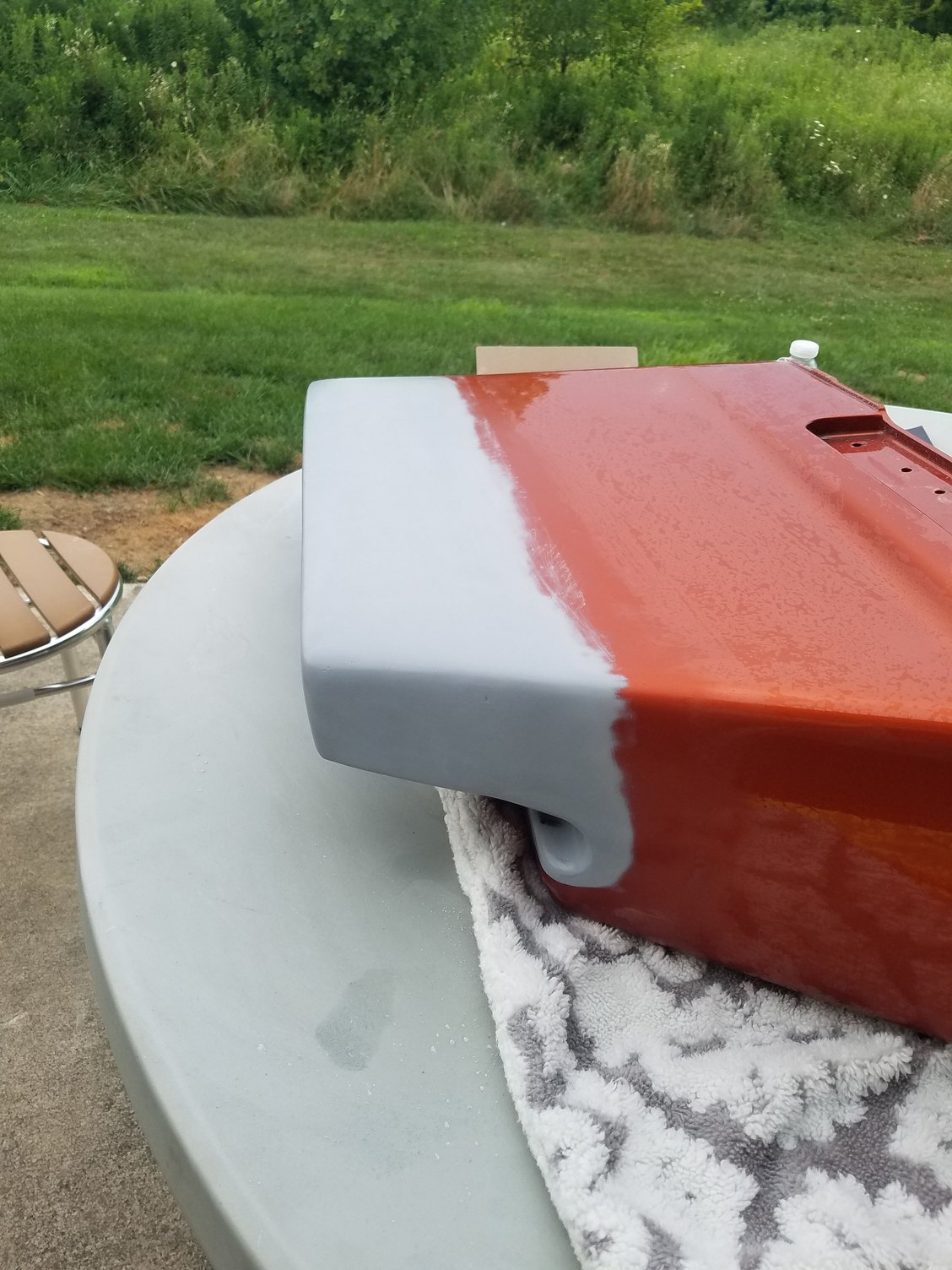

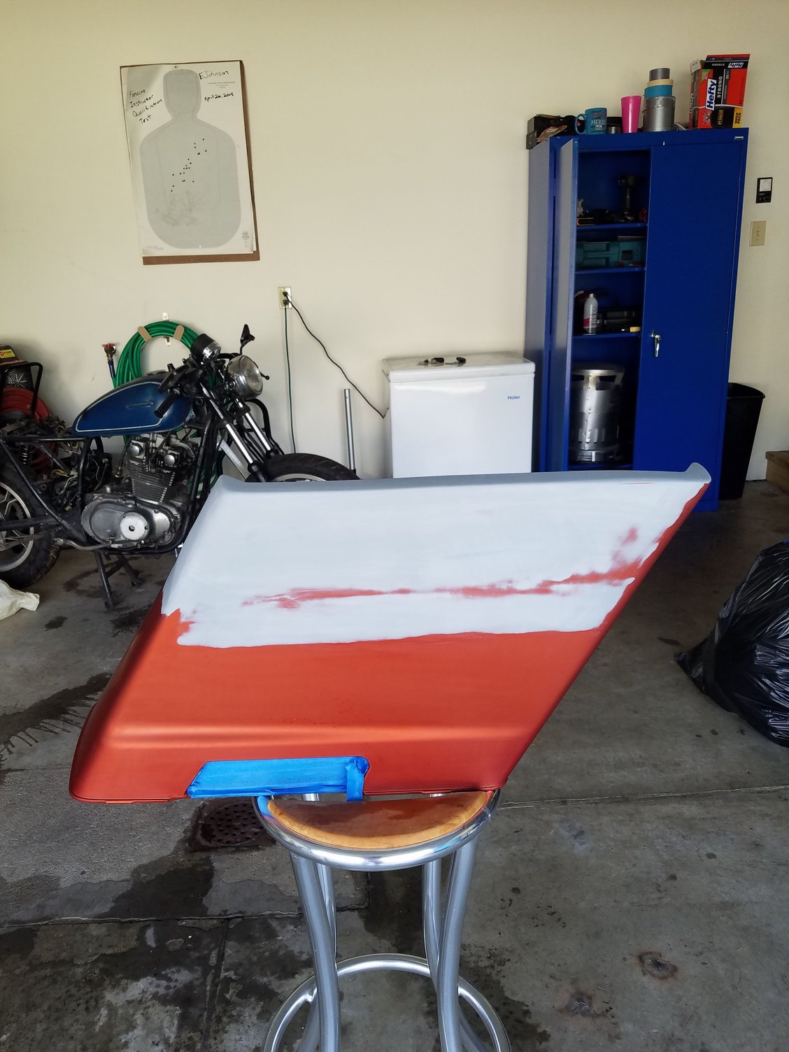

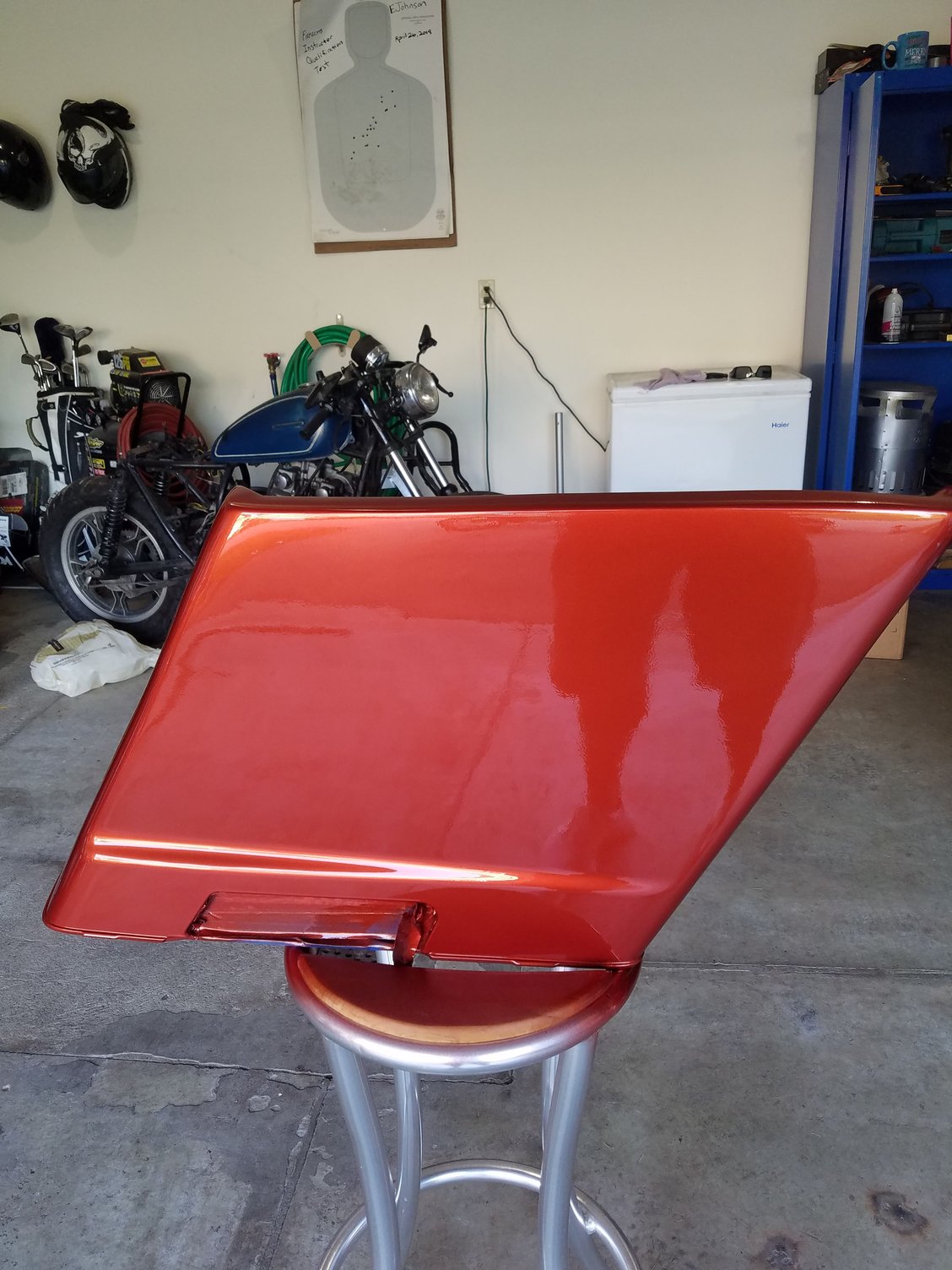

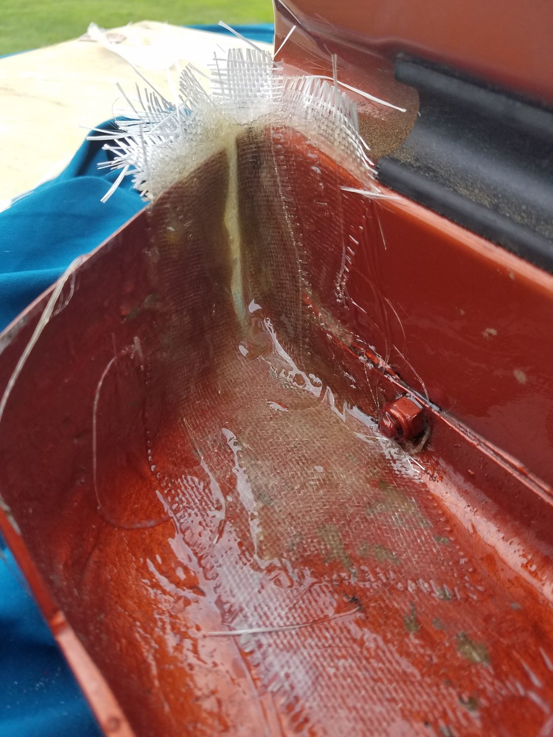

Remove the door and repair the crack as mentioned above, working with fiberglass is easy, just be quick. I repaired my bag extensions a few years ago and they’re still holding strong, this was the first time I worked with fiberglass.
Old Sep 27, 2021 | 09:07 AM
JUICEBOX's Avatar
JUICEBOX
Veteran: Marine Corps
Joined: Jun 2021
Posts: 1,360
Likes: 280
From: Arizona
Finished and on the bike
