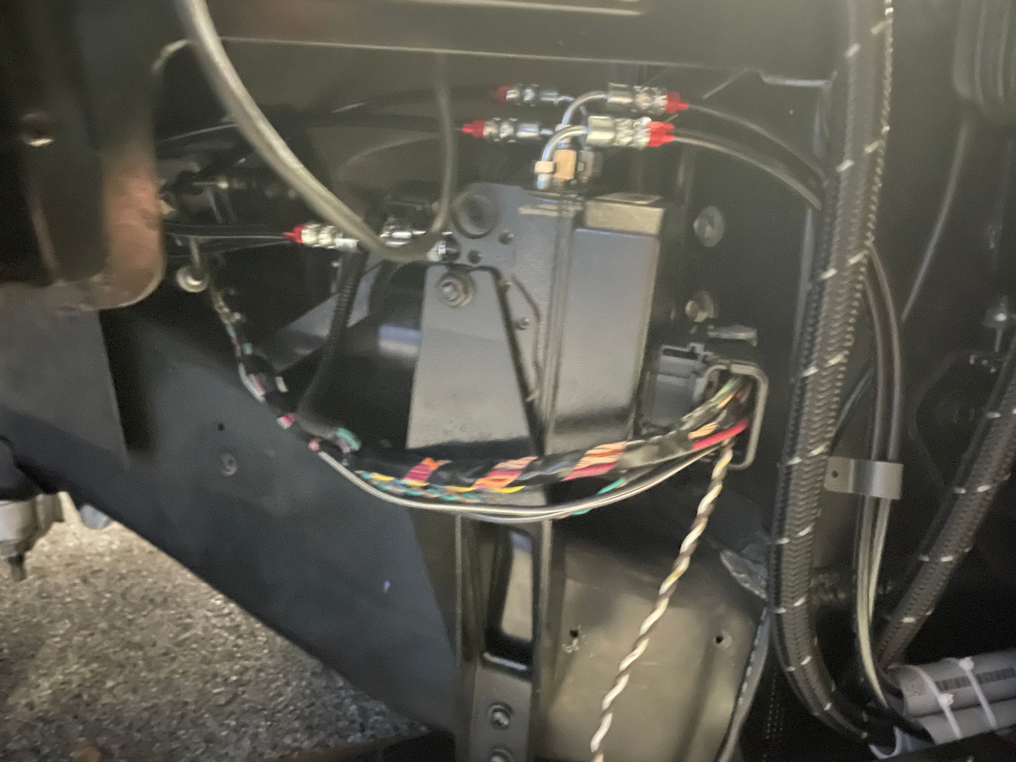

I actually finished this set up. Moved it to the old windshield washer area. The harness reached and only had to extend 1 or 2 lines back into the engine bay. Had Finishing Lines make me the new custom lines.

I like it. The stock setup jammed the ABS module right against the power steering pump, and the EBCM against the frame rail (through model year '08) which made it difficult to service any of the above.
Install a thicker DeWitt's radiator and it only got worse, with coolant hoses pressed against the tangle of brake hard lines.

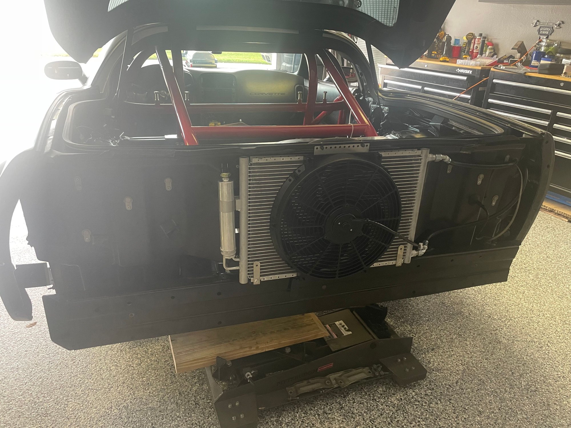

exactly. My new build is all based on function and ease of working on the car. I am also doing a custom tilt radiator so my access to all front engine accessories will be easy and will help direct radiator heat out if the engine space quicker. All my wiring will be hidden and even my fuel lines will not be in the engine bay (less chance if fires for any potential leak).

It was easier than i estimated. Once you strip back all the protective coverings, you can separate most of the wires. And it reaches without extension. The yellow/brown wire hanging needs to be extended back to your steering components.

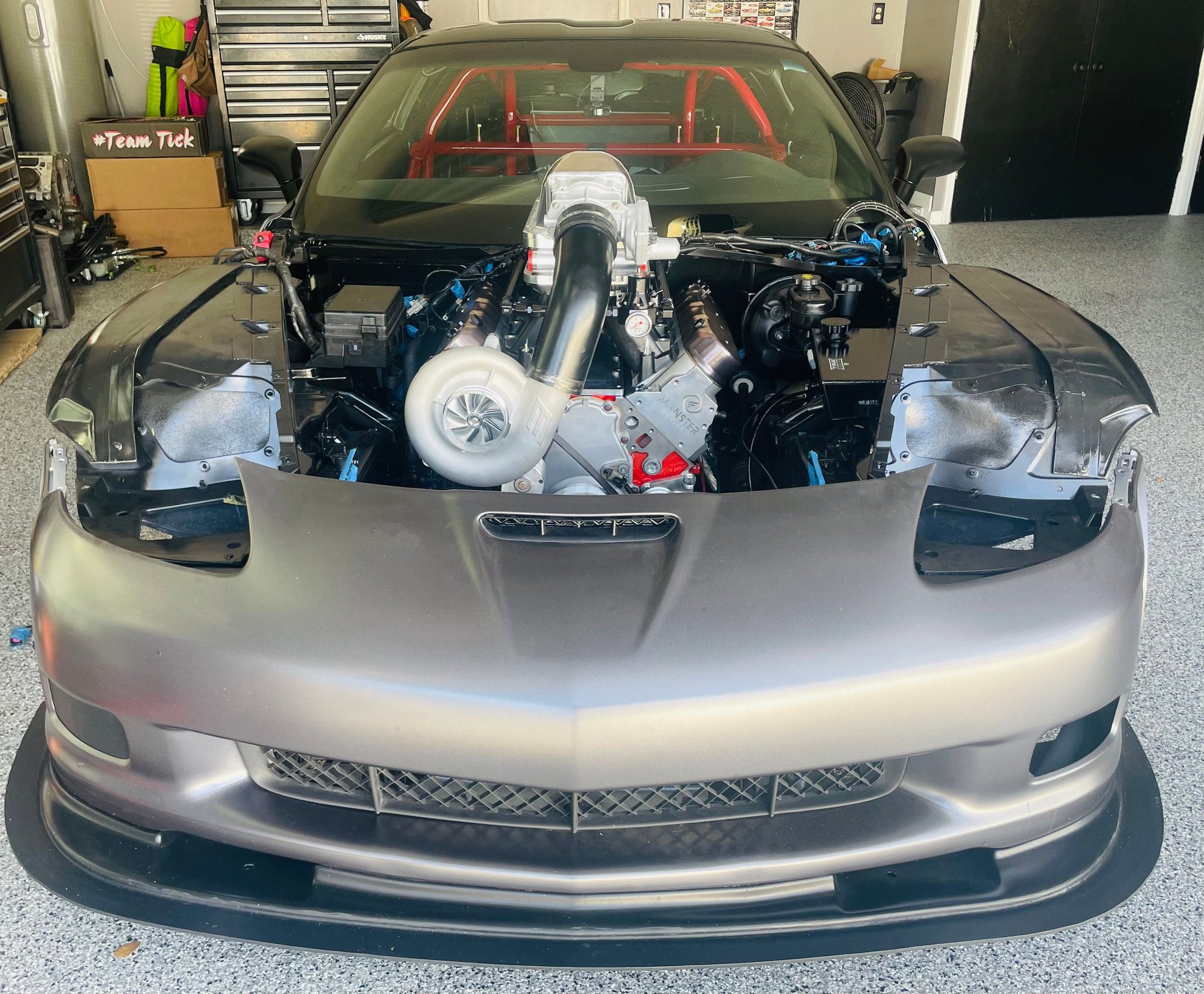

Frankenstein_C6 sneak peak of the build in progress .

I think it was around $700. That was from brake booster to ABS and back to all tires. Also included new lines to the calipers. All
custom made, custom color choices. I also added a quick disconnect in the rear driver wheel tub for easier disconnects when dropping the cradle.
They have my design saved so you wouldn't need to re-measure and design a new set up

I’ve also been wanting to do a lay down radiator- saw a Mallet Performance corvette at the museum years ago. I contacted Chuck at Mallet and he said it was a one off so would have to fabricate our own

Yup, G-Speed makes a nice kit but pricey. I drew up a design and sent it to Dewitts to be built. All AN fittings and will have custom mounting points that allows me to remove the factory radiator support. I was shocked that they were able to build this for me for near the same price as their stock style set ups.
