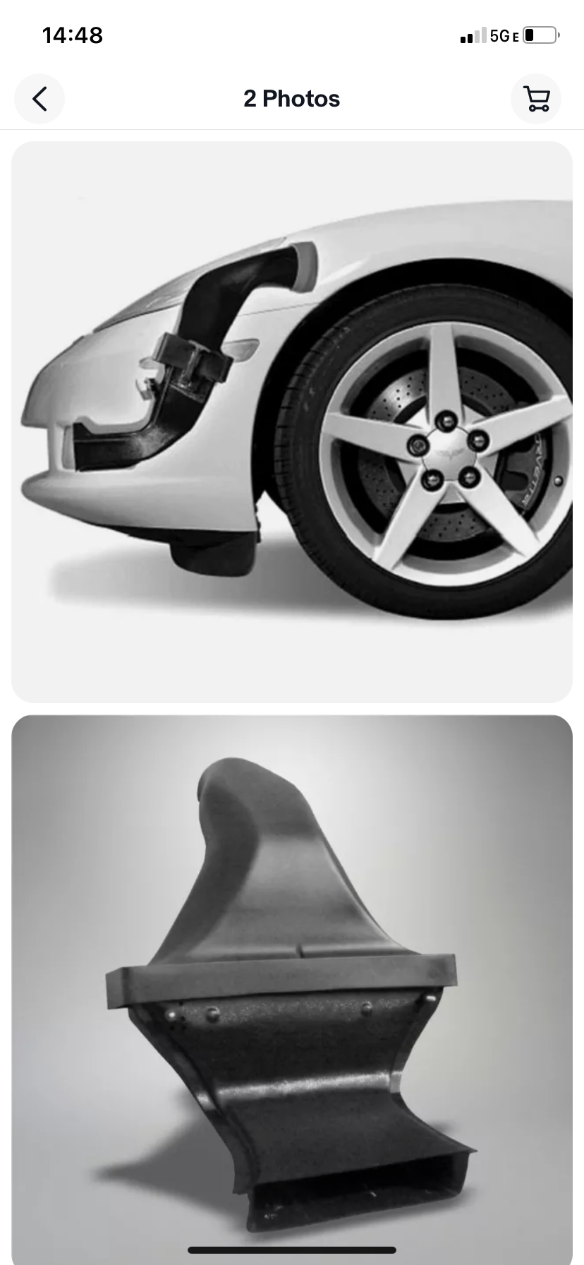

This crusty old CAI was in the car when I bought it. None of the parts have a part number or label. It is completely nameless. Does anybody recognize it? This is from a 2005 z51.

Does the bottom
part go down through the lower plastic like Vararam?

Originally Posted by labhound
Does the bottom
Yes, the bottom part curves under the nose and goes right to the screen. It definitely looks just like the one you're showing.

Could be that one…. What are ya gonna do with it?

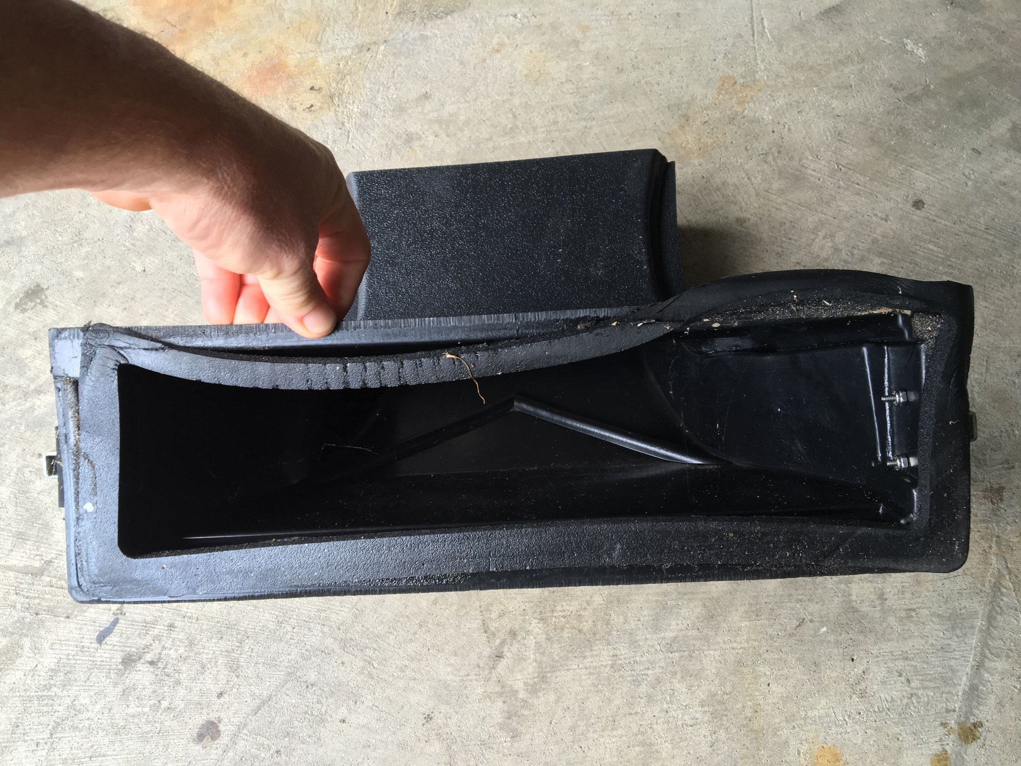

I had the original Vararam on my 2006 coupe, and the fit around the filter was suspect at best. I did the suggestions above with window air conditioner foam, and that sealed it to my satisfaction. My son owns a speed shop, and is a parts supplier, so he gifted me with a new version of the Vararam. The fit and quality of the new model is superior to the older model with an improved coupler that replaces the accordion for the intake.
I had no issues with the older one, and did sell it to a C6 owner, and he loves it.
I have many spare decals for the Vararam unit if you want one for yours.
send me a PM, and I'll send you one for free.
A pic of the old unit.

Check the sealing material where the two halves of the CAI meet. Mine was not centered. On your picture above, yours sems to be missing, so that could be your issue.
Also check to make sure it is tighly sealed at the mass air flow section. My original was bent so I added some sealant to assure there was no air flow imbalance. I removed the original gasket where the two sections meet, and replaced it with sponge tape. It is available 1/4" thick and various widths at Home Depot.
https://www.homedepot.com/p/M-D-Buil...6577/100665794
The original CAI was not perfect, to be sure. Works great though after the fixes.
my gasket looked like this before I replaced it.
The condition of your gasket is pretty much on par with the one I had and threw out. It was all mangled, which I believe turned out to be most of the ugly noise. You don't see the gasket in the pic because I tossed it out. You can tell in the pic that it appears there were attempts to reseal it in the years before. I took my rotary tool and cleaned up the surface of the lower unit's gasket surface. I then recreated the gasket with 3/8" foam adhesive, and then treated the other side of the foam with a mild soapy solution similar to what is used to seal the bead on a tire, hoping to give the filter and that foam some stick. I let it sit for a bit and took it for a drive.
