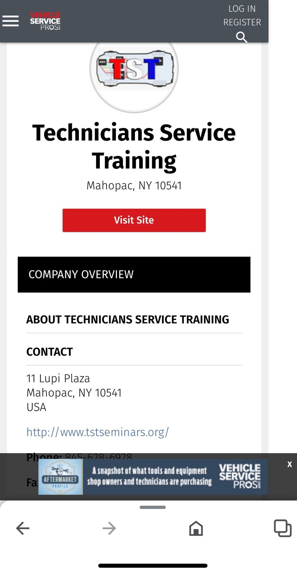

A blinking CEL is a misfire that can damage your catalytic converters !!…so don’t let this go on for too long…it doesn’t have to be a Corvette specific shop to diagnose this…call TST Training located in Mahopac and see who they can refer you to…they may be able to look at it for you !!…they have a great automotive training channel on YouTube and I have attended many of their seminars over the years before moving to Florida from NJ.…their number is:
(845) 628-6928
