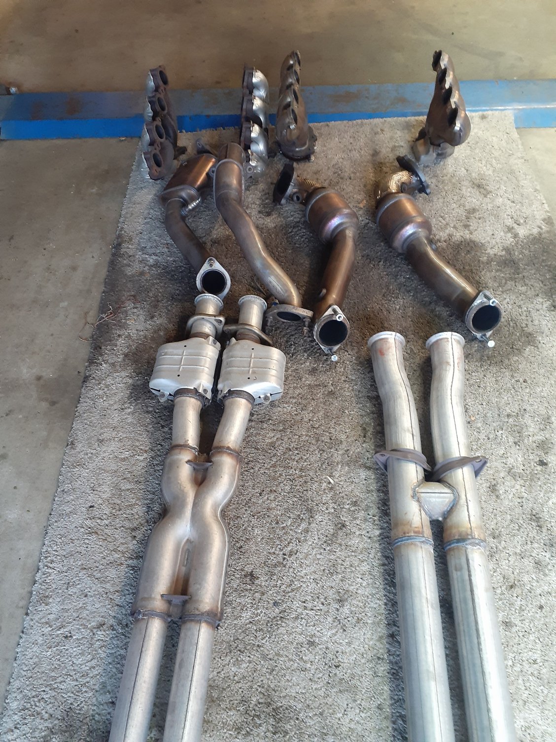

Z06 on the left, LS3 on the right.
You will also have to swap over the cats, but if you can find a set from a Z06 they only have one cat per side, while your GS has two.

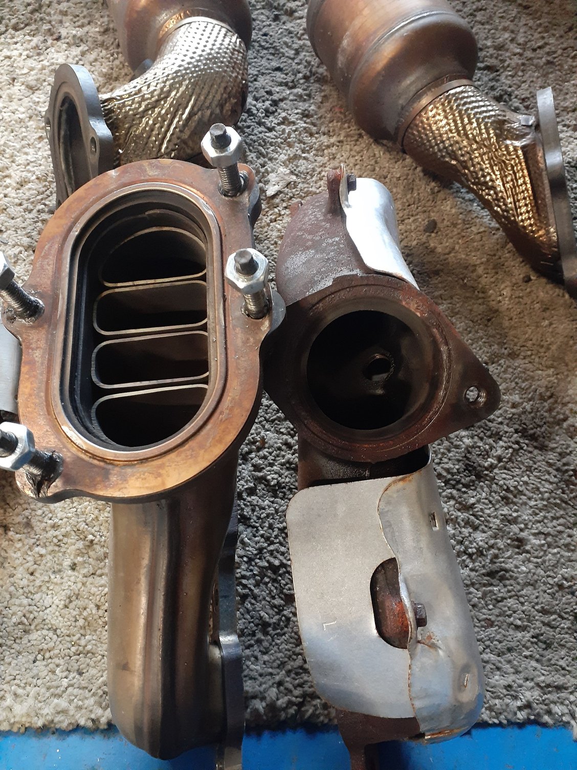

Here are some side by side pics for comparison.
GS on the left, Z on the right.
Ditto.
Z on the left, GS on the right.
