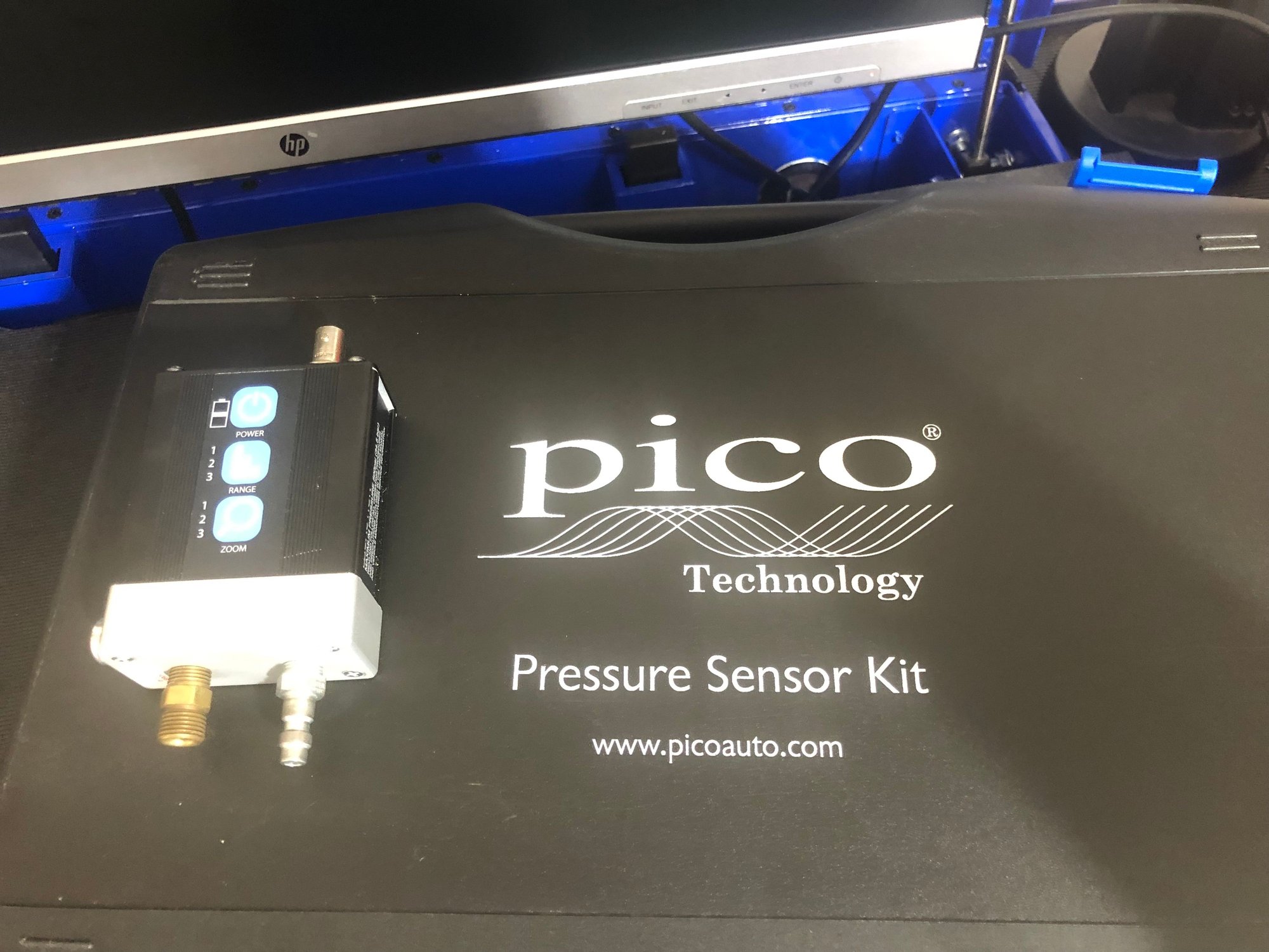

Find a shop that can do an advanced "in cylinder pressure analysis"...you can easily detect a wiped cam lobe with this test without removing the heads....just hook up to a vacuum source in the intake and at the exhaust !!...if you want to drive to Florida I'd be happy to do it....10-15 minute diag.

NO my friend this is not something you can do with HP Tuners !!…this test requires a very expensive piece of diagnostic equipment with a scope and very few shops can do it and a lot
have never heard of it !!

The equipment is expensive and the most you'll pay in diagnostic time should be 1 hour...it is a quick test !!
