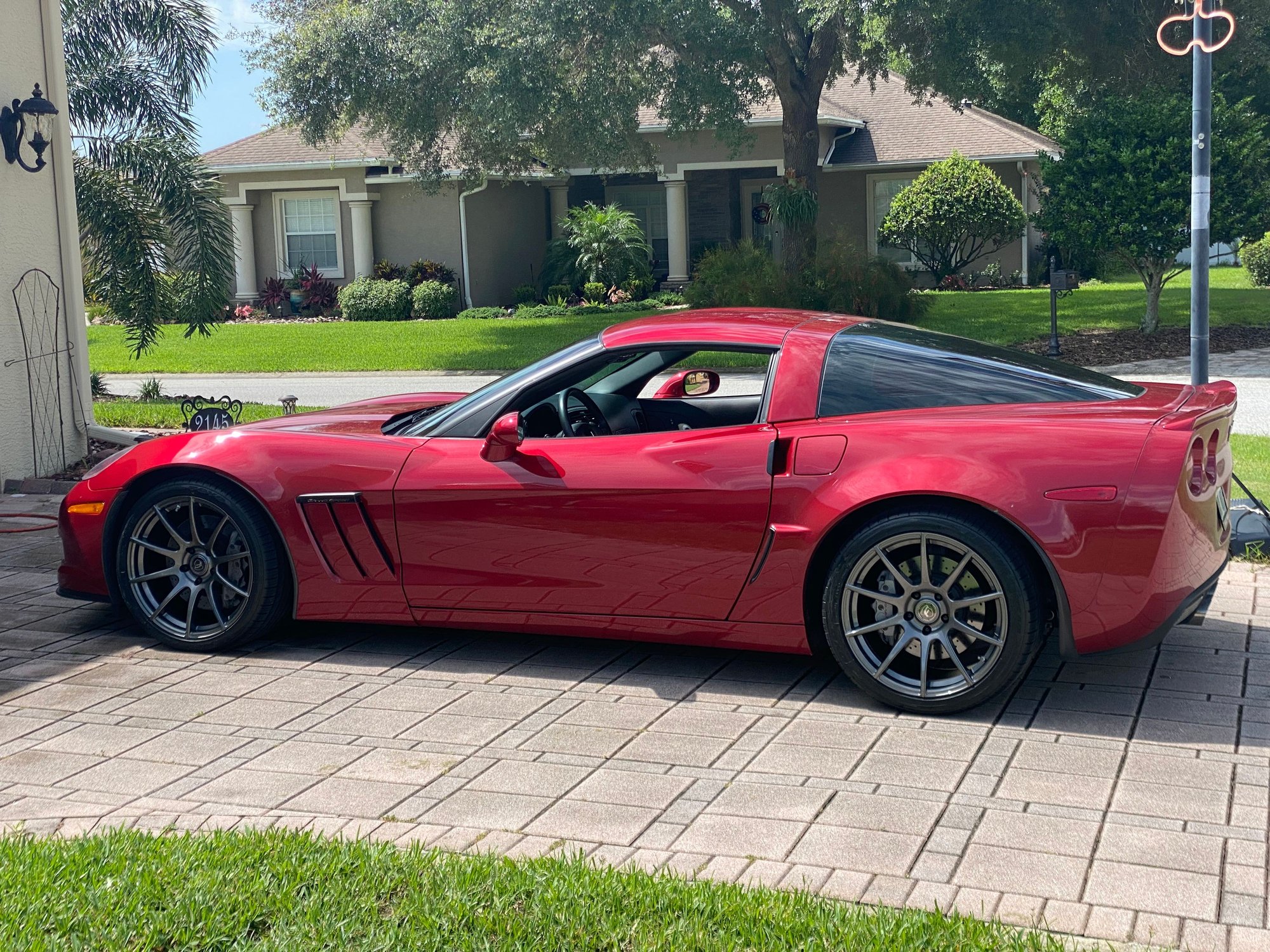

Does anyone know what kind of price to expect to install lowering bolts, c6 gs ,., I’m new, don’t hate, pic for attention 😎
