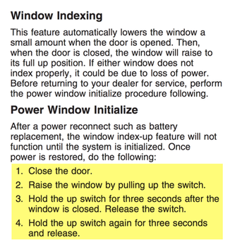

You do not mention the age or condition of your car's battery. A failing battery is usually the cause for many of the C6 electrical related problems. If your battery is not healthy, replace it. If it is healthy, you should disconnect it, Check the condition of both the wire connectors and the battery terminals to ensure they are clean. Reconnect the battery & ensure that the wire connectors are secure, tight and not loose. Reinitialze both of your windows and hopefully a good reboot of your electronic modules will solve your problem.
