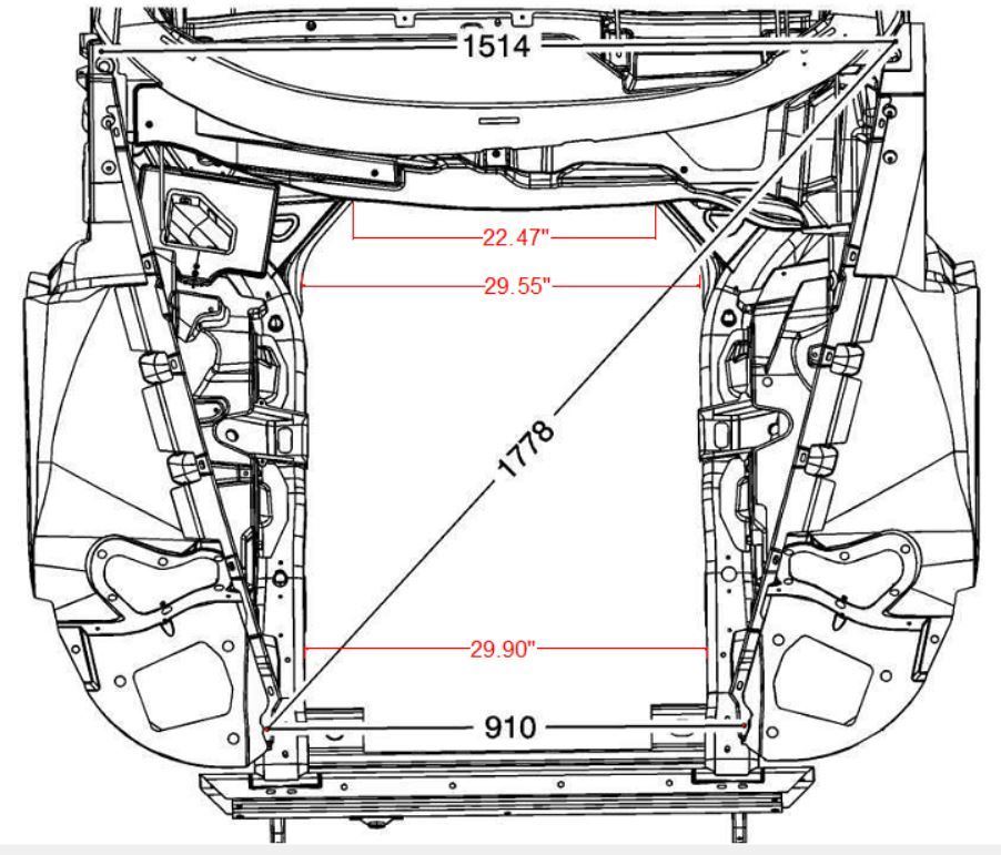

I have a engine with turbos under the headers in my c5 but had to bash the frame to get them in 3076 garrets now wanting to move drivetrain over to a c6 z and wanted to know if the frames were wider near the bell housing on the c6’s can’t seem to find drawings anywherz

I believe they are the same...they sure look the same
. you should be able to scale off of this

c5 frame, drawing a little more convoluted

Here is the scale for ya...
