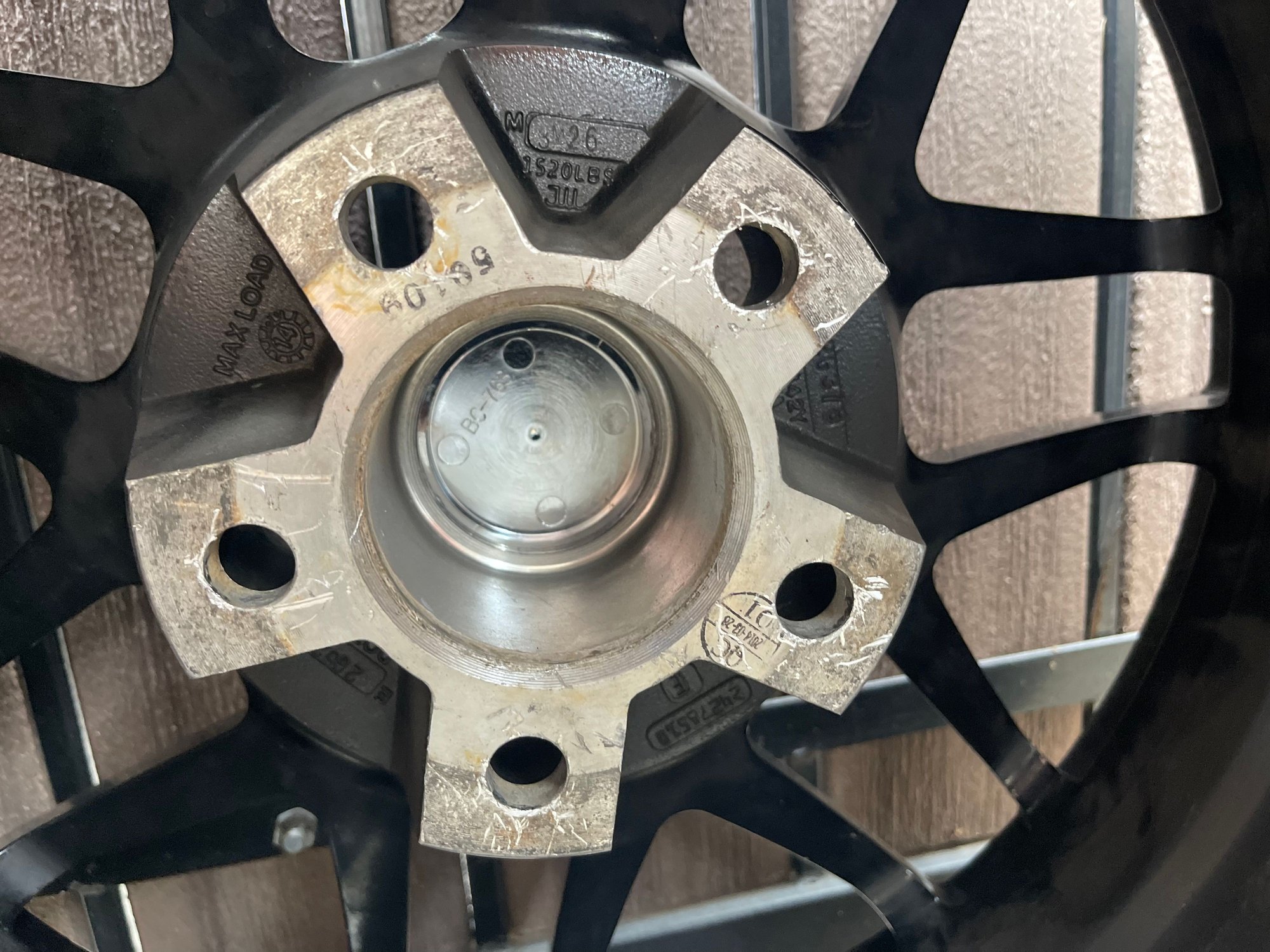

Picked up some forgestar F14’s
apprently they came off a Z06 however when I attempted to place n my base C6 the lugs were to wide and did not fit. Any idea how to find out the bolt pattern?

You need to use narrow / splined lug nuts in the M12 x 1.50 thread size.

BTW ... The Z06 uses a wheel with a different offset than what the base model C6 uses ... I think you will find that if Z06 sized wheels are installed on a base model, the wheels will be sticking outside the wheel wells (bad idea).

the bolt pattern will be the same its the offset thats different those wheels you bought will stick out on a base unless you have the widebody conversion or plan on doing other wise sell them and get the F14s with a 65mm offset
