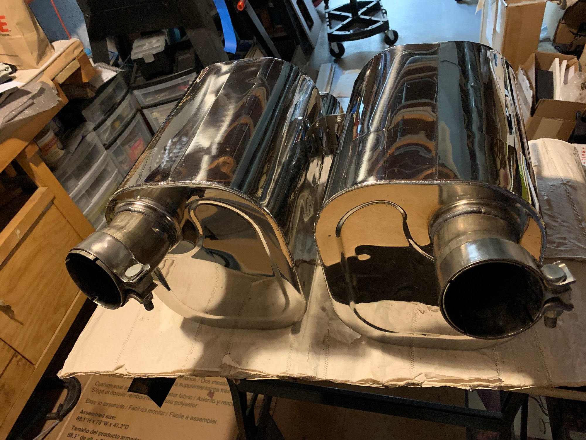

Hooker Blackheart Rear View

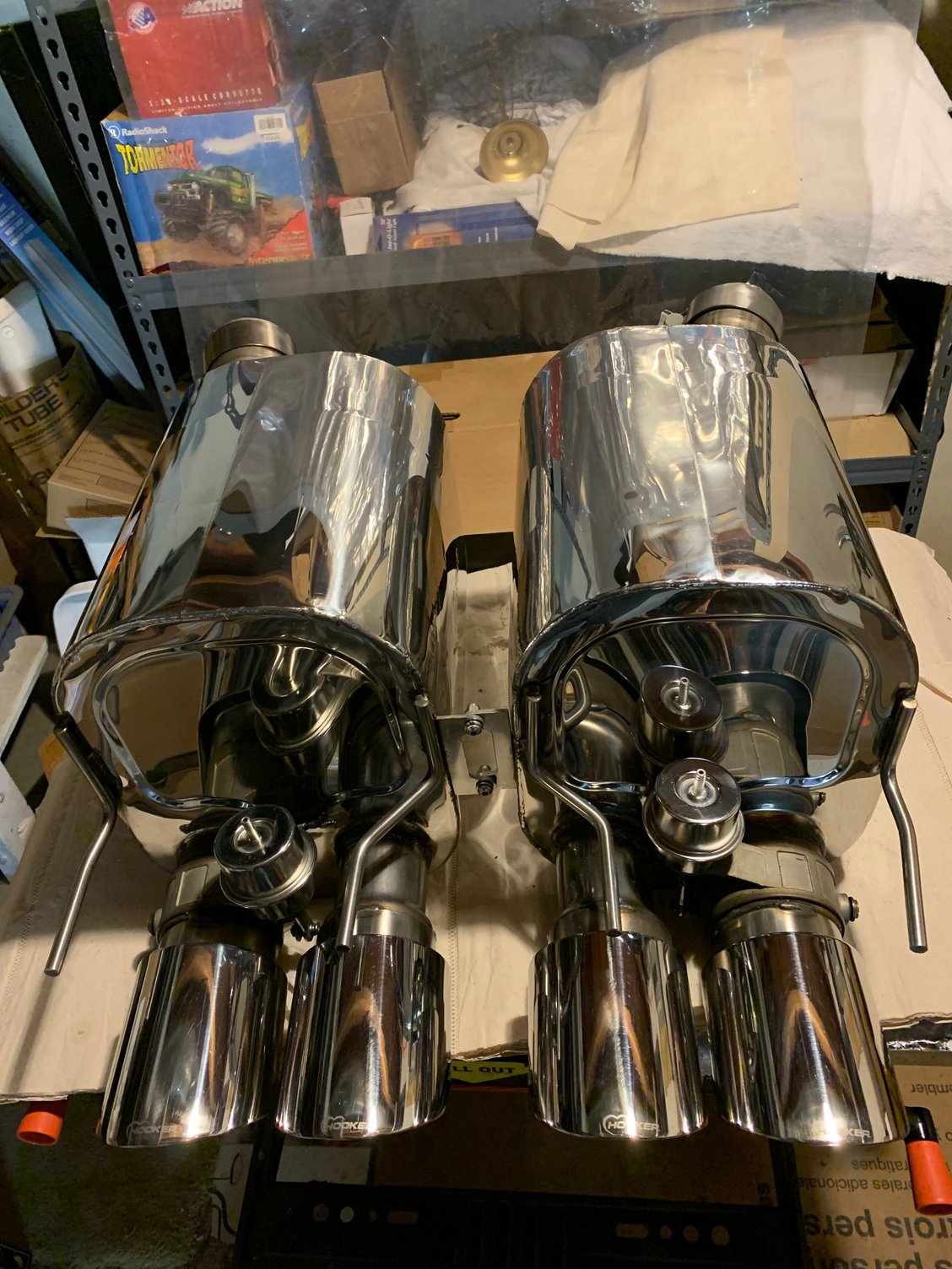

Front View

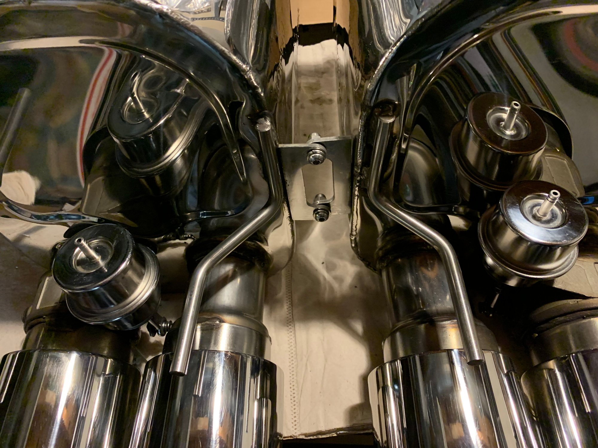

Close up of Vac. Controls
