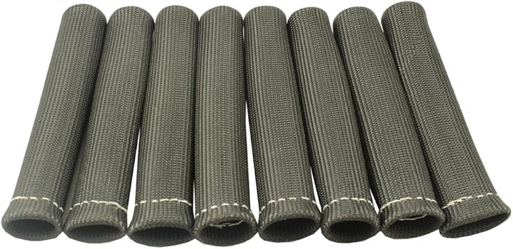

Not at all, but I would certainly get a set of those spark pug wire heat shields.
Tip ... Put on a set of rubber gloves when installing or you will be itching for the rest of the day from the fiberglass.
