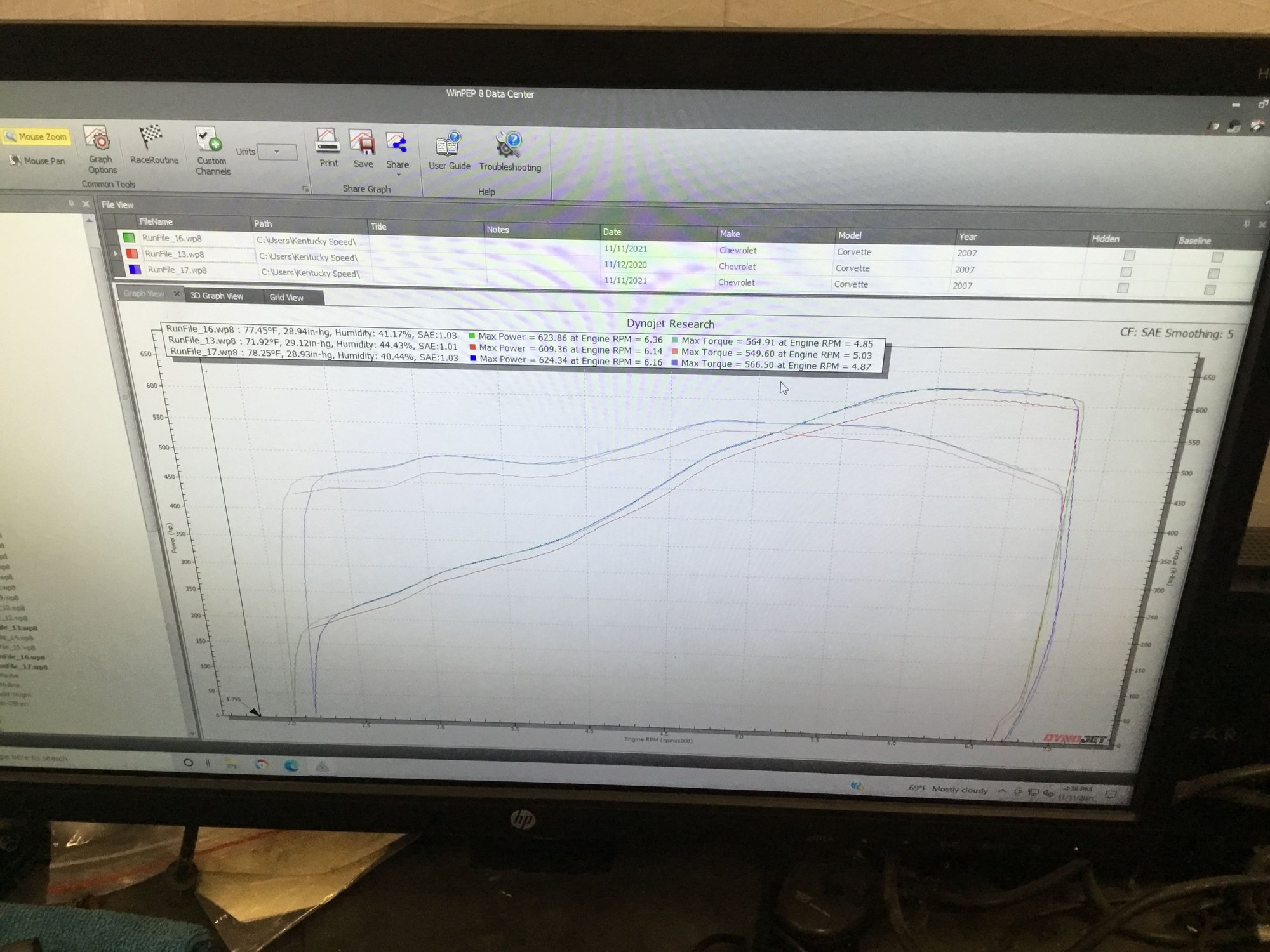

I want to thank my son for posting the video for me .were @624 rwhp /566tq I’m hoping when I have my intake ported and go to e85 I will meet my goal 650rwhp/NA

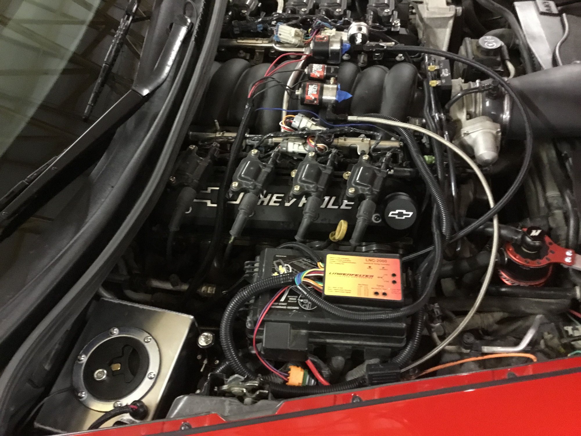

Sounds awesome. Are you running nitros or those brackets for something else…..
Thats some nice numbers.
Nitrous
I’m setup for 150 shot of nitrous

this is 2.0 rebuild after having lifter trouble and losing my Mike Jones cam .
its a 450 cid RHS block all block work done by PA Automotive n Greenville Tenn (machine work)
4.166 bore 4.125 K1 crank Lunati pro I beams
Wiseco pistons recoated by line2line (compression 11.97.1) heads 64cc (on 93 octane)
cam motion lls solid roller 255/269 114.5+5 702/683
Morels 6177 solid lifter
Trick Flow 260 ls7 heads ported by Greg Good to 286 cc intake runner 2.250 intake valves /heads drilled out for 7/16 shaft bolts
Crower shaft system
stock MSD intake/103 throttle body NW /ARH 17/8 headers
I’m running a 3.90 gear .anyway here the dyno sheet.shooting for 650 as soon as I install a electric water pump/ported intake/ and E85 I will get there.but then again I have my rings filed for 300 shot of nitrous
