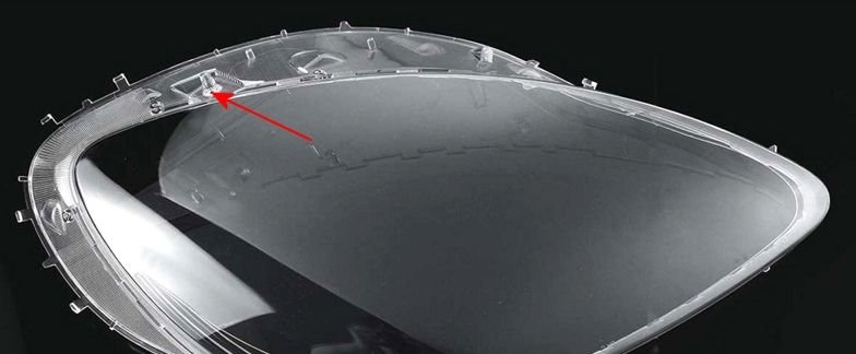

The headlight is supposed to have a built in protrusion that fits in the hole of that bracket. At least my 2 headlights did when I replaced the lenses. Has the lenses been replaced? Maybe the new lenses didn't have that protrusion as per the top left of the
picture. I'm not sure if the new replacement lenses have these, or if it makes any difference. I have the old style lenses, and my fenders sit flush in that area.
Ok, thanks, good to know about the protrusion, so that makes it clear that it has nothing to do with the fender being tight or not In that area. So now, still need to figure out what can be done to fix the fender being loose or bowed in that area
