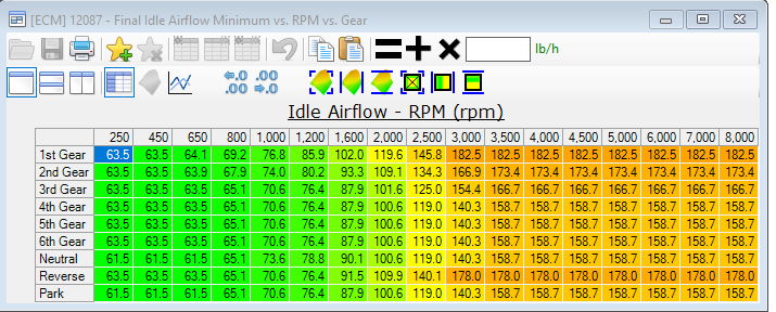

He's talking about the table below. The tuner should have adjusted this table for idle and driveability.

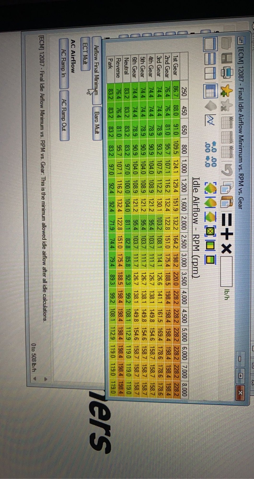

So I decided to just go ahead and order an hp tuners device and went to check the table y’all were talking about. But my problem is when it comes to tuning I’m in wayyyy over my head lol. I attached a picture of my table. If anybody any idea about this being too high that would be great. Any information is more than I have.

Also try the HP tuners forum. There you can download a stock tune or tune for a car similar to your mods and use the HP Tuner “compare” menu option to see areas that are different. If all else fails just begin by removing 20%(Multiply by .80) from the cells that you are having a problem with.. Reflash and give it a try. Back up your current tune in case you need to restore. This is how you begin to learn how to tune. If it is still over revving try another 15%. It’s a pretty safe table to experiment with and if it doesn’t solve your problem you can return it to the way it was and read up on some of the other tables such as timing decel, idle decel, or DFCO. The compare function vs. stock tune will highlight what tables have been changed.

Thanks man! Over the past week I’ve been learning tons about tuning. And I’m just now starting to figure out what everything does (there’s way more to it than I thought). I seemed to have fixed 90% of the issues. Still working on fine tuning though. I’m pretty sure the previous owner only used the car on the drag strip so I’m just working on tuning more for daily driving.
