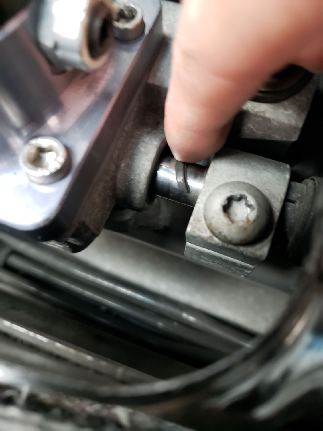

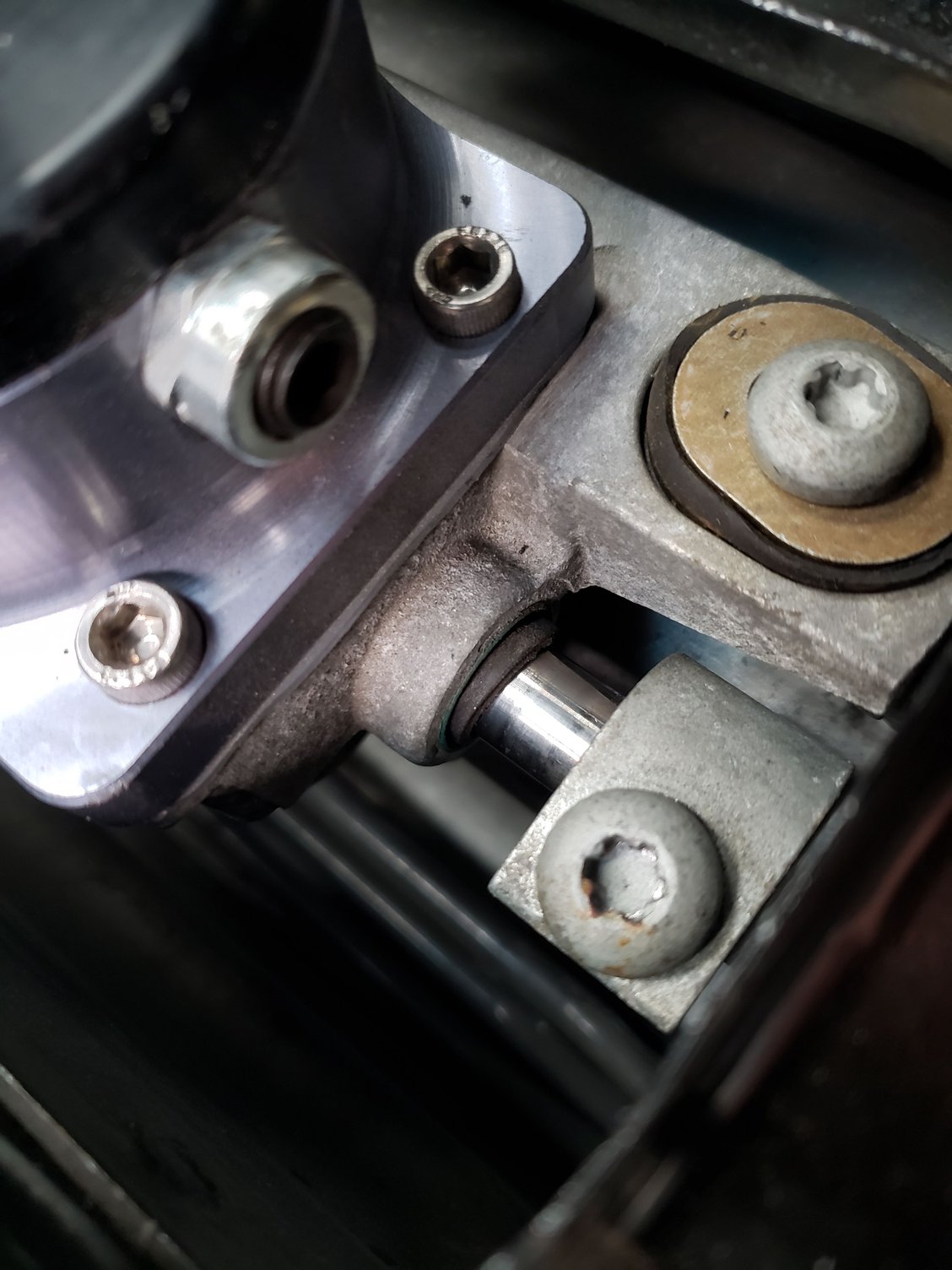

Hi Everyone,
I just took my dash apart to switch out the springs in my Hurst shifter and noticed there is this tiny bushing torn apart where it looks like the linkage goes into the lower box (pics below). I tried to doing some searching but only found the big ring bushings for where the box attached to the car itself. Does anyone know what part this is, if its simple to replace myself, or if it's even worth replacing at all. There is a little movement around where that bushing is but not a lot. I think it might have been this way since I got the car. Thanks in advance!

Since I see an after market shifter bolted to the top of the box, get the Get MGW on the phone for a lower box.
Yes, the stock box bushings can be pressed out and replace with delrin bushing to repair it, but if you don't have a lathe and press to make/install the new bushing, then just pick up a MGW lower box that does have replaceable bushing isntead. As for the OEM lower box, will just run into the same problem shortly again.

Thanks! I do currently have the Hurst Bullet Plus shifter. While I think I could probably swap out the bushing myself, I liked your idea of replacing the whole lower box. I actually just ordered an entire new MGW shifter, so when that shows up I will have everything top to bottom swapped out. Figured I'd give the MGW a try since everyone loves them so much.
