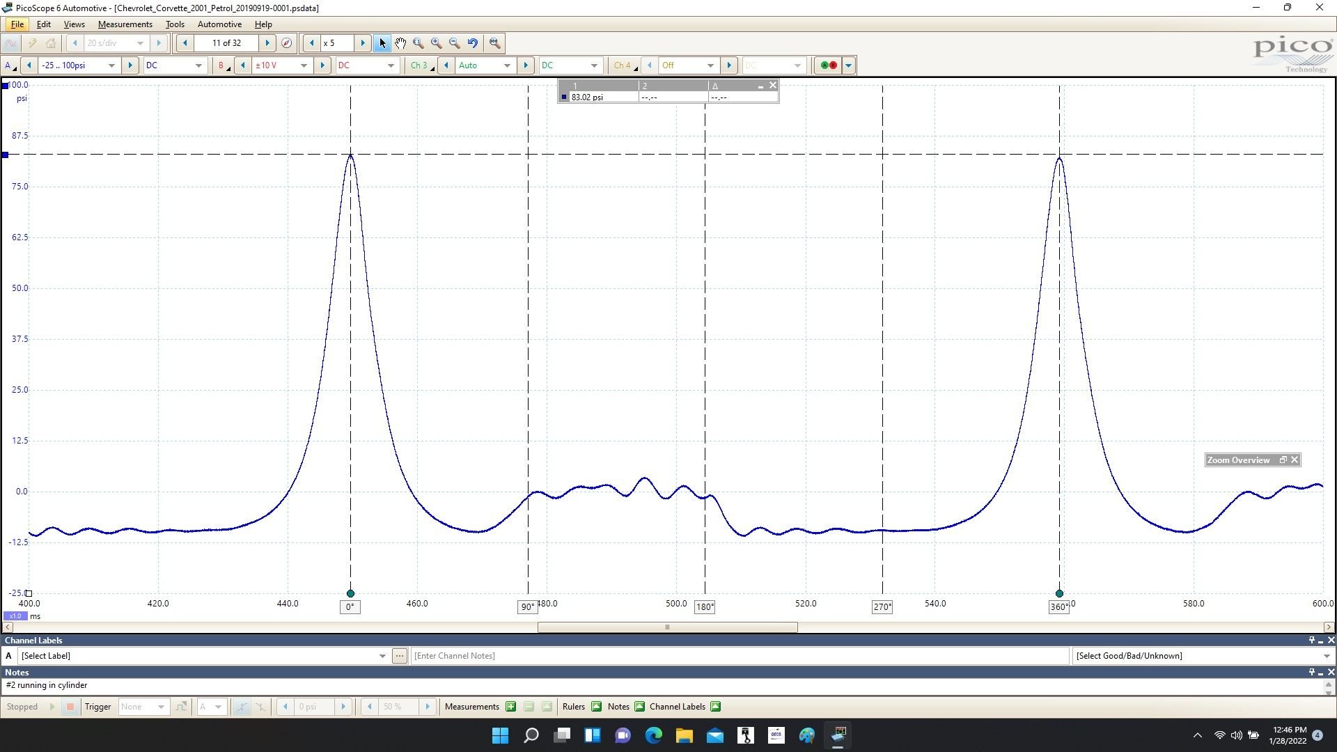

What do your long and short term fuel trims look like at idle ??...remove the #1 fuel injector connector and with a 12 volt test light connected to battery positive probe the injector connector terminal that isn't the pink wire...that is the injector control wire...when the engine is running the test light should be blinking when probing that wire...sometimes "swaptronics" isn't the best way diagnose a misfire...with the fouled plug maybe an ignition issue...there are some mechanical issues that would not be picked up with a compression or cylinder leak down test...worn cam lobe for instance...what does the injector resistance look like with a ohm meter ??...with an injector misfire your long terms will be quite high...somewhere around 15% or so...sometimes you really need a lab scope or perform an incylinder pressure testing to quickly and accurately diagnose this...maybe find a diagnostic shop in your area...they will find your issue within 30 minutes !..an incylinder pressure waveform below on my 01..I can see ANY mechanical issue with the engine with this waveform...no engine disassembly requiured !! !!
