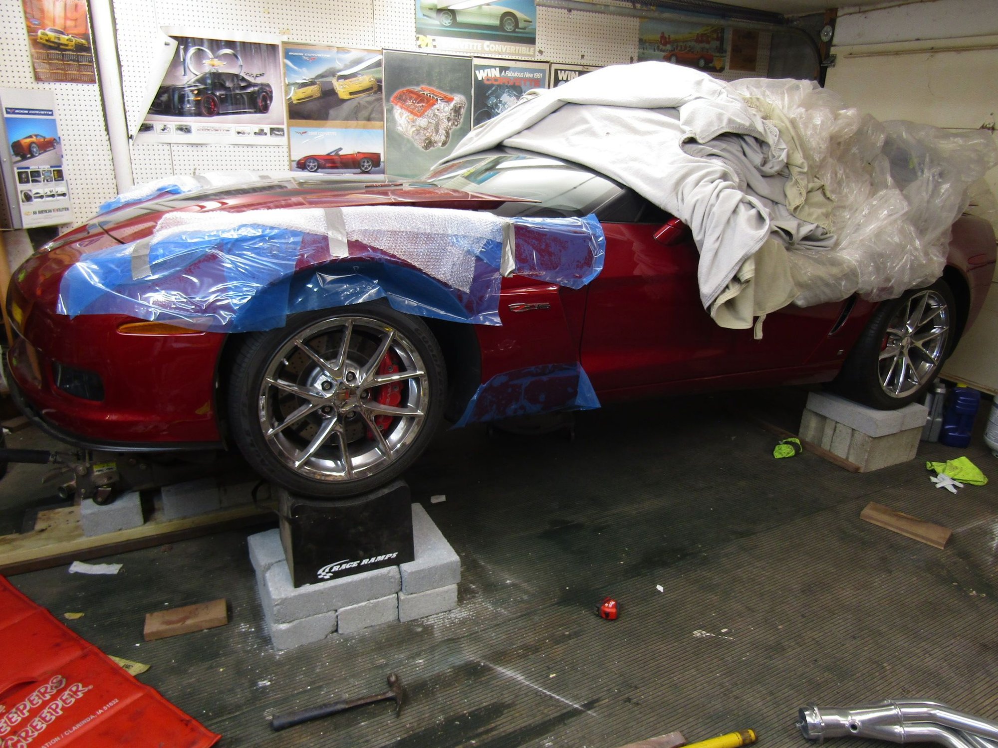

Hi
Installing ARH headers in my 2008 z06. I have the stock manifolds out and I read the car needs to be raised a minimum of 24" in the front. is that accurate? Right now I am at 18" .
Thanks
Todd

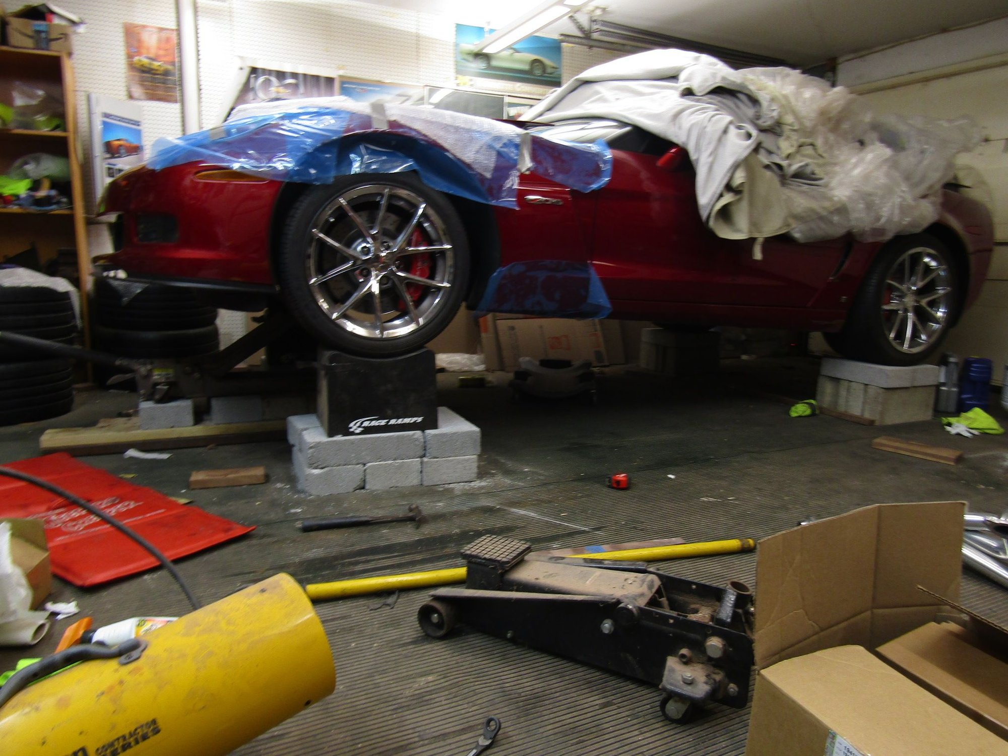

One way to get the car 24" off the ground.I have jack stands but I feel better with the blocks under the tires. Now to see if the headers will slip in.

I did mine and had no issues once I got it up around 24". I bought one of the long reach, low profile Daytona (snap on clone) jacks from Harbor Frieght and it's great. Goes under the car without hitting anything, and can get it plenty high. It's a nice investment if you do your own maintenance.

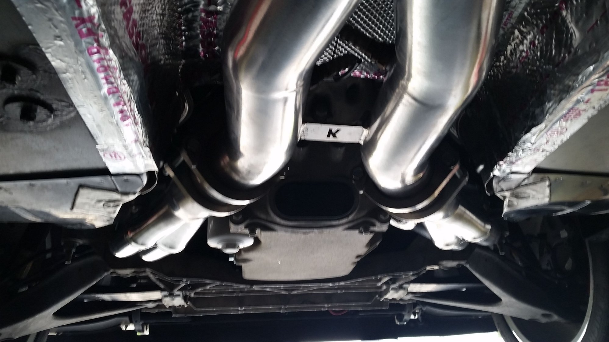

I will be installing a set of Kooks soon and was wondering the same thing..my 3 ton jack stands measure 18” also so I am going to cut up a 2x10 and put them under the jack stands to get a little more height. Hopefully that will be high enough.
I don’t know about the ARH install but my Kooks went in without a hitch with the car on 3 ton jack stands at around 18 inches. Easiest install of headers I have ever done.
