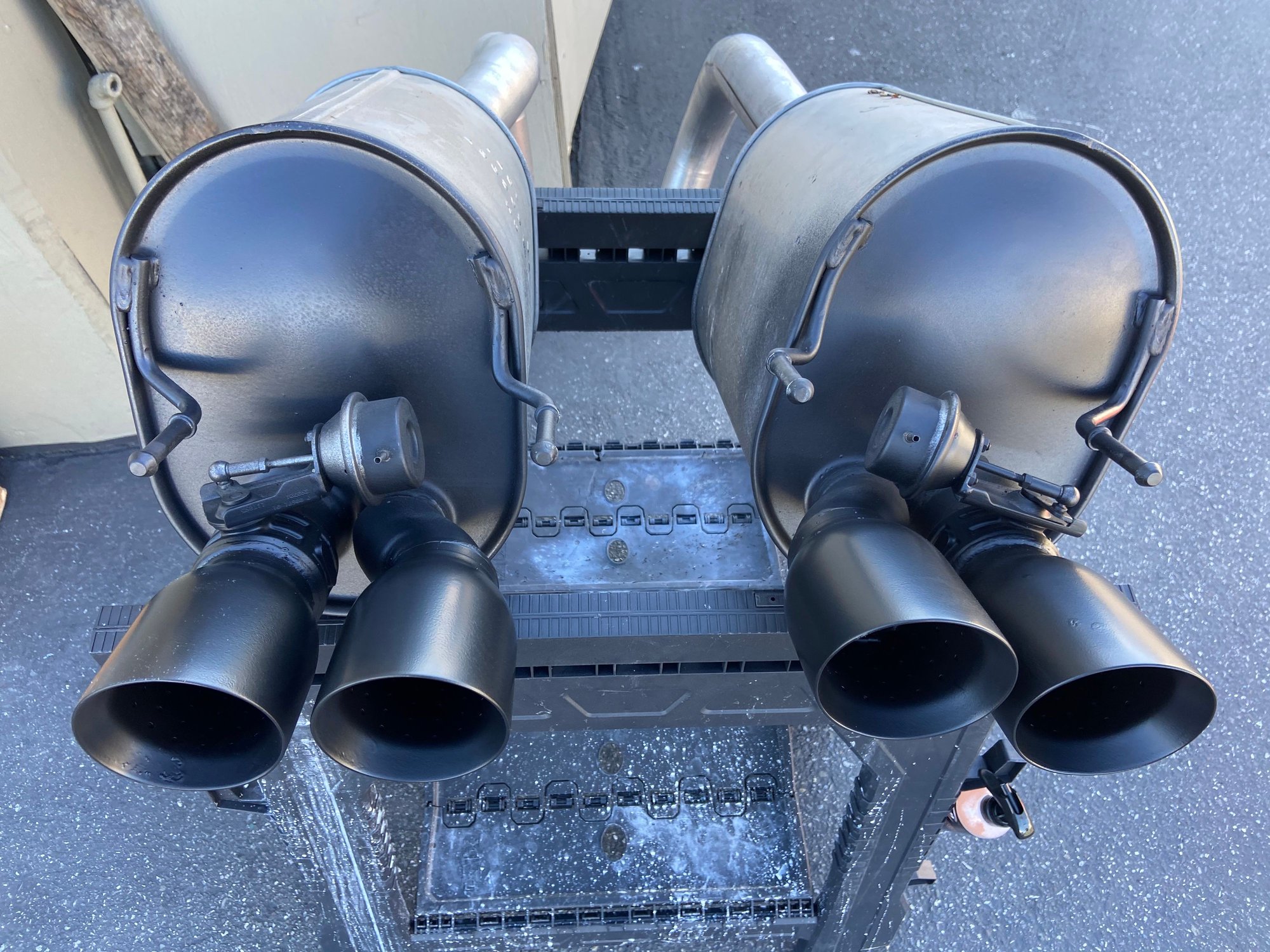

make sure to expand the area where you stick the mufflers in. And use some lube to squeak them in.
you’ll have to take the 4 bolts off for the sway bar and let it hang to get the mufflers up too.
also painted the back of the mufflers. And plastidip the tips.
