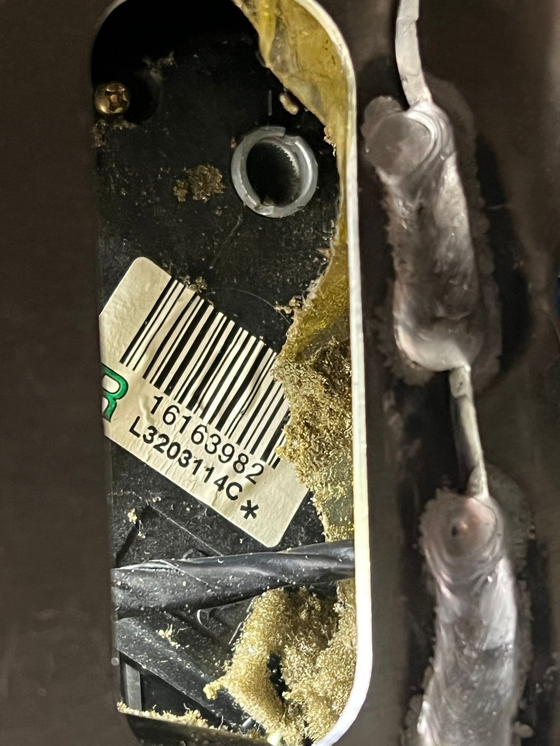

This is a pic of the right door actuator…my C5 should be the same as yours but you can see the actuator with the glovebox removed and with the AC on try adjusting the passenger temp and you will see the aluminum gear in the center rotate as the temp is adjusted !!…when you get your scan tool you may see a data PID for the actuator and the value is “counts” which basically is a voltage and that voltage would change if you had a volt meter hooked up !!
