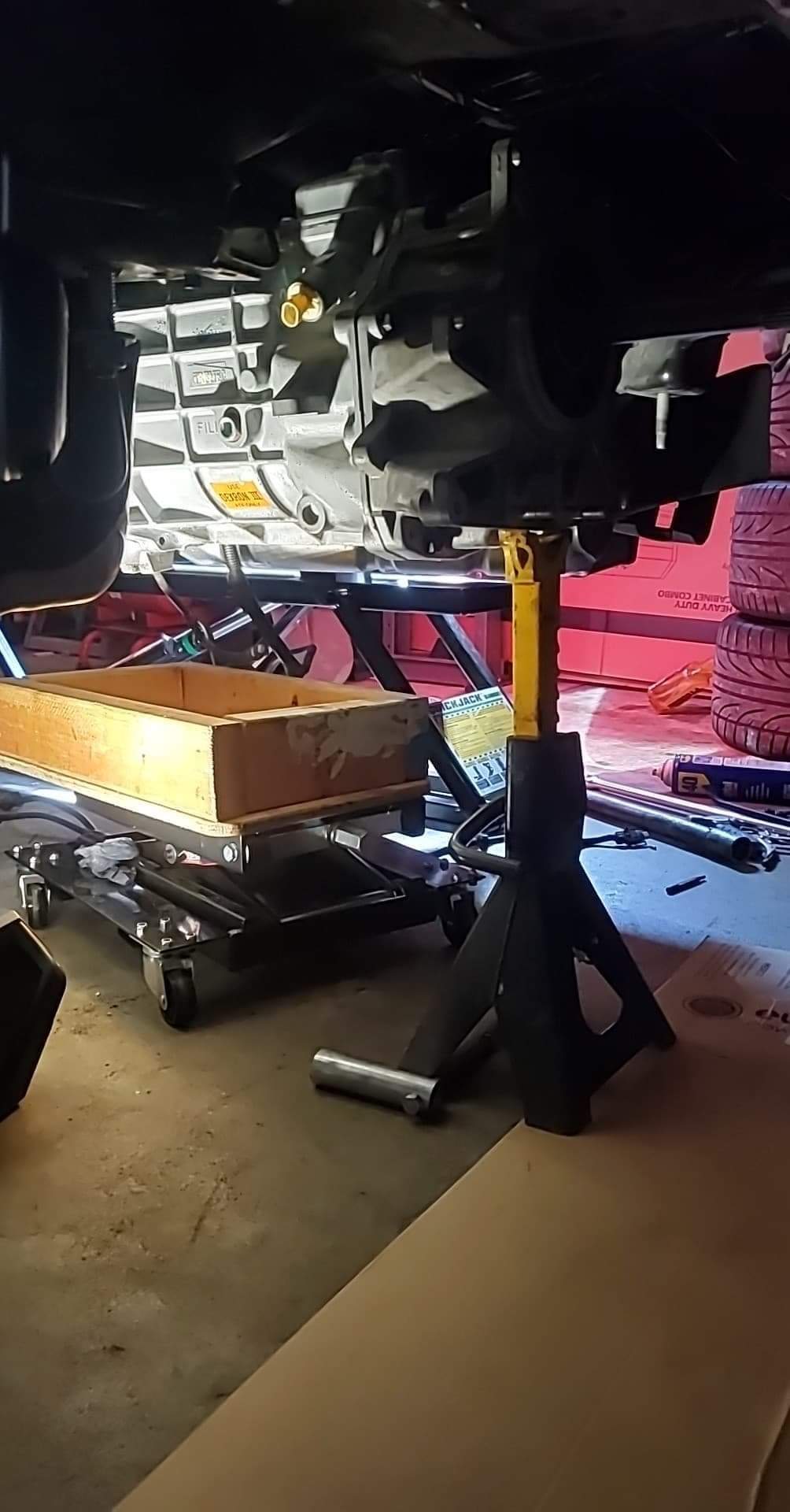

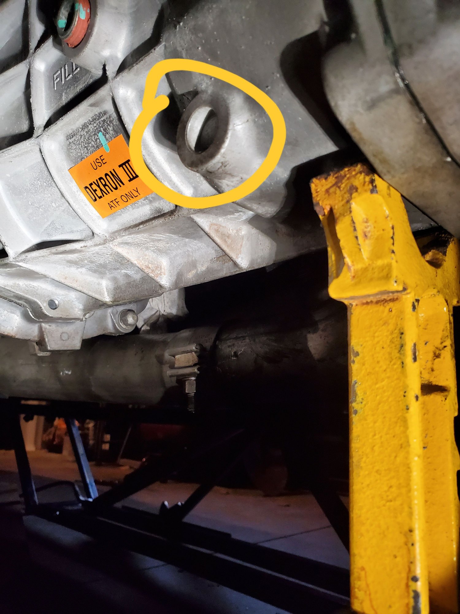

I just finished my install of a base model t56 m6 tranmssion on my corvette. The issue is I have a z51 which have trans fluid temp sensor. My replacement base trans do not have it.
So im knocking myself in the head now. My connector is just hanging. Is there a defeat or bypass for these tran fluid temp? Will it throw engine codes if left unplugg. Do I need to get a protune to get rid of it? Should attempt to install one? The thought of drilling & tapping my transmission is a bit of a nerve wreck but almost seen pretty straight forward. Haven't seen anyone install a tft on a base trans yet that I've seen.

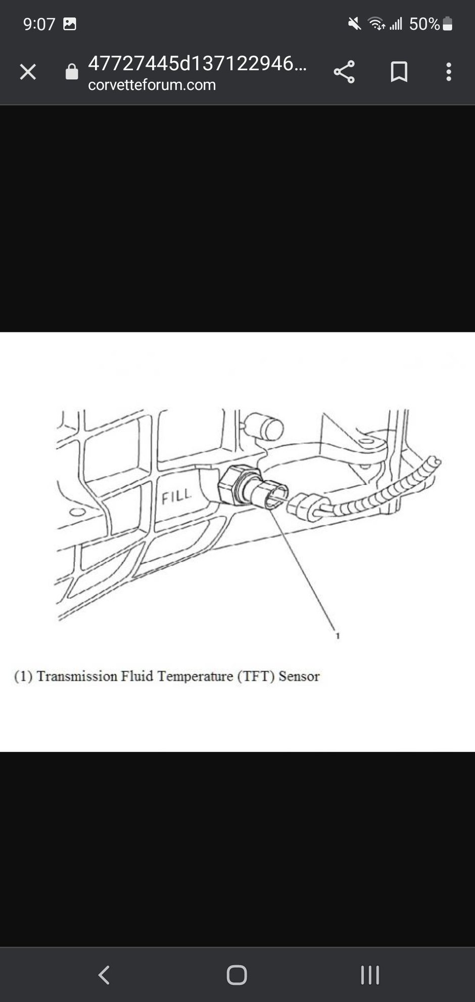

Purchase a new or used sensor. The sensor goes into the "FILL" plug and replaces the fill plug.
Well of course there's the fill plug option. Why that didnt cross my mind, who knows. I will do just that before attempting drill/tap into my tranny.
