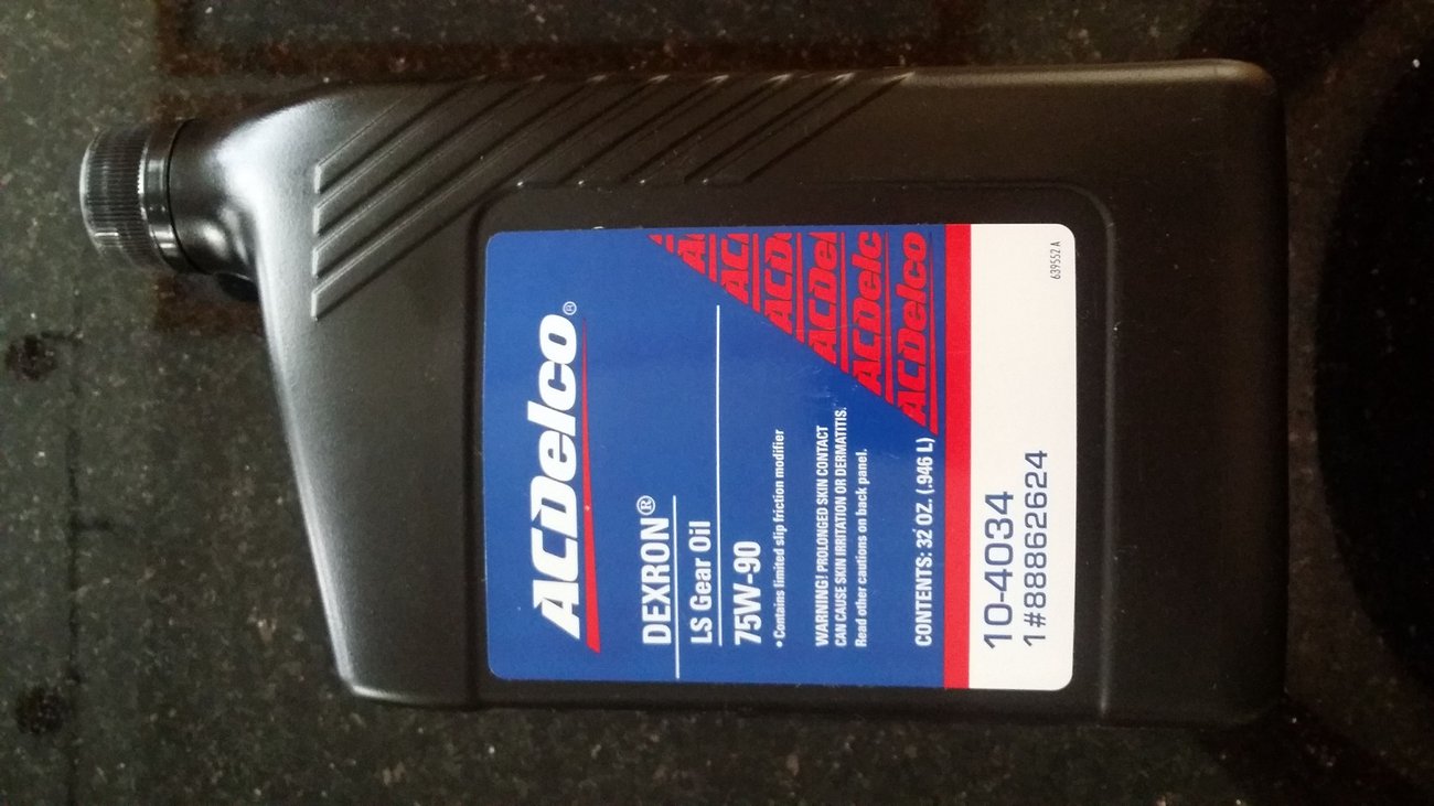

Note on diff fluid, and really just want to take a look of the color of it (open the fill plug and stick your finger in the fluid and wipe it on a white paper towel). The Diff has two sets of LSD clutch packs, and their wear is the reason that fluid turns black. So first check is to get one tire up in the air at a time to put a torque wrench on the axle nut to confirm that the clutch pack per side still have a break away value of 100ftlbs and it not time to pull the diff apart to replace the clutch packs due to wear. A dedicated road course cars can eat through the diff clutch packs in under 20K, while just street driven cars, clutch packs can last 100k or more instead. So your either replacing the fluid due to the amount of clutch dust wear in the fluid, or just changing the fluid out due to humidity/water collecting in it, so the water does not rust pit the bearings isntead.
As for lube for the Diff, use only this,
Hence some other after market lubes are too thick and do not allow the clutch packs to flush out correctly which cause them to chatter, while some other after market lubes are too slick, and can lower the break away values of the clutch pads still in good condition isntead (read peg leg burn outs since the break away values of the clutch packs are too low)..
