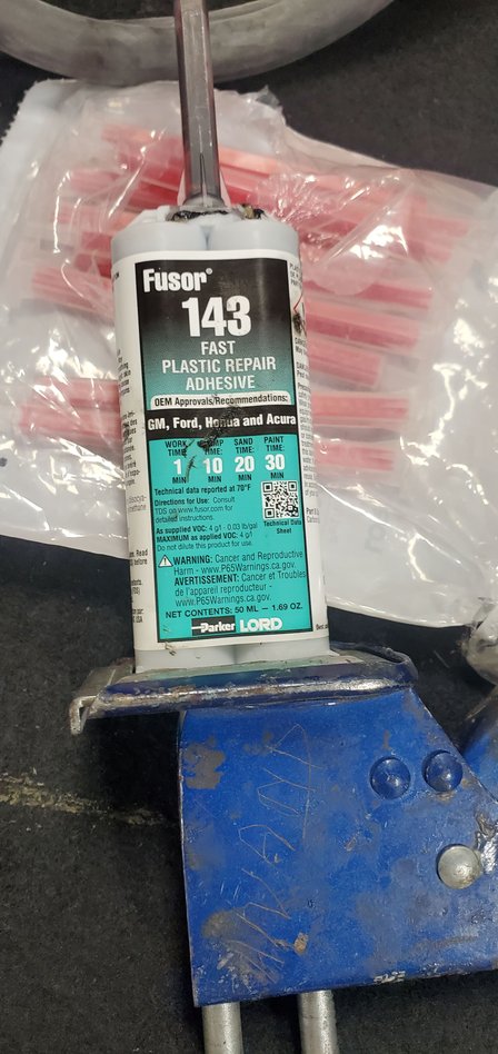

A follow-up to my post. I finally replaced the latch mechanism. I saw that to open the latch mechanism you had to grind off the two rivet posts and then re-drill through them to close it backup. Too much of a hack. I didn't want to replace with a used unit and not know how long it was going to last. Accessing it in a vert wasn't to difficult removing the door jam covers, but in the process I popped one of the retainers off (plastic ) and needed to re-glue it. I do some outside work for a body shop and they turned me on to a plastic epoxy that is fantastic. I also found a Chevy Dealership with good prices. Beat my local dealer by over $100
Thanks for all the help.
