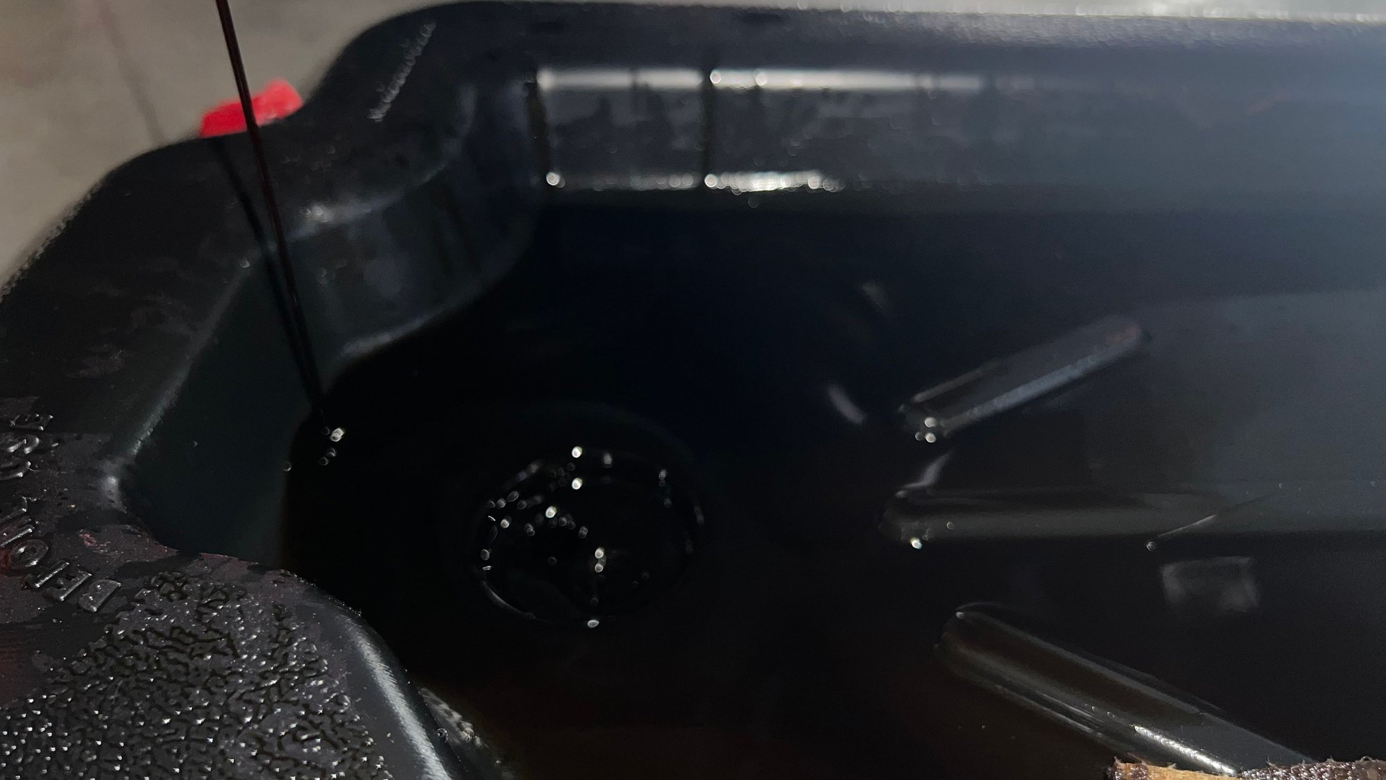

The old oil had around 2k I had 45% left till the next change but I had let it sit in dusty California while I was on deployment (10 months) then came home and never had time to change it. It came out pretty rough:/
