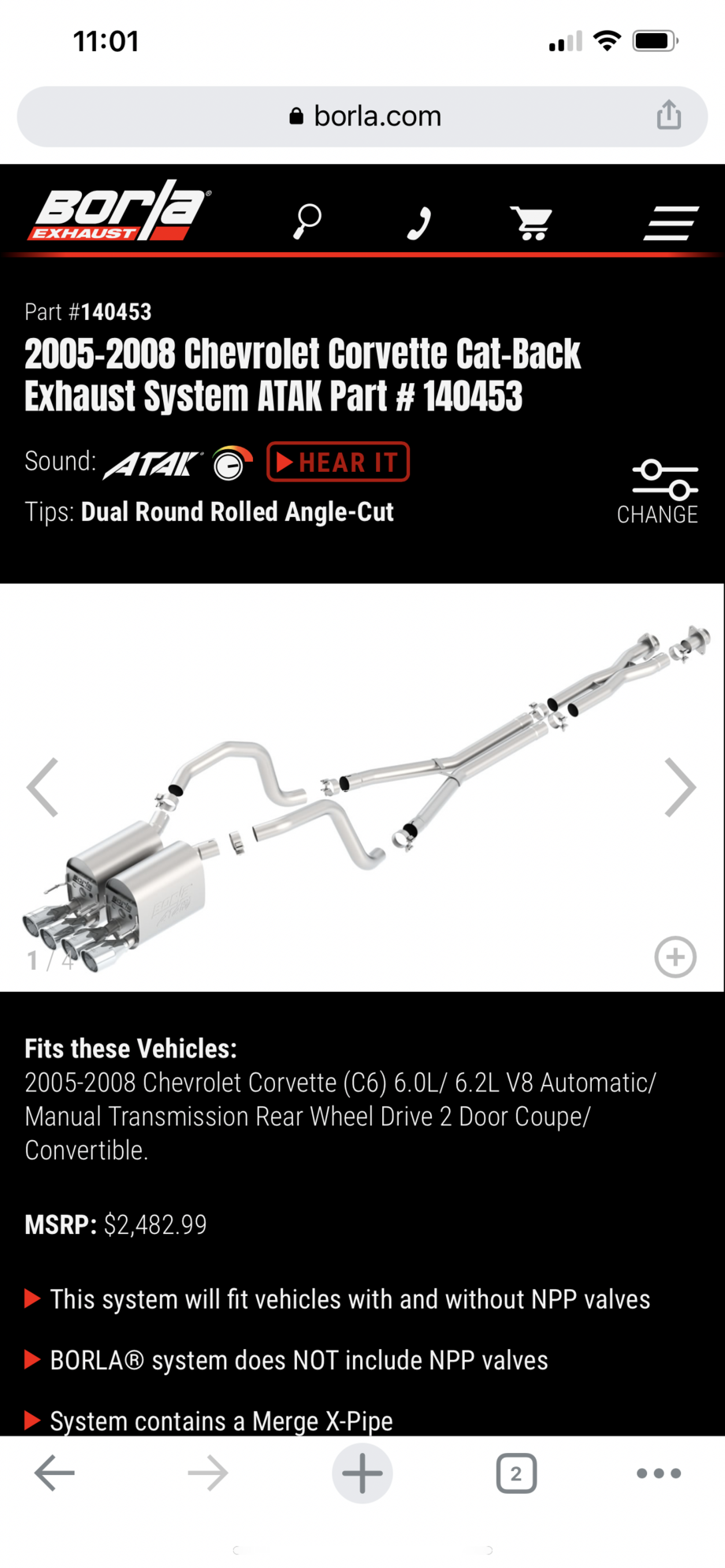

My exhaust and x pipe I ordered and installed to stock headers/cats
Its honestly not loud and I’m ready for headers and tune but looking at this x pipe I ordered it don’t look like it match’s up to any headers. If I buy headers do I need to have my x pipe cut and different end welded on? Or is there headers i can order that will butt right up to my exhaust

Mid pipe needs to come from header manufacturer. They are not interchangeable.

You will need to buy the matching X pipe with whatever headers you go with. I would post that Borla X pipe for sale on the forum, someone will buy it most likely.

I’m gonna say X pipe hooks to stock cats, then I’m gonna call one behide that a Mid pipe so I’ll be able to keep mid pipe and get headers with x pipe to hook up to my mid pipe. Or no ? Also couldn’t I just have a welder cut my x pipe to fit the same headers end wouldn’t that be cheapest bet?
