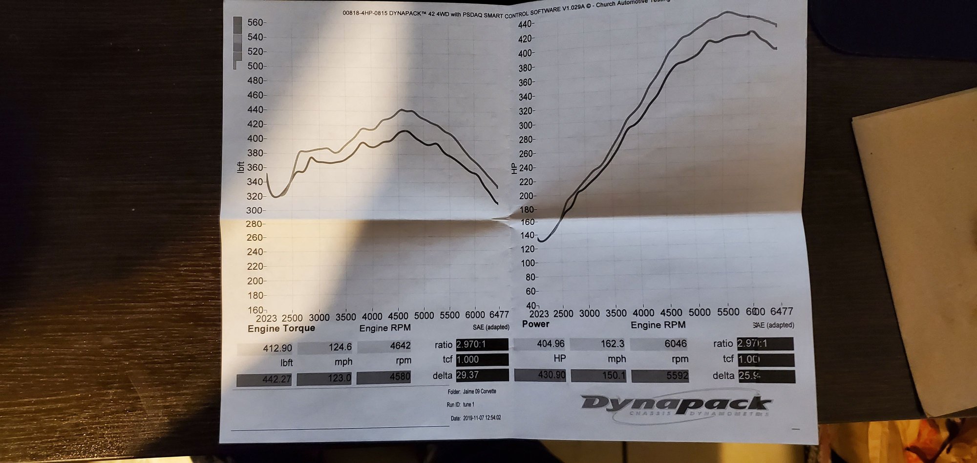

it won't do anything bad to the engine although probably not advisable. I ran my vette with no cats (longtube headers & offroad midpipe(xpipe) w/ no mufflers (slp loudmouth II) without a tune for a couple of months until I got it tuned. Here is the difference between those mods without tune and with tune.
Again, keep in mind this isn't stock and then mods and tune. It's mods without tune and then mods with tune. Basically longtube headers and no mufflers is all.
This tuner is about 1½ hours away from you. Church's Automotive
Texas Speed LT Headers w/offroad midpipe ($700) & SLP Loudmouth II mufflerless axleback exhaust ($700). Dyno Tune was $500
Thank you very much, I’ve been meaning to find a trust worthy tuner near me!
