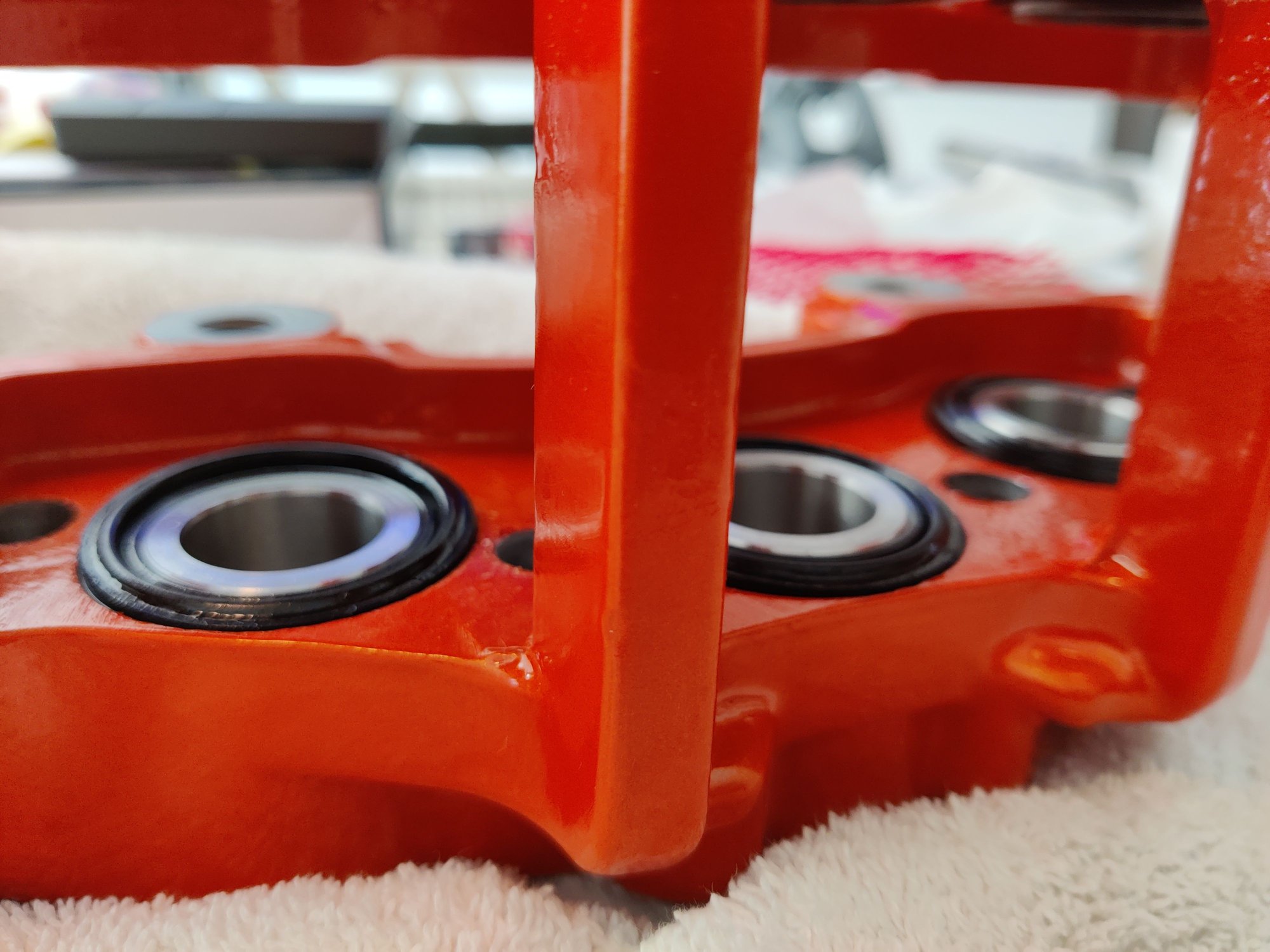

Just got my calipers back from powder coater and putting new seals pistons dustboots on , my question is the dust boots is there an up or down. As they seem to have a flat side and raised side naturally to me the flat side should ride on the flat seating area or am I wrong.

Correct direction, that it should be in the piston channel.

What should be in the piston channel dano ? The bevelled end or the flat side in the channel?

Center fold, between the caliper channel end surface, and the part that is going to lock into the piston, goes downward into the caliper.
Post a photo of the seal both ways up, and easy to tell which side goes down in the caliper.

I now see how the action works on the seal dano, much appreciated pal thanks for your time. I did the first caliper like that then I second guessed myself before starting the others cheers brother.

nothing to it as far as seals and dust/boot covers, all you need the new parts and some good assembly lube, I also got new caliper pad pins and had them powder coated, but trying to track down the rear caliper pistons as I want it all new.

HTH did you manage to get the pad pins out?
Doug Rippie has SS pistons for the rear but pricey.
You can purchase Corvette decals to make them look stock. Not sure where but I saw them on this forum.
I used brake fluid as a lubricant when pushing the pistons in. I also put the boots on the pistons and then pushed them into the bores.
Easy job.

lol, alot of grunting and cursing, I just left a message on Doug's voicemail, only place I see them listed is on racing brakes website for $266.00, been trying to find the a little cheaper but most is discontinued. The picture does not do these calipers justice there a pearl orange color but look red in the picture. I'm gonna leave them a solid color. But I did get all the pins out the rears we're worse then the fronts
