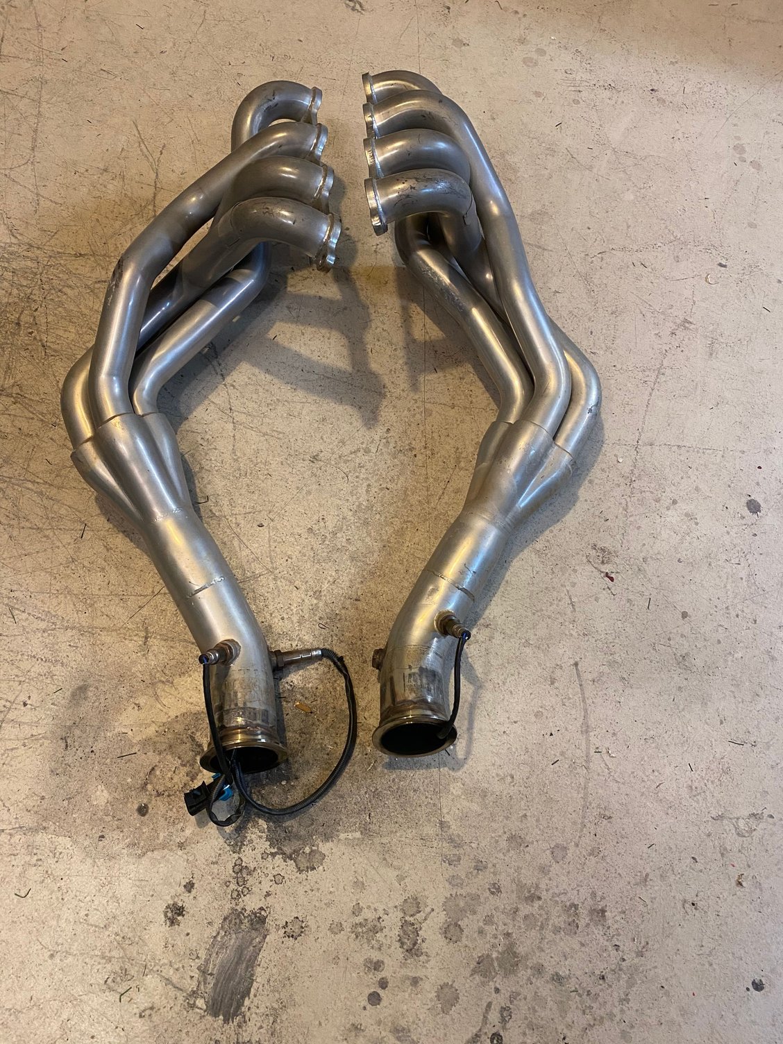

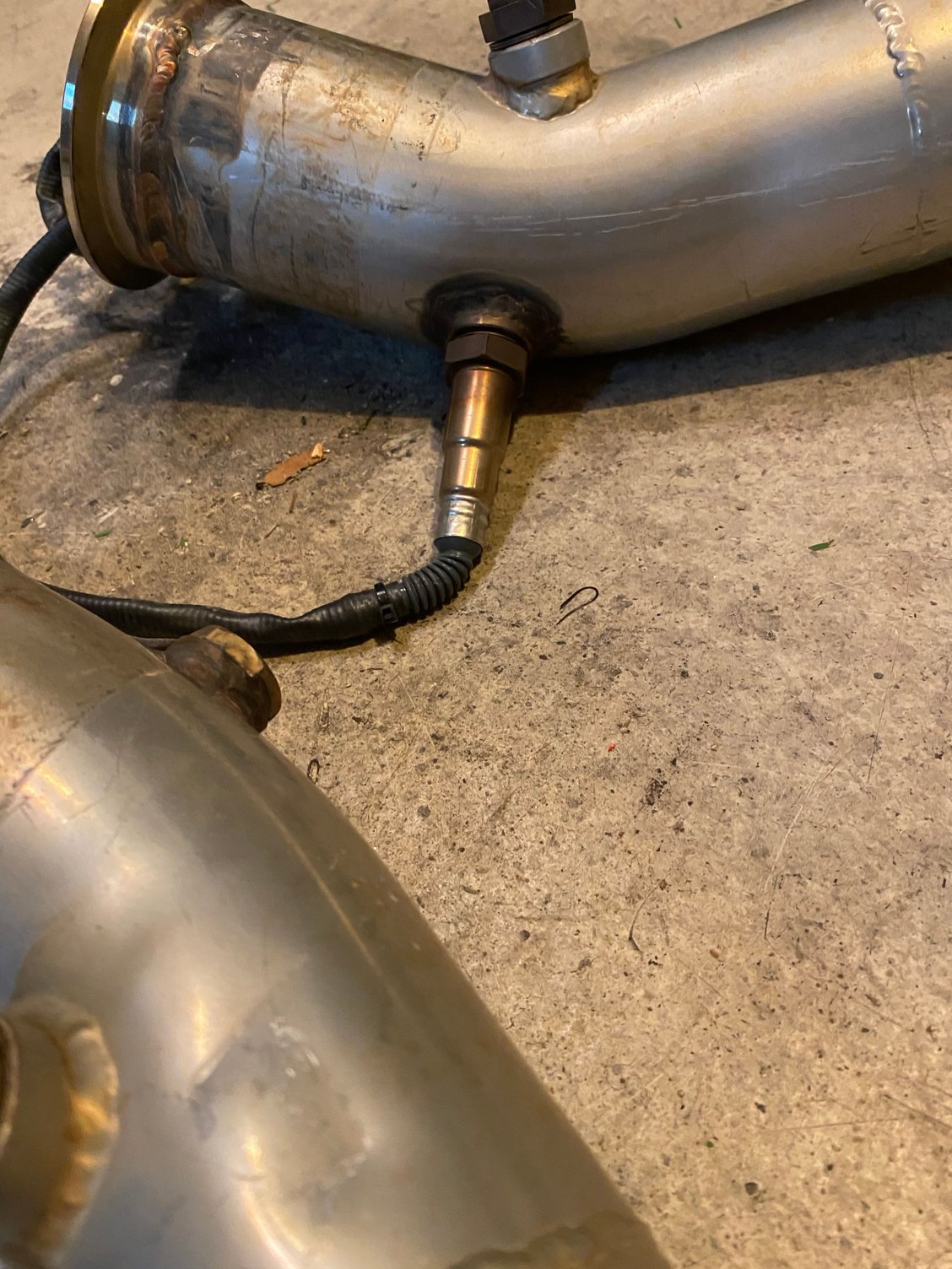

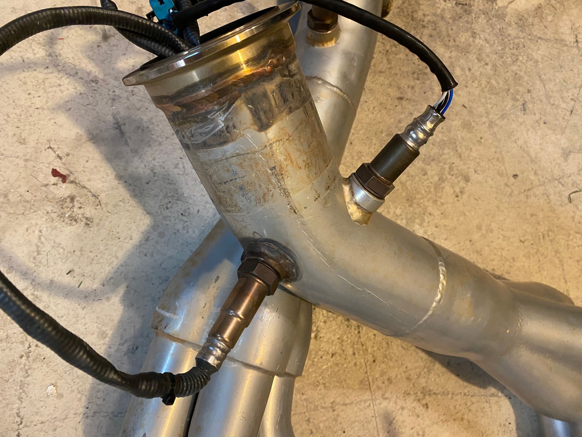

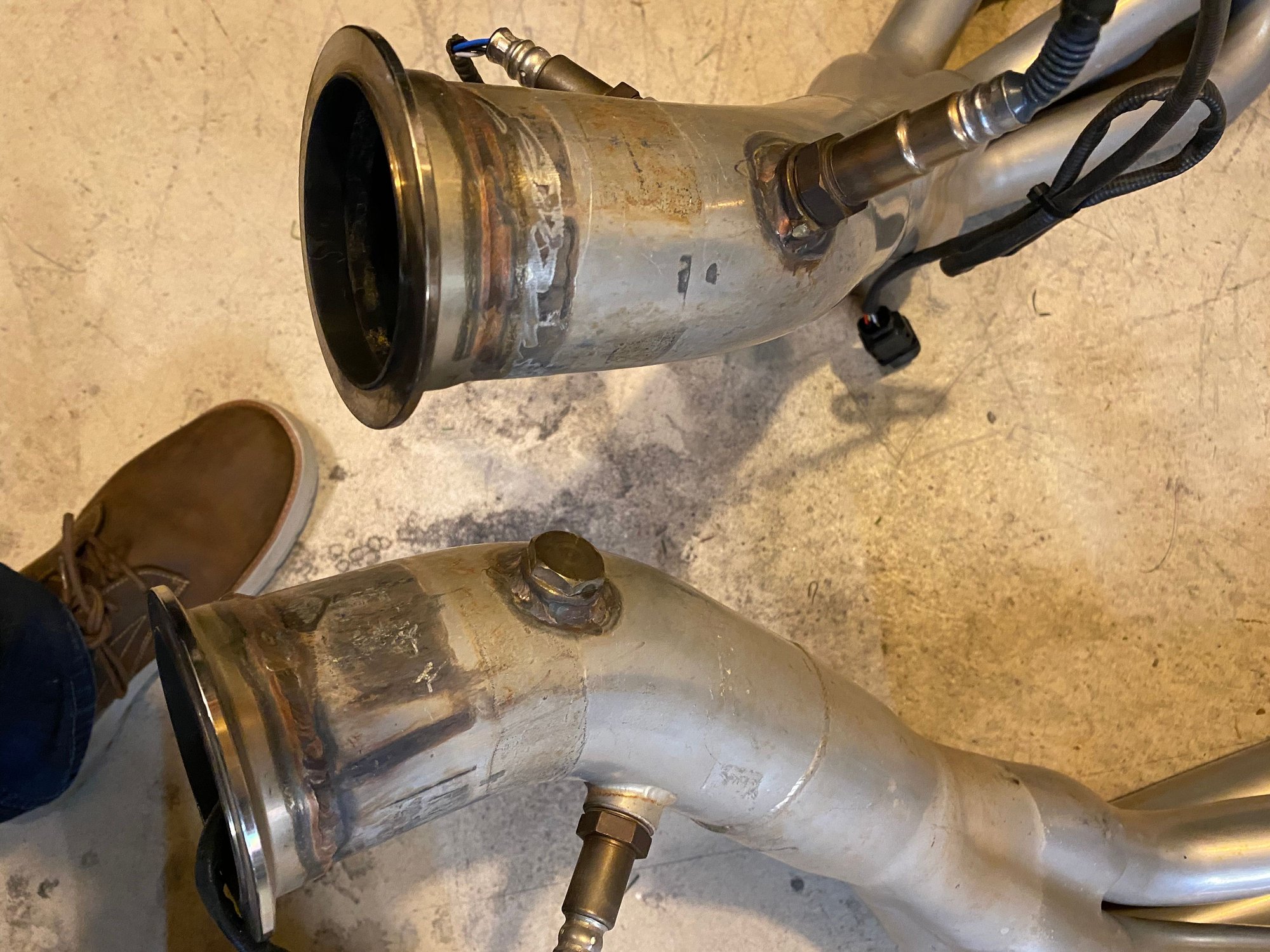

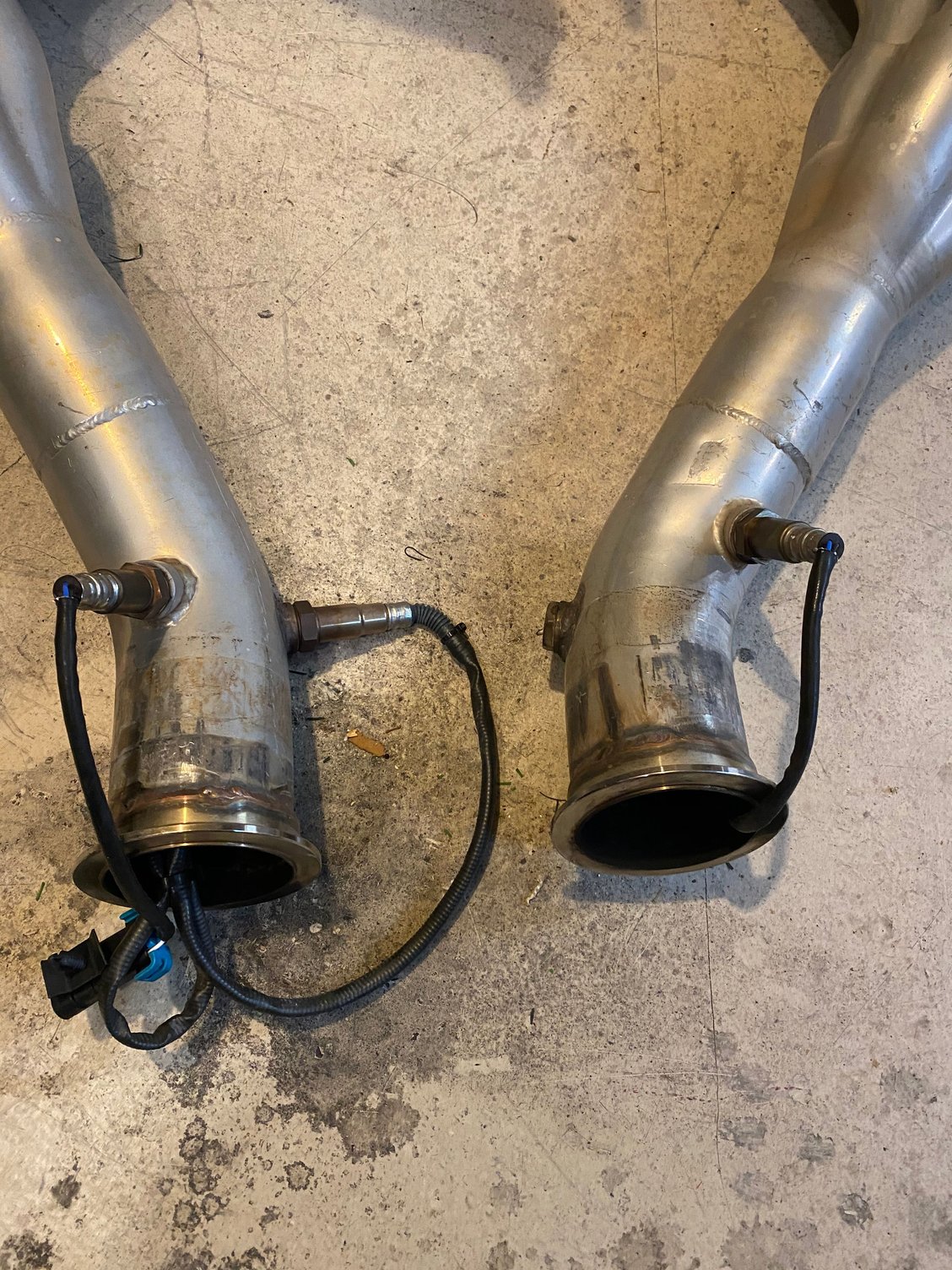

Here are some pics of how I do them. I like to weld an extra bung in the other collector as well for tuning/troubleshooting. Make sure the tip of the sensor is pretty close to the middle of the tube and angle the bung so the sensor tip angles down slightly so moisture will drain off. These are LG headers that i welded V band clamp flanges on to stop the leaking pieces of crap from stinking the car up!
The wideband bung is the bottom left header. The spare bung is on the other header.

ICANSKI2,
Thanks for the info and pics. Nice job. Good idea about adding the second fitting and just blocking it off.

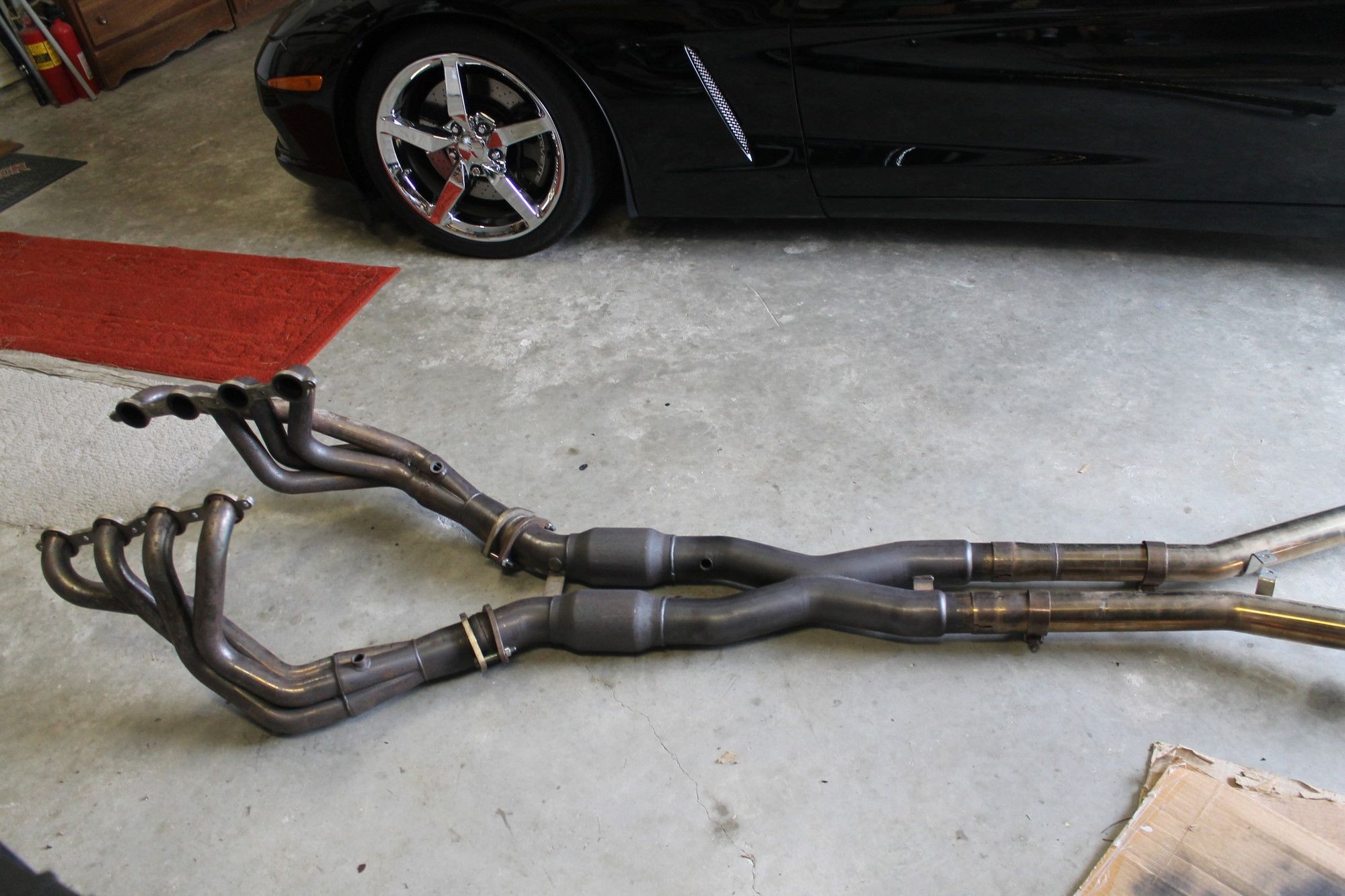

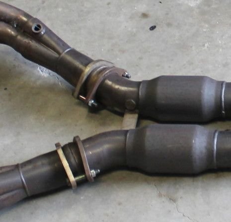

My Kooks from the factory had a bung in the passenger side immediately in front of the cat:
To AFR sensor placement
