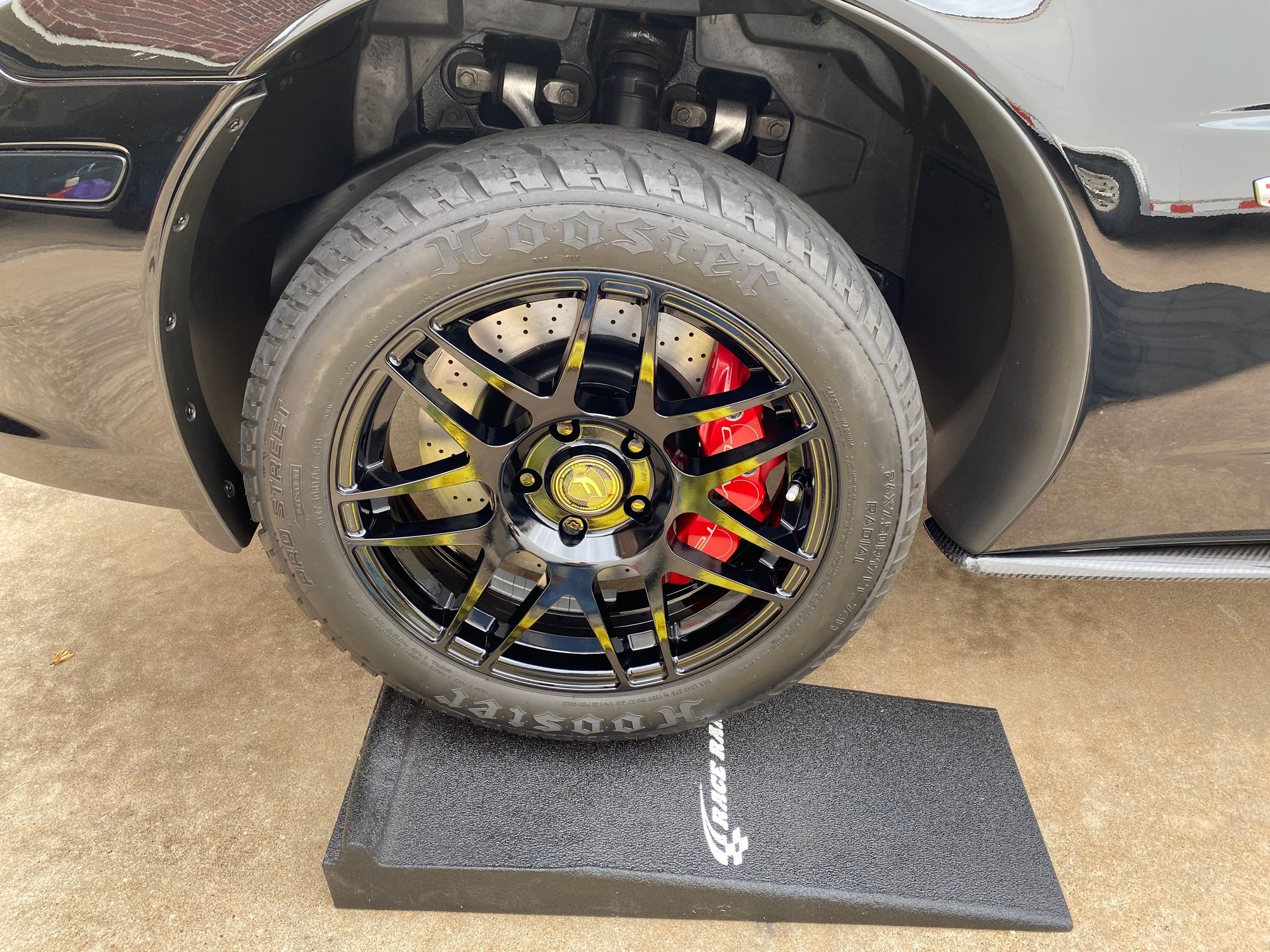

This is an excellent tire. I’ll never buy MT again for the front. Been over 150 many times with this and it’s very good.
ForgeStar fronts 17”x 5” - 26 weight is 16.0#
Hoosier LT 26 x 7.5R17 fronts 22# 25.9” tall
#38 Total
(25-1/8” loaded on car @ 40psi)
When I ran the Hoosier 4.5” bias ply, it was on a 4.5” wheel. Don’t think it would look right on a 5” wheel.
I get the Nannies with the current set up 25” Rear - 25” Front - also, so I just put it in competition mode and forget about it.
