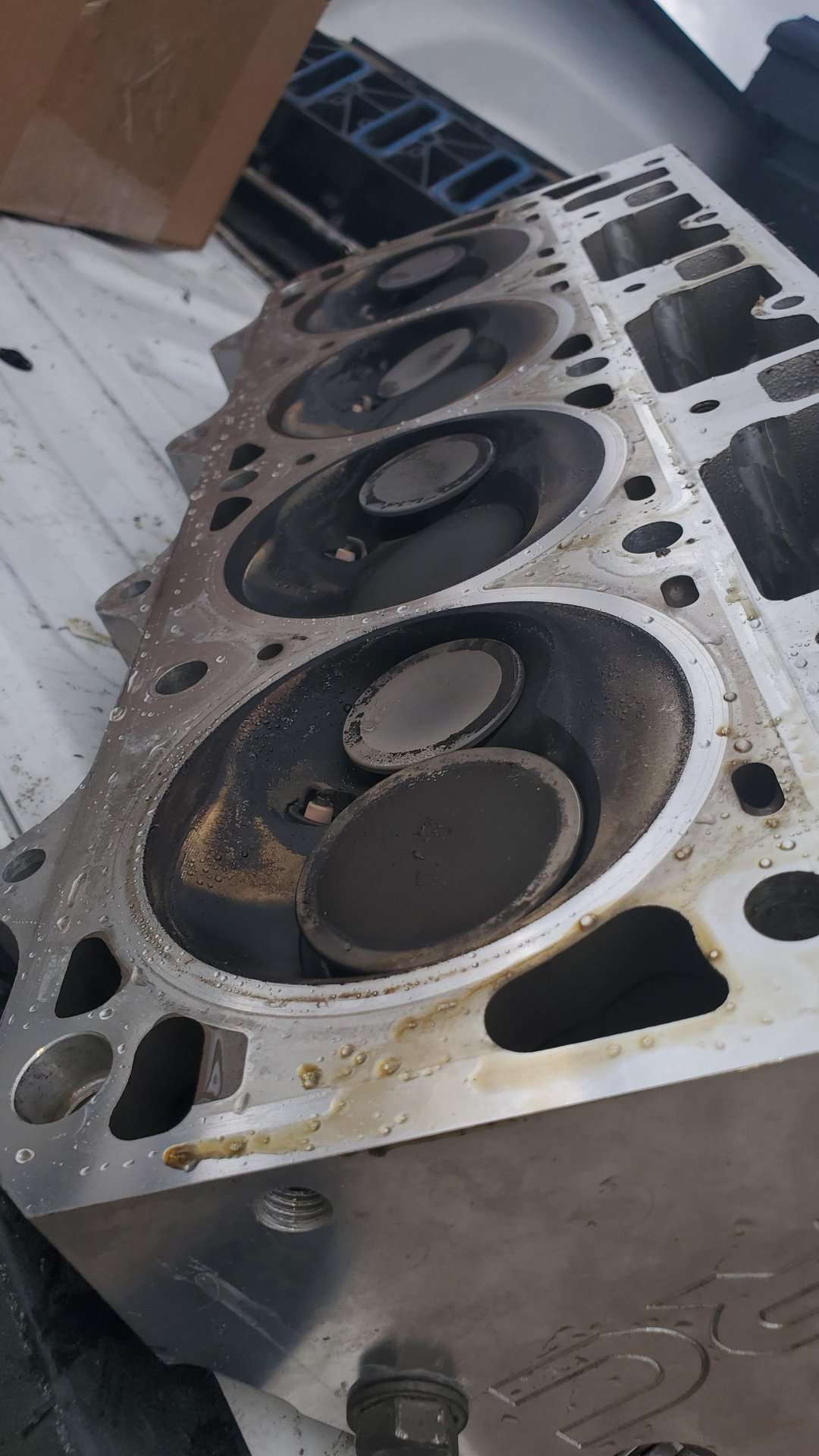

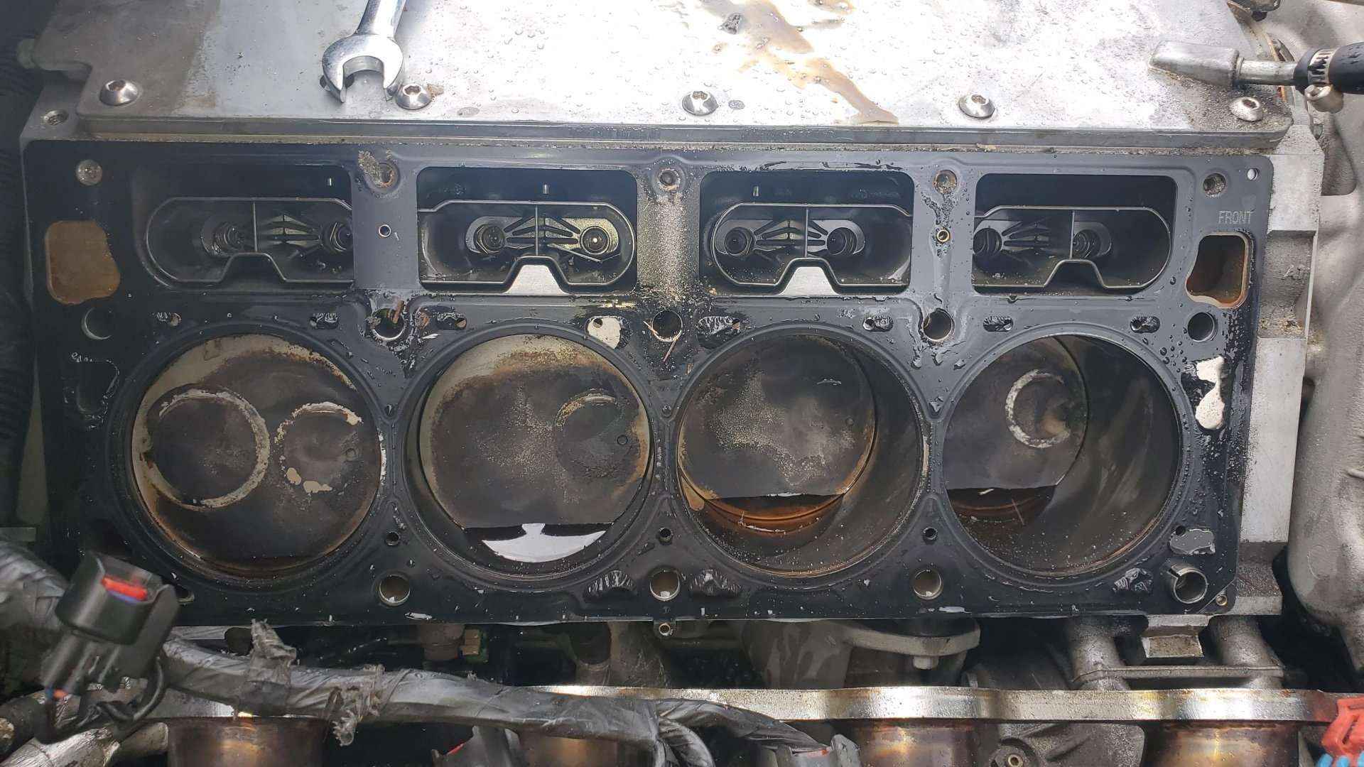

Hey Guys,
Quick update. Yanked the heads, 8 bent exhaust valves, 4 intake. Guides are all fine, ordered new valves from Texas Speed and having them put in along with a valve job on every valve, and ordered a Rollmaster Billet Single timing chain set with IWIS seamless roller chain. Still haven't pulled the timing cover off yet, but all parts including oil pump and chain damper are getting replaced. Pistons have some small nicks in them, plan on smoothing them out with some 500 grit sandpaper and calling it a day. Worst piston damage barely catches my fingernail, seems like it mostly just knocked carbon off. Thinking the hollow stem valves just bent easier, maybe a plus lol. Had a long chat with Texas Speed's crew, they said they typically never see timing chains fail, but do NOT think the under drive pulley has anything to do with it, more so the mileage on the factory LS2 chain. They also said as long as there are no cracks on the pistons, sand them smooth and run them. Other odd thing, to me at least, not a single bent pushrod or broken rocker. Pushrods all rolled perfectly flat on glass, but will be replacing them regardless, along with upgraded trunion rockers. They also said not likely PTV issues due to cam or head milling, i'm running a similar combo they have set up multiple times with ample clearance. The As Cast 225 heads (62cc chamber stock) I am running have BETTER than factory valve clearance compared to 243 heads, and I had them milled to 60cc chambers, which is only a .014-.016 mill. Of the 4 bent intake, only 2 were even visibly bent. Seems like the chain snapped and ate up all the exhaust valves first before the valves were closed, and cam left at least 2 intake valves open at all times regardless. I will be double checking PTV anyway, and possibly a factory gasket as well, .051 thickness vs the .048 I was running. I will also be thoroughly cleaning/chasing all head bolts, lots of sand getting into all the crevices here in SW Florida. All in all, so far a 600$ or so repair, lots of labor but I'm handling that myself. I think I got off lucky!
