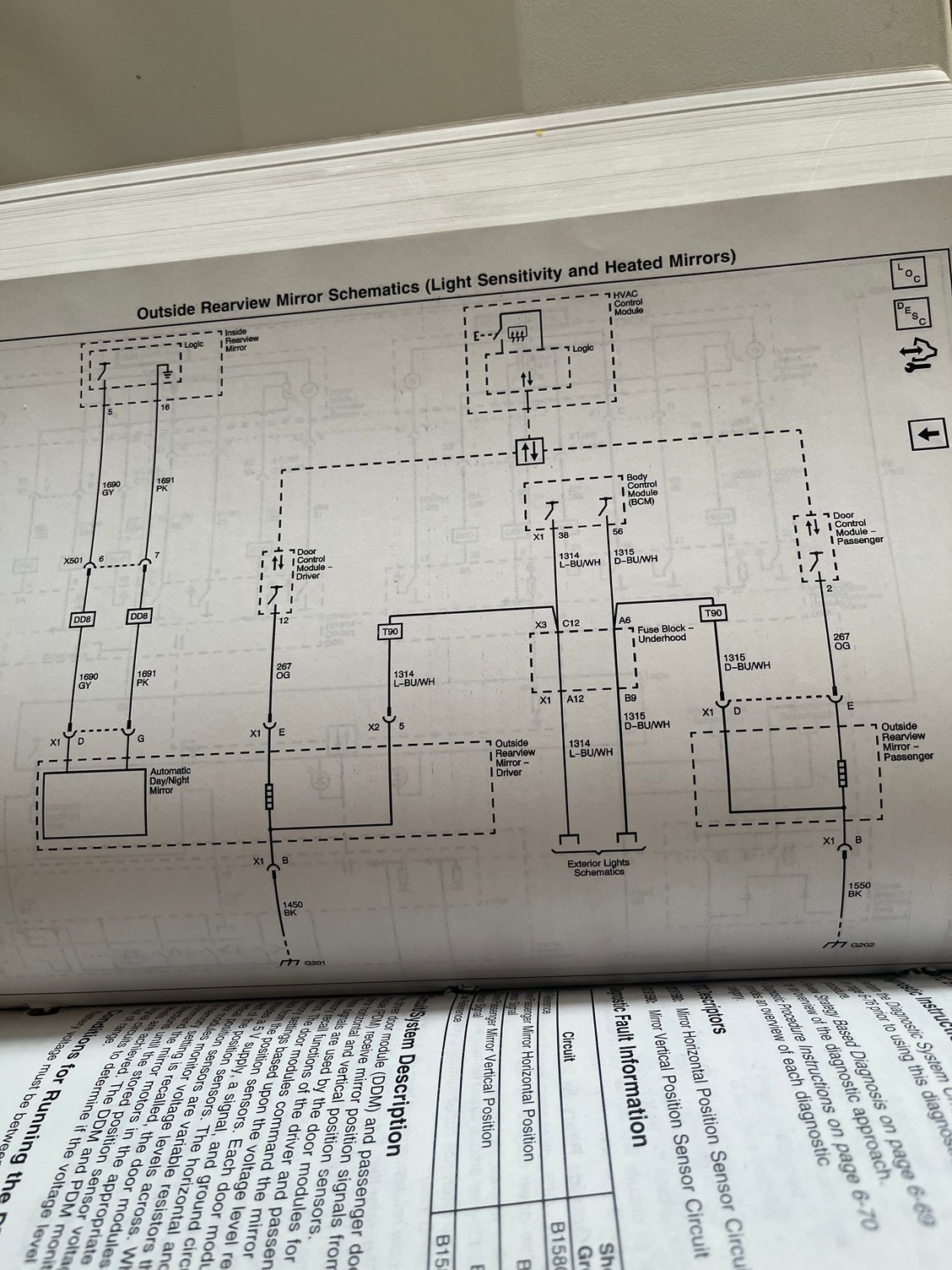

hello . can anyone tell me what the colors of the positive and the negative are on the heater side of the c6 mirrors . cheers kev

Poor at taking photos hope these help .... 2011 Manual

thank you very much would you happen to know the colors . cheers kev
sorry. I know less than you about wiring. But if you can expand photos. Most colors are shown Luck to you and your.

Here you go.
File Type: pdf
File Type: pdf

thank you

thanks to you both that as been very helpful
