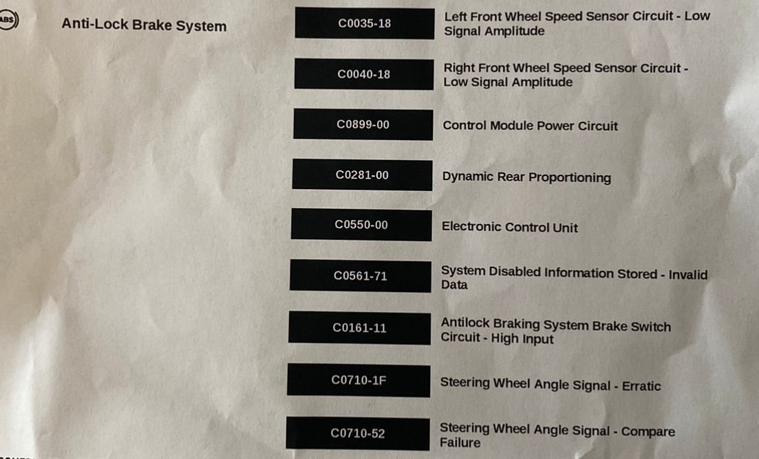

I’m new to the car scene, I just picked up this 2005 c6 ls2 corvette about 3 weeks ago and it started throwing these codes recently and i’m curious what I can do to fix it or what to do about it.
Any tips or advice are greatly appreciated!

First guess would be a grounding or connection issue in the EBCM, but the folks in the C6 section will be much better equipped to help you.

Many of these codes can be caused by a weak or defective battery, I'd check that first.

Start with a fresh battery and clean up the ground points under the hood. The C6 isn't a car, it's a computer with wheels.

Then after re-indexing your windows, clear the codes and drive it and see if anything comes back.

New battery is a good recommendation. Stick? If so, park in reverse. Look up Ranger method. Battery tender is recommended. Check out the harmonic balancer, replace with an after market one if needed.
