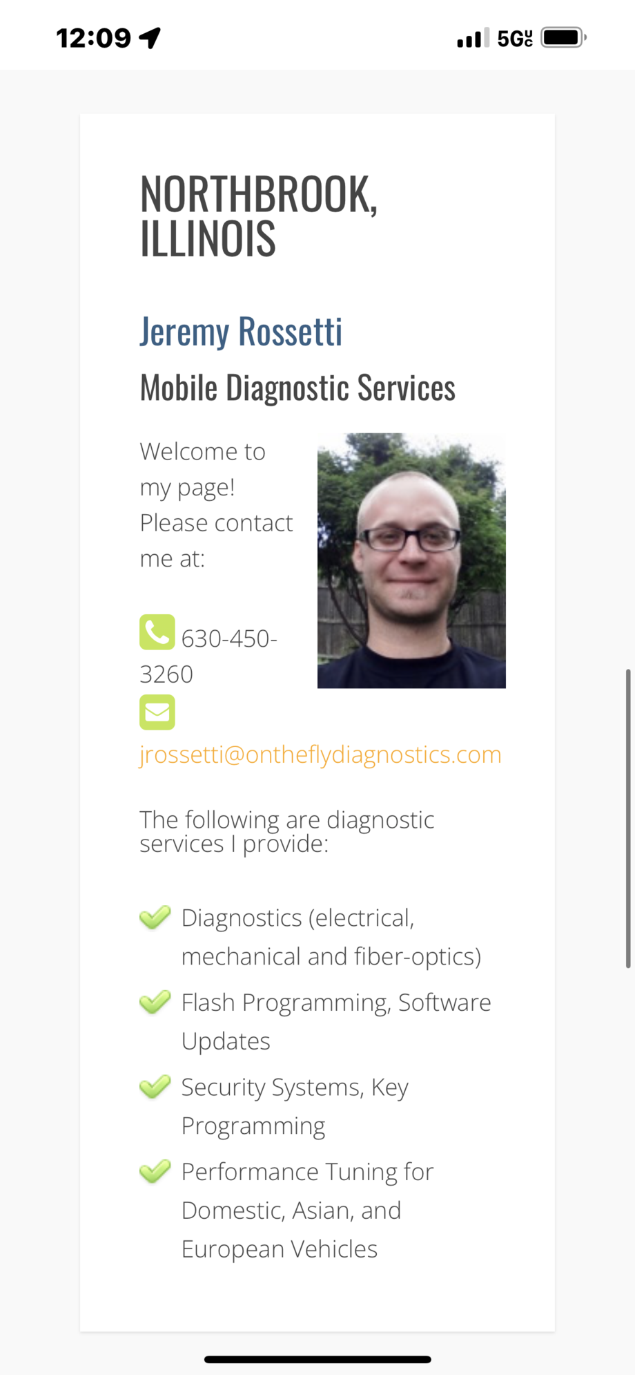

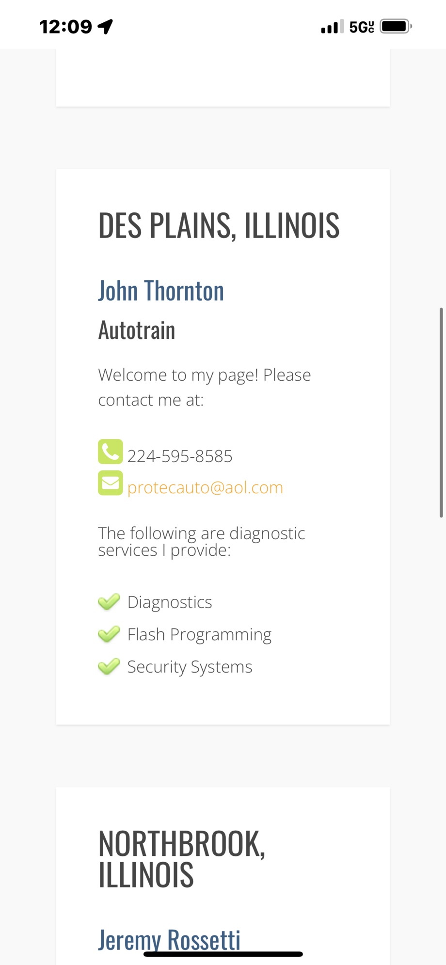

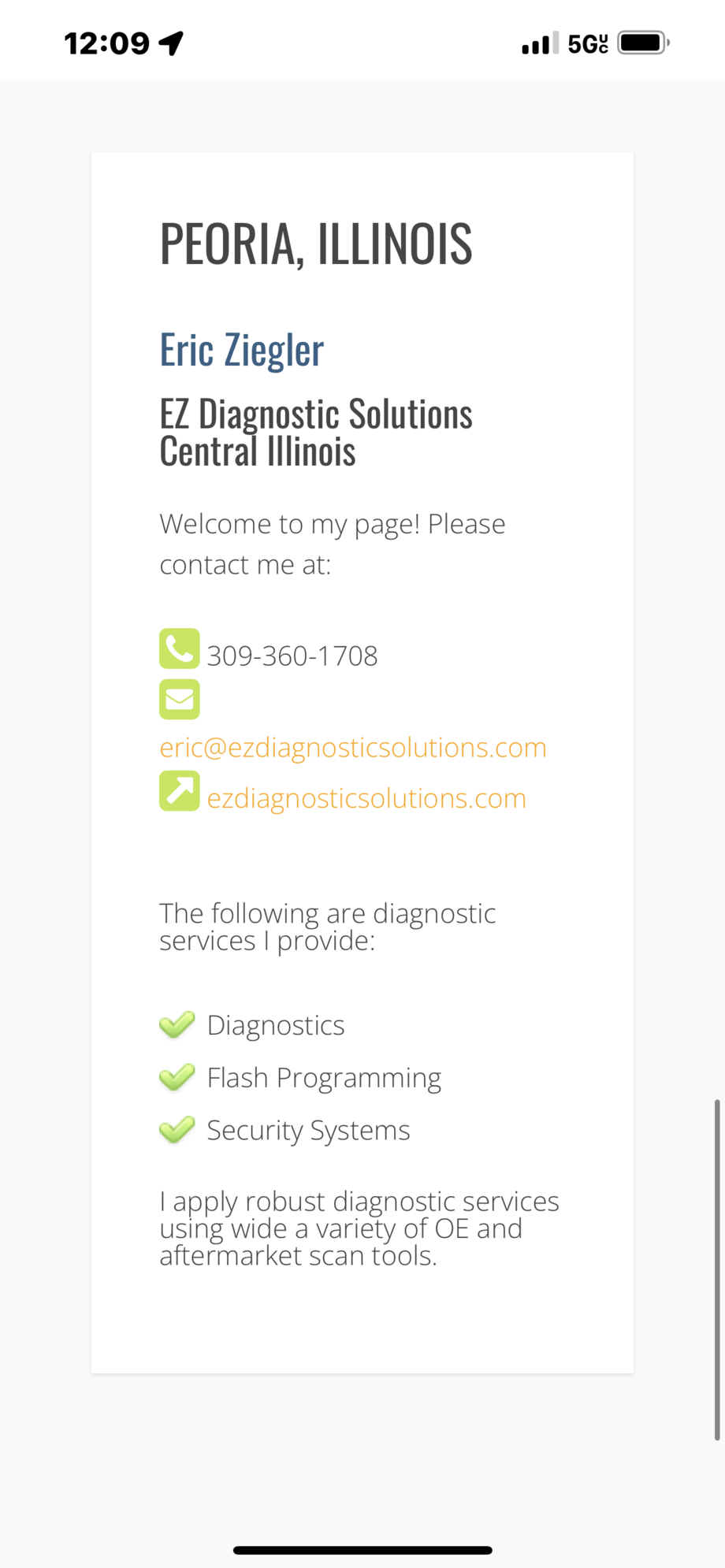

If the connector is good at the MAF sensor they should be checking the same connector pin at the ECM for pin fitment or corrosion too…if is 100% an ECM change you don’t have to bring it to a dealer for programming…you should call around your area for a shop that can program it for you…these guys are in your area I believe…best in the business as far as diagnostics and programming…John Thornton is probably one of the 2 top diagnosticians in the country !!

Originally Posted by apatel2106
Really appreciate the lightning fast help here!
If you do use one of these guys they WILL find your problem…let us know if you do use them and what they find…I have attended some of John Thornton training seminars over the years and this guy knows his stuff…one of the top instructors in the country !!
