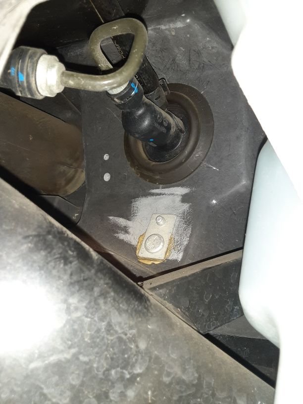

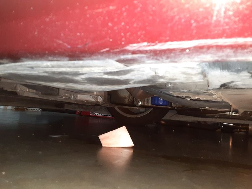

I have a leak right behind the left front tire below the brake and clutch master cylinders, it is not brake/clutch fluid but it is red and appears to be ATF. The car has the Z51 package and is a 6-spd manual. I think it has a gearbox cooler, could it be leaking from a cooling line?

The transmission cooler lines run up the center of the car until the firewall, where they angle toward the passenger side. Sure it isn't engine oil? The filter and drain plug and oil cooler fittings are all in that general area. Time to crawl under and have a closer look.

Been down there once already. At first I thought it was from the brake or clutch master cylinder but both are dry, I removed one of the splash panels for a good view of the clutch m/c. It's not engine oil, thought maybe coolant because of the color but it does not smell like DexCool. I might have time to get it up in the air again today but the rest of this week is pretty busy. I was planning on taking the car for a little trip on Tuesday but that's not gonna happen.
