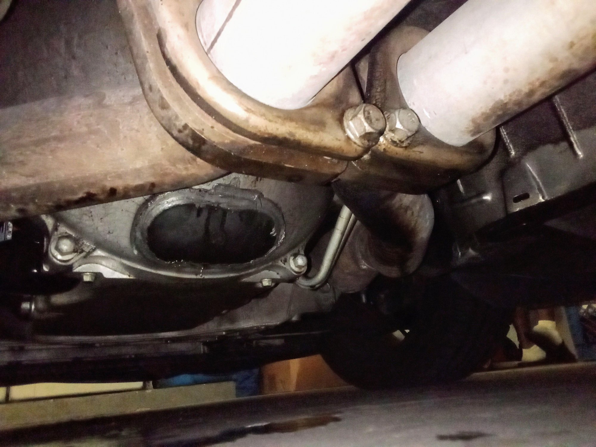

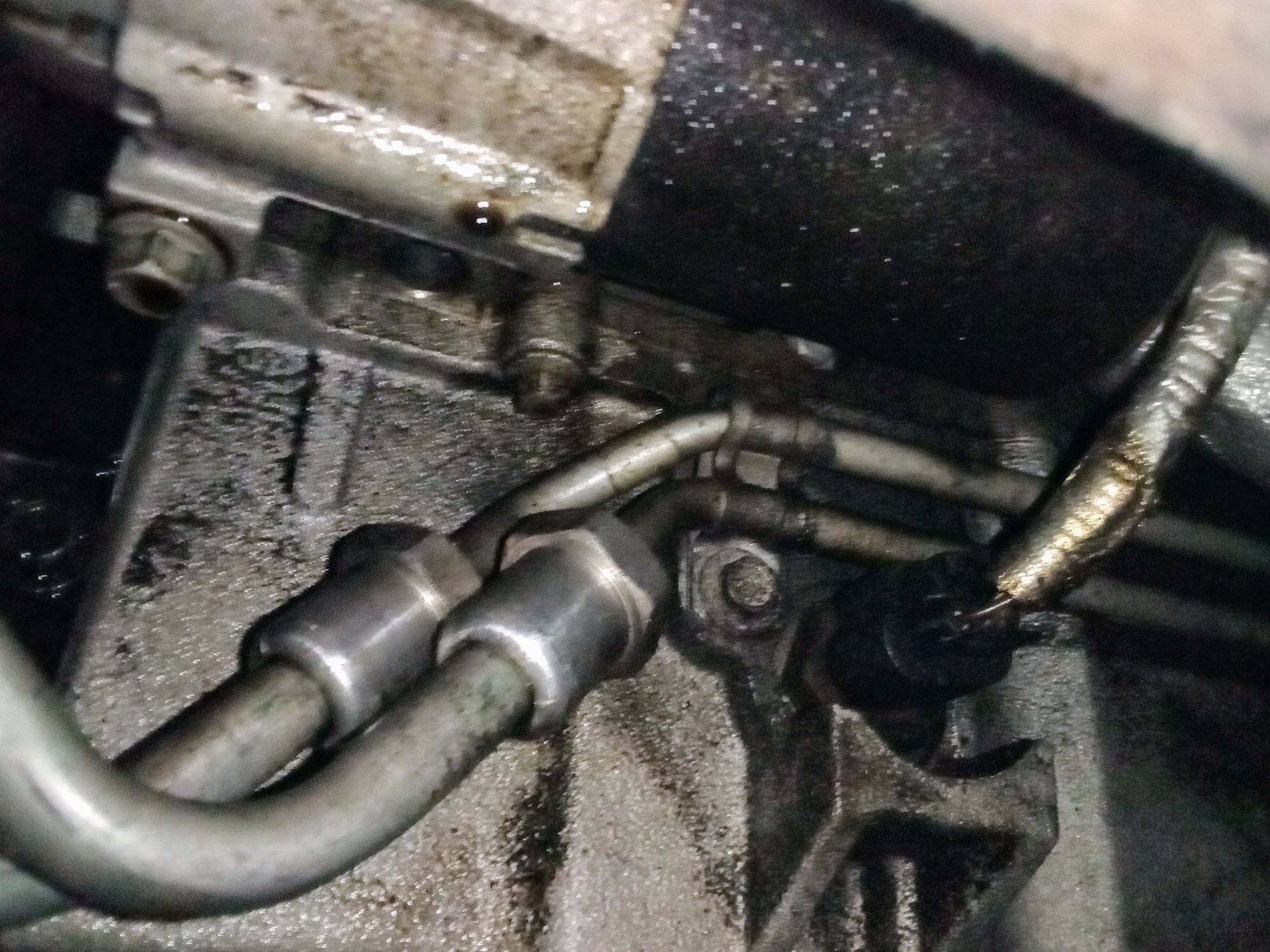

After getting my car back from having the oil changed I am having a severe oil leak a day later. I noticed the oil was about a half quart overfull and smelled oil burning. The guy said the Fram filter I got was the wrong one and he used his. There seems to be oil leaking everywhere, down the filter and even down cooler lines on the passenger side. I shut the car off and it still seems to be dripping but can't find the source. I was thinking the Oil temp sensor? Filter? I hope the rear main seal didn't go bad... If it was the pan gasket it wouldn't fail all at once right? Also if it was from an oil overfill issue it would have happened yesterday I believe, not a day later. Also I haven't got to see this car on a lift yet, what the heck is this welded thing is on the bellhousing? Is that a patch??? I sure hope not. Anyone have any thoughts? Thanks
oil is running off those two lines on the right side as well.
oil dripping off filter and pan

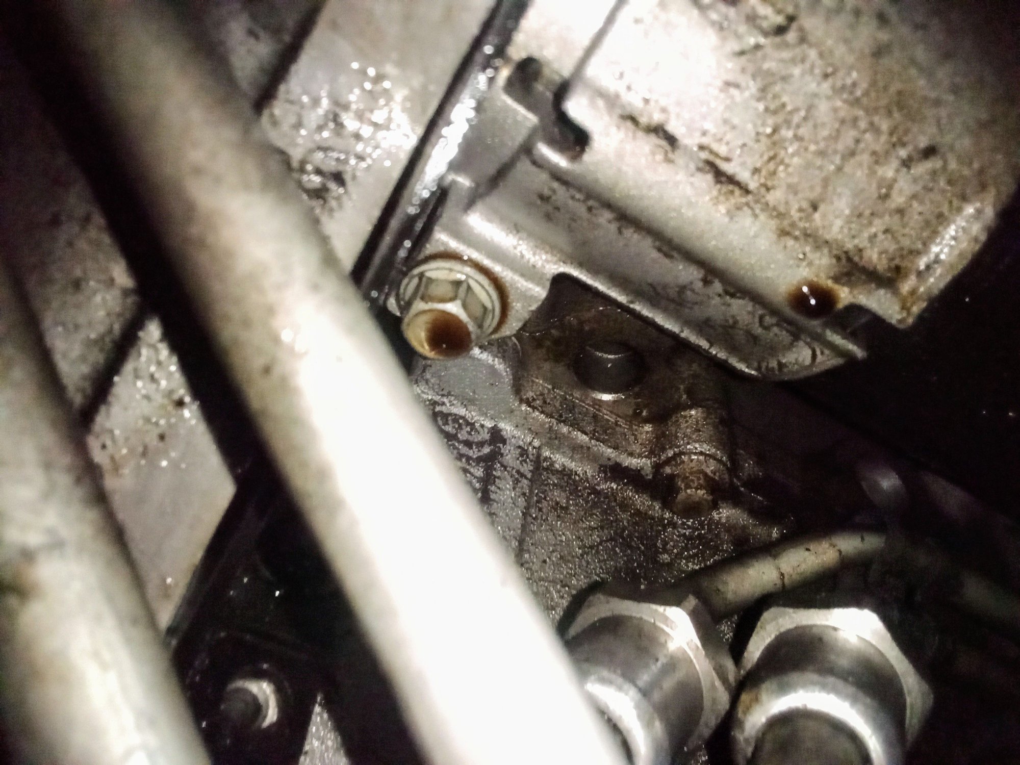

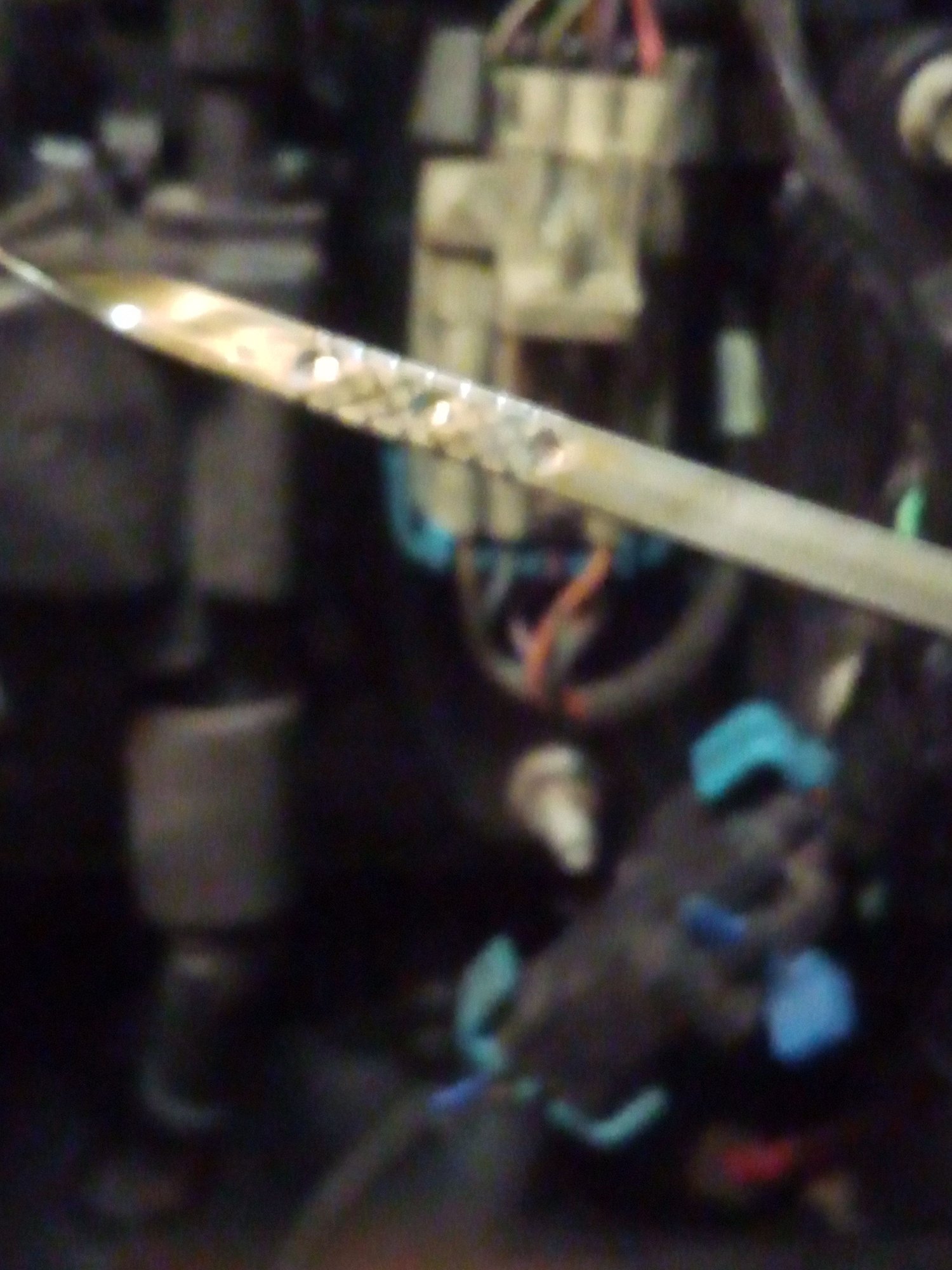

More pics, oil everywhere! Sorry for the dipstick pic but you can see it's about a half inch above the full line nearly. I'm assuming they put the full 6 quarts I gave them in it.
Even after leaking oil it is still overfull
Oil dripping from everywhere suddenly after oil change
Running down those lines on the side of the pan as well (not trans fluid)

That looks like your inspection cover has been sealed with some kind of RTV.
As for the filter issue, what filter did you give him to use ?

Well we got the car up on the lift, oil is coming from the rear main seal. The pan has a small leak too and both valve covers. I can't figure out where the dripping is coming from off those two lines either, what are those? Parts store sold me a 3506 Fram filter, it's a 48 on the 07' so the shop did put the correct filter. What gives here, it's like all seals went out at all once after the 5-30w Mobil one oil change!

It's a 2007 Ls2 automatic. It looks like the oil is running down the oil cooler lines almost. Is that a gasket behind where the cooler lines mount on the oil pain? That might be the source or my leak(s).

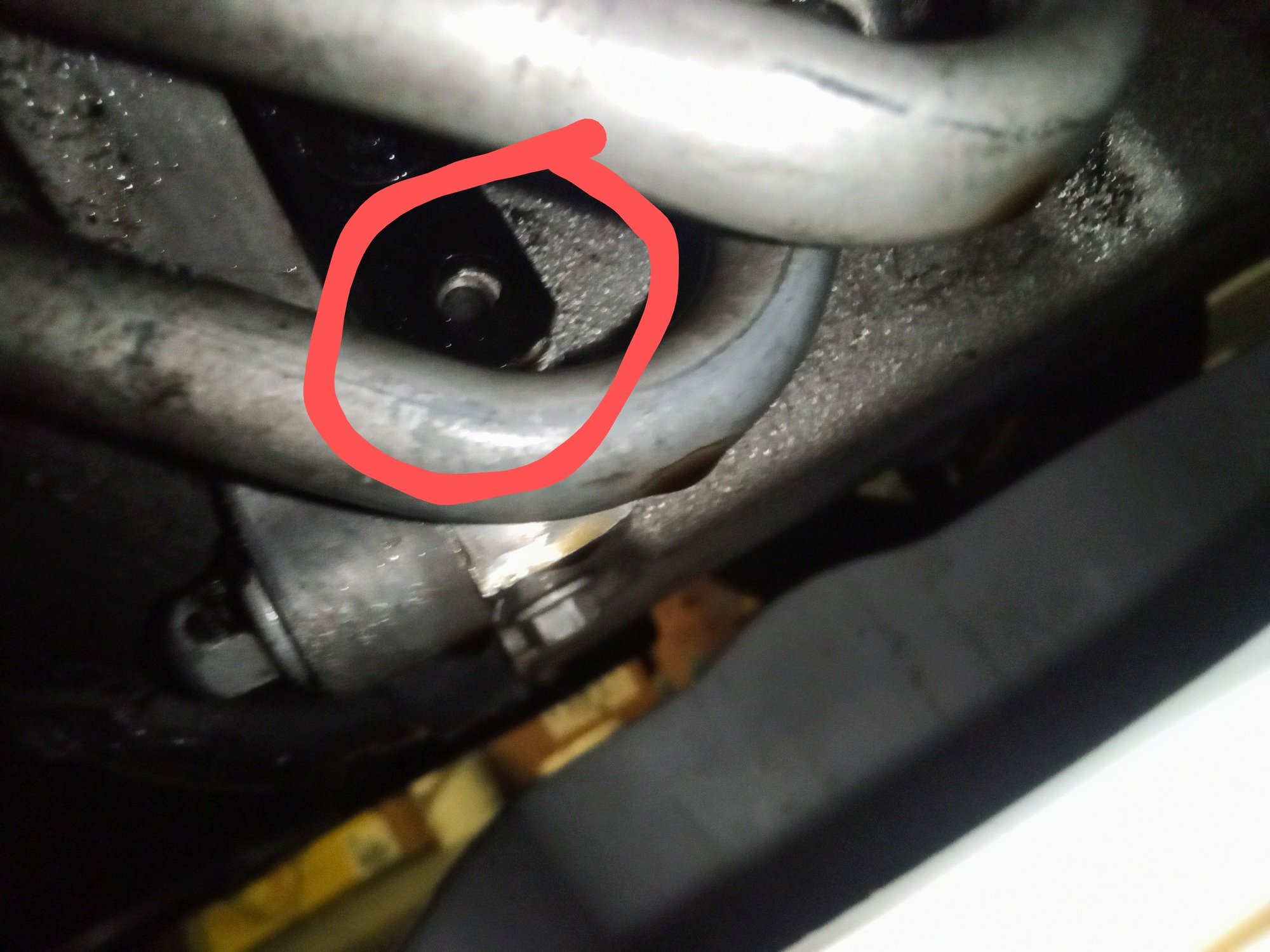

EDIT: Fixed both pcv lines and it is still leaking. It's getting worse and literally leaking in two places. It's Definitely leaking down those two coolant lines on the side of the oil pan, almost looks like there is a bolt missing on the side of the pan there but can't see under the car well enough. It's also coming out the weep hole in the bell housing so either cam sensor or rear main or the pan gasket. With the two piece oil seal on the pan can the rear part be replaced with the torque tube out or does the front cradle need to be dropped? Where do I start? Very fishy the car has two major oil leaks now when it barely dripped before taking it to the shop.

Could have been the slight overfill along with the new front main finally sealing proper might have caused the leak (s) but you never know. Here are some pics, it almost looks like a bolt is missing where I circled on the side of the pan and possibly some sort of plug up there by the starter. Anyone?
Is a bolt missing here?
Is some sort of plug missing here?
Oil running off starter and all over pan.
Oil running down starter
Possible missing bolt?
