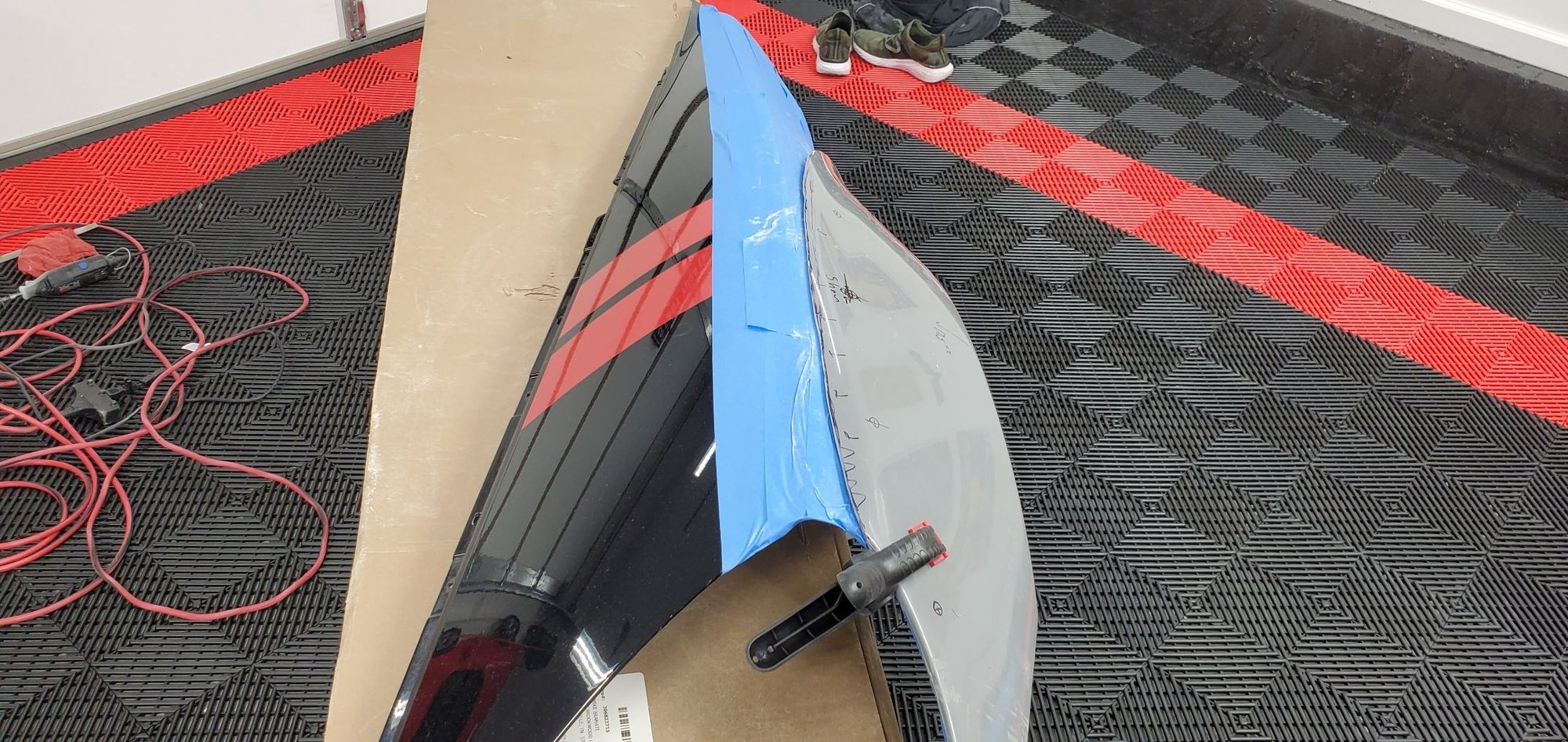

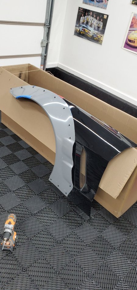

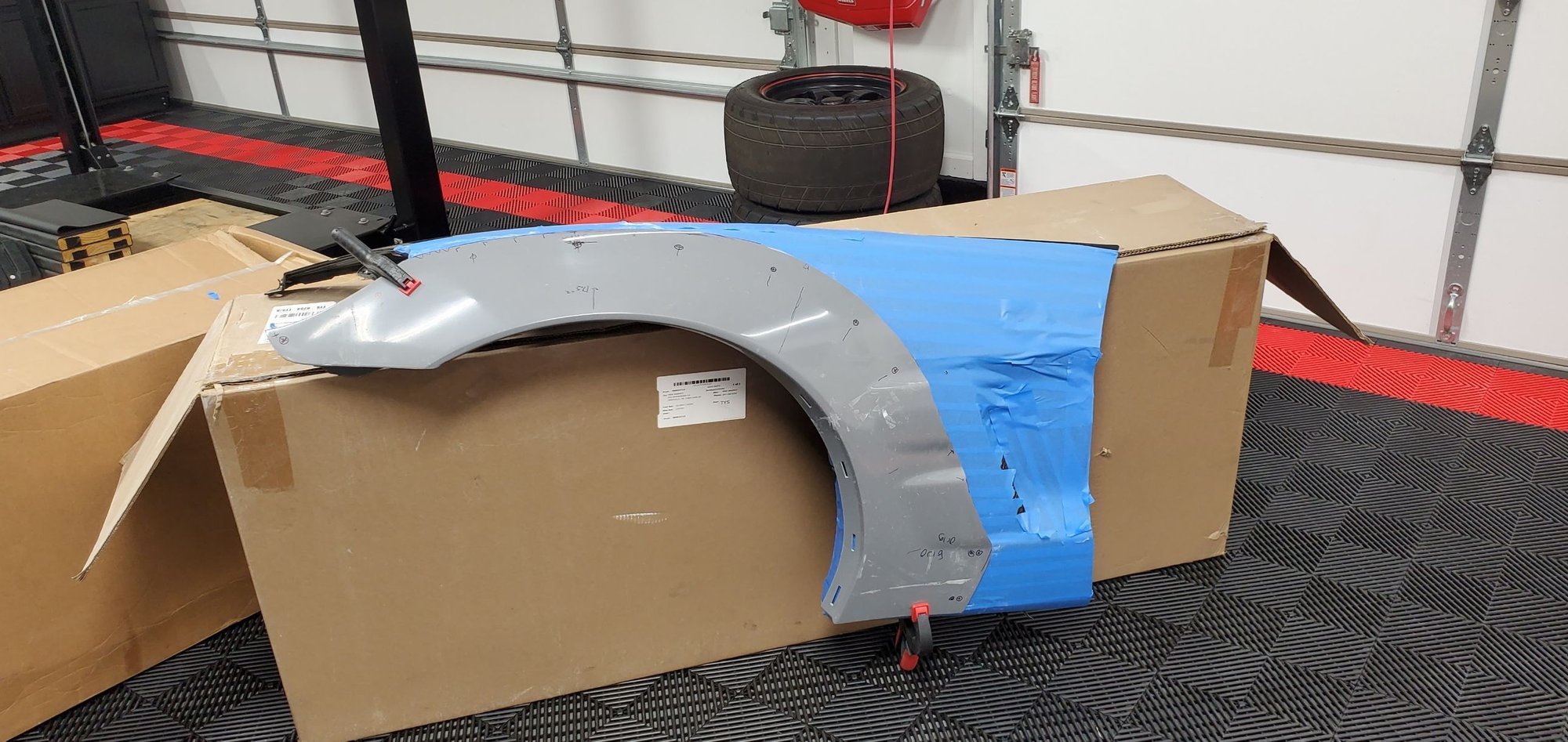

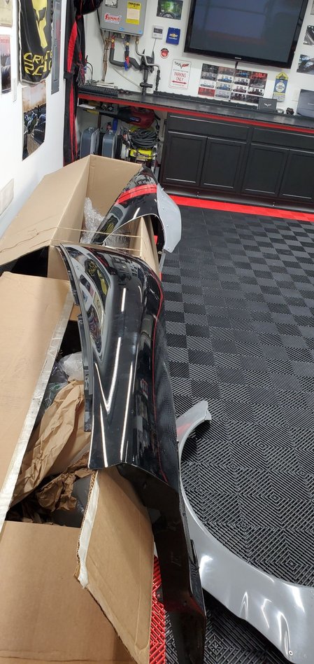

My goal is to show that there are options when it comes to achieving a wide body. Starting with a pair of reproduction front fenders from JD_Corvette on ebay I marked out and cut a portion I could attach to my existing fender. Below are video pics and video of how I did it.

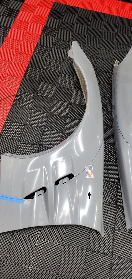

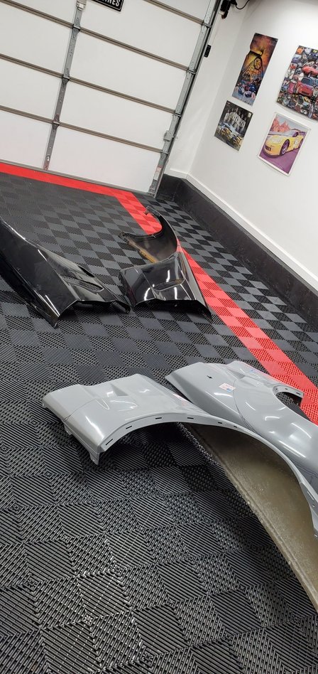

Original narrow body fenders compared to the new repo fiberglass units

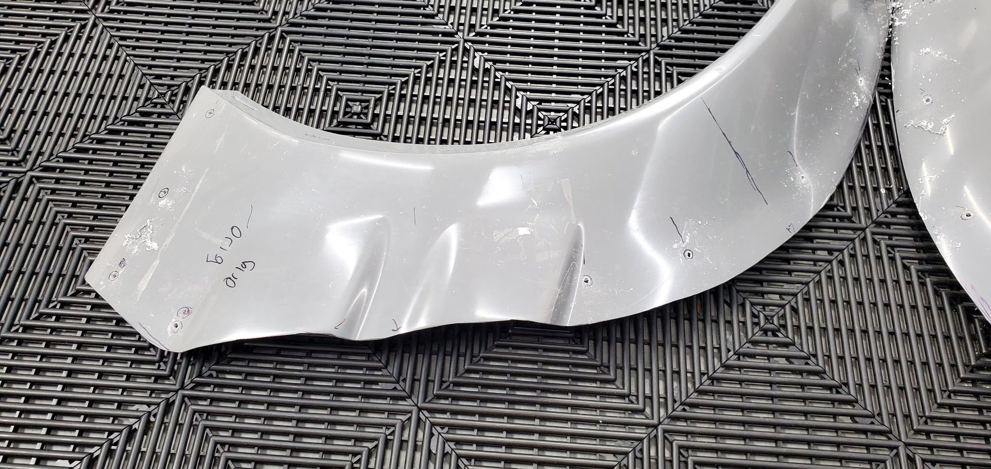

JD_Corvette makes a great fender, never got to check the fitment on the car but they came in great condition and would only require a little bit of prep if the goal was a ZR1 look alike

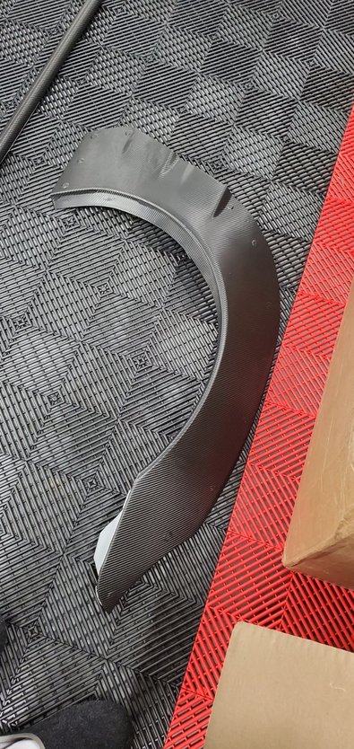

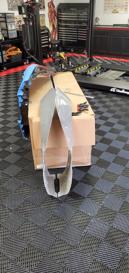

Looking at the contour this was the rough shape I wanted. I had already done this in the rear to fit my drag radials so I got them to match in side as much as possible.
Making them as symmetric as possible

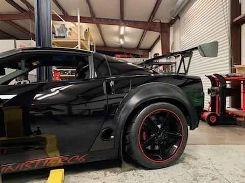

My wide rears

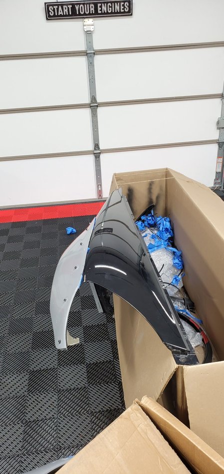

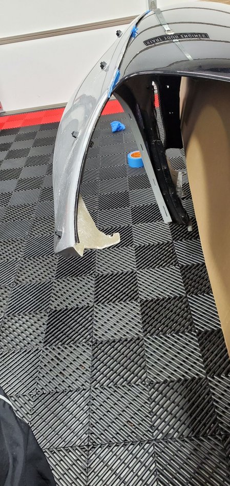

Z06 repo fenders on my narrow body
Fine touches with a file

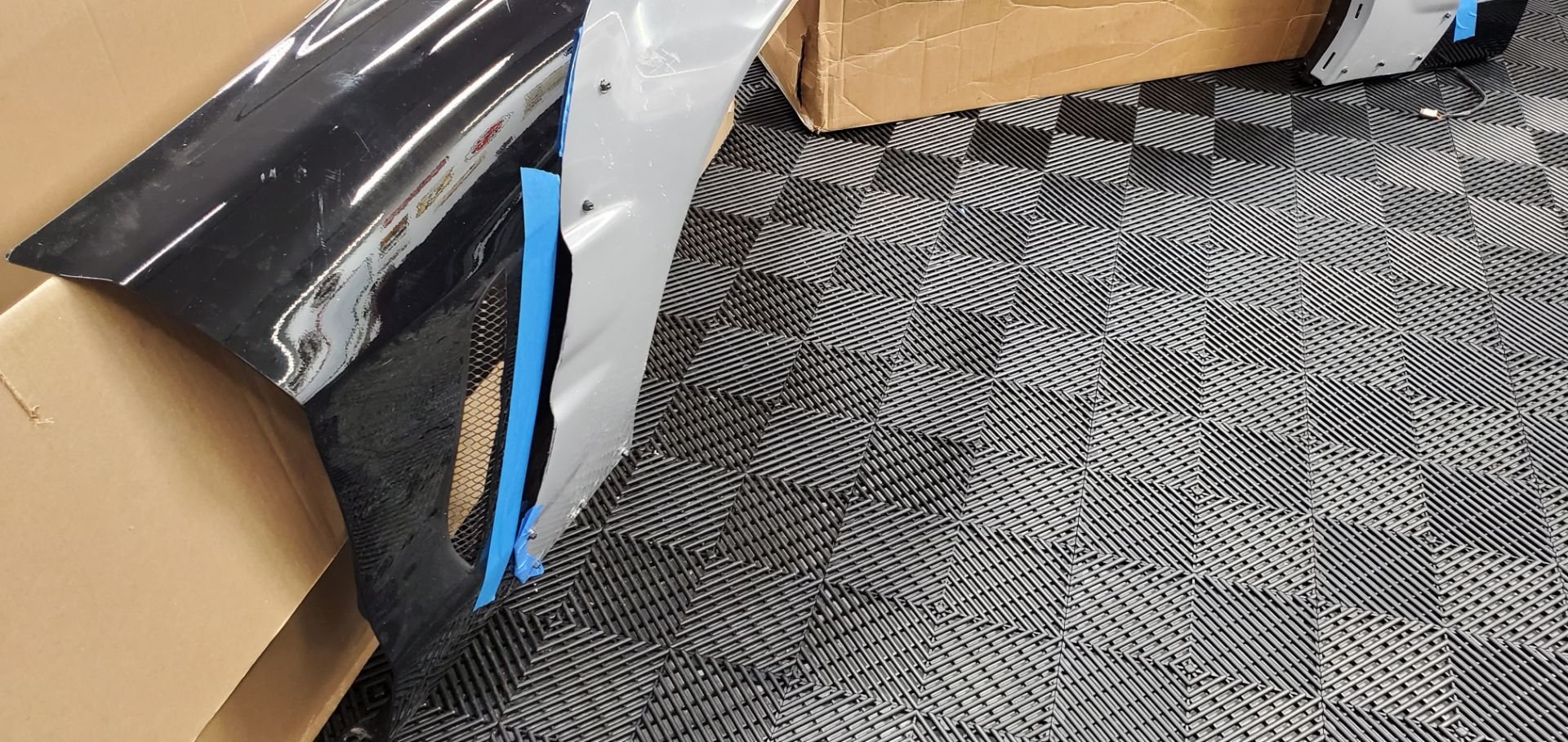

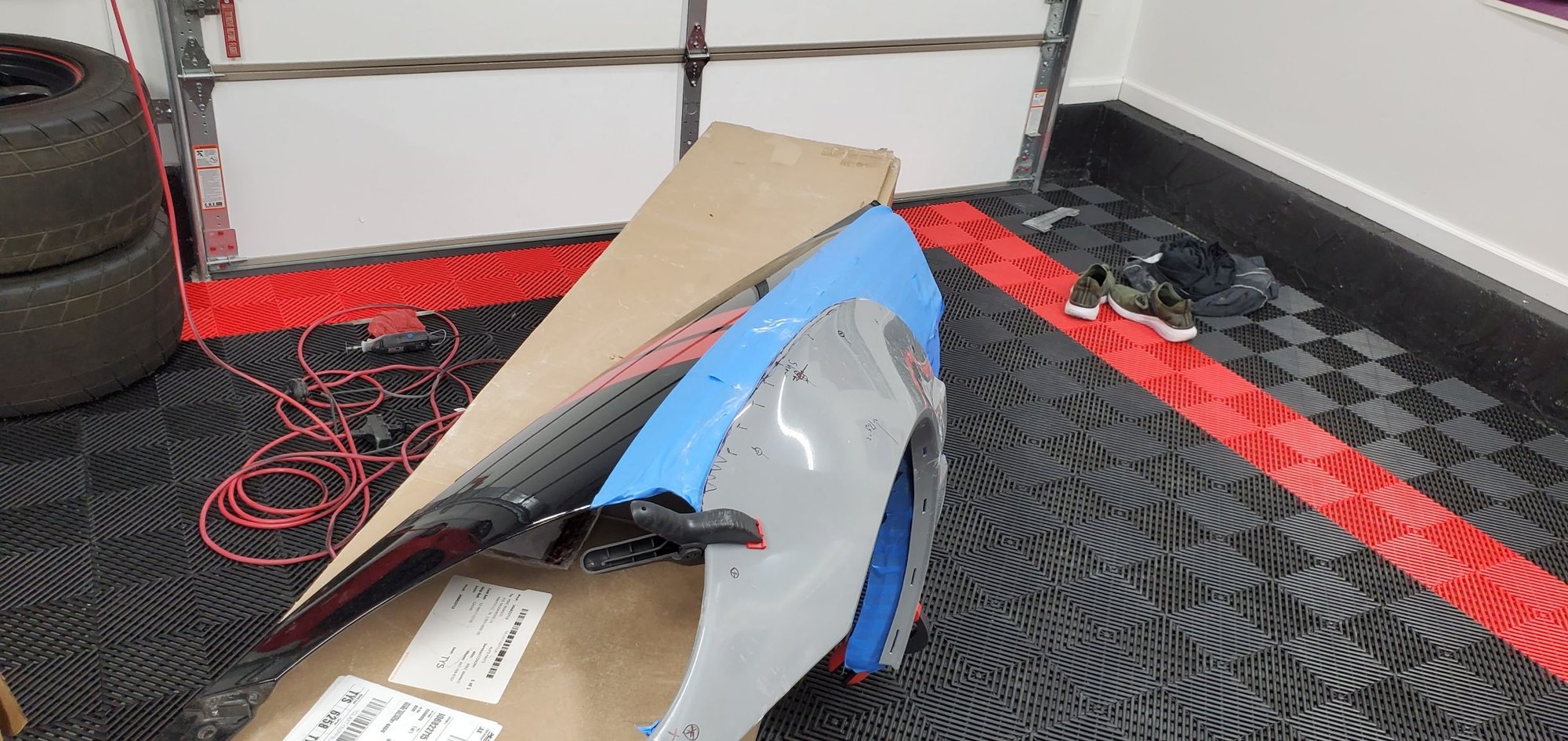

Clamped on to get an idea how it will turn out
Clamped again
and again

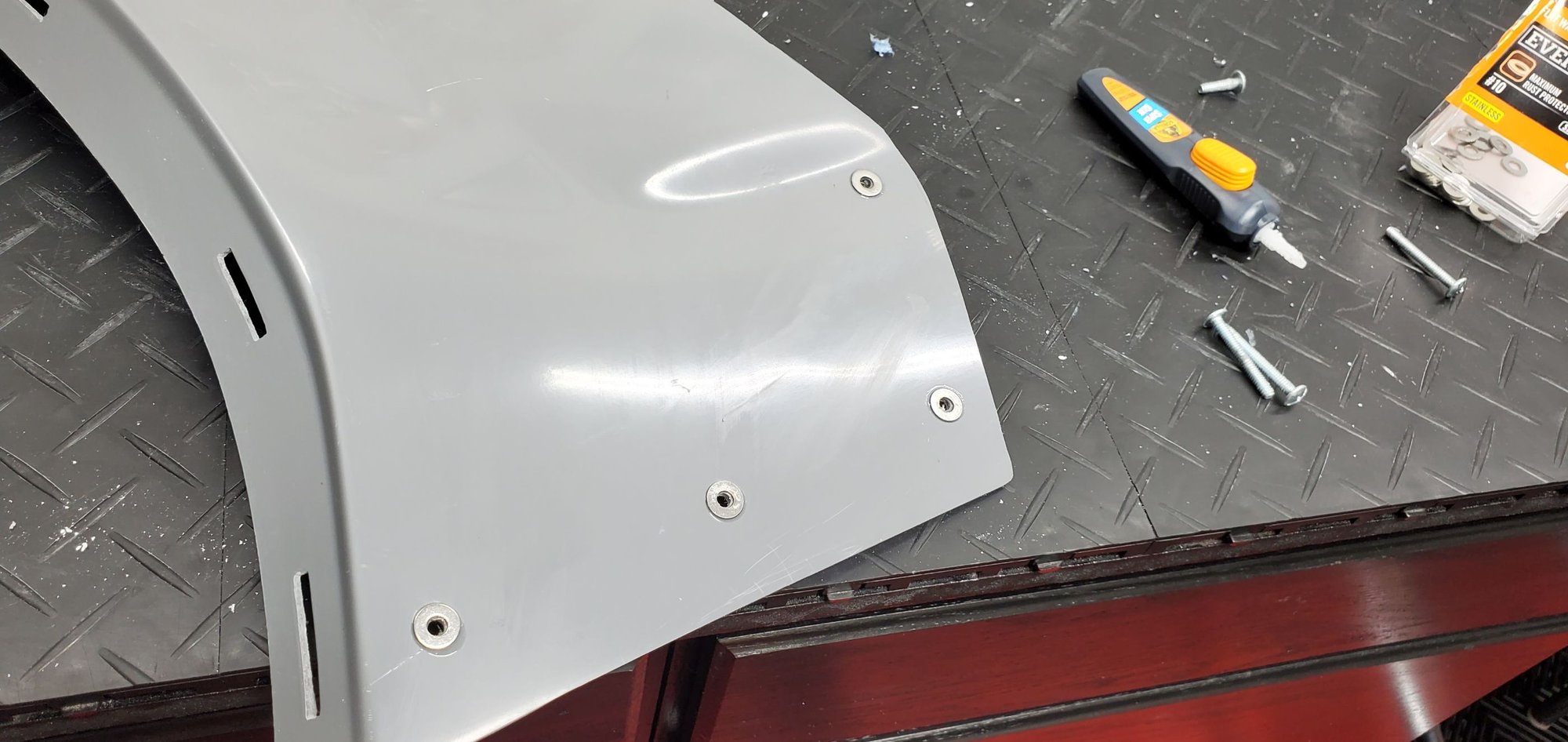

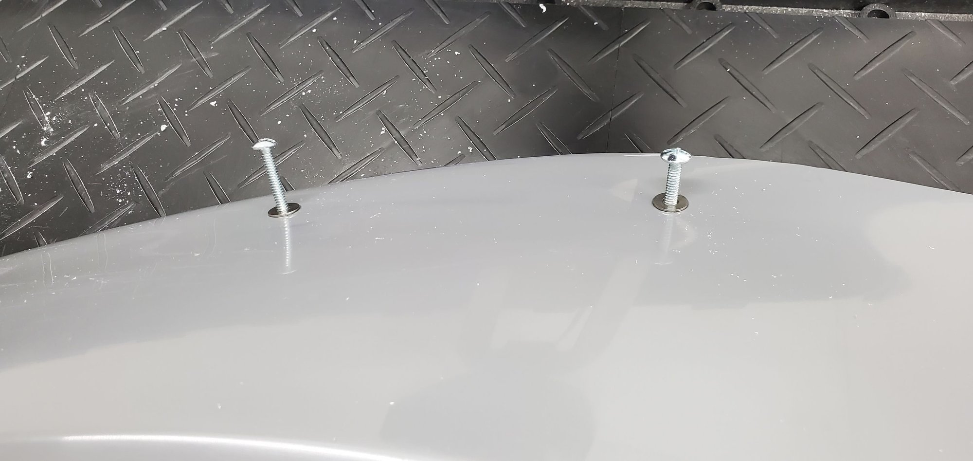

Marked out holes to match the rear's mounting points
Glued in washers for strength
Machine screws to match the rear

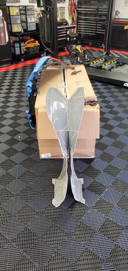

Zip tied in place while I pain hardware
Getting somewhere

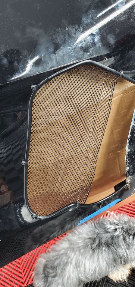

Planning out the vent
Width comparison

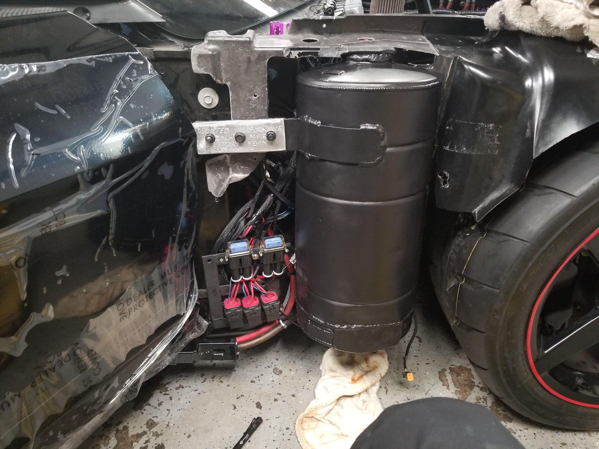

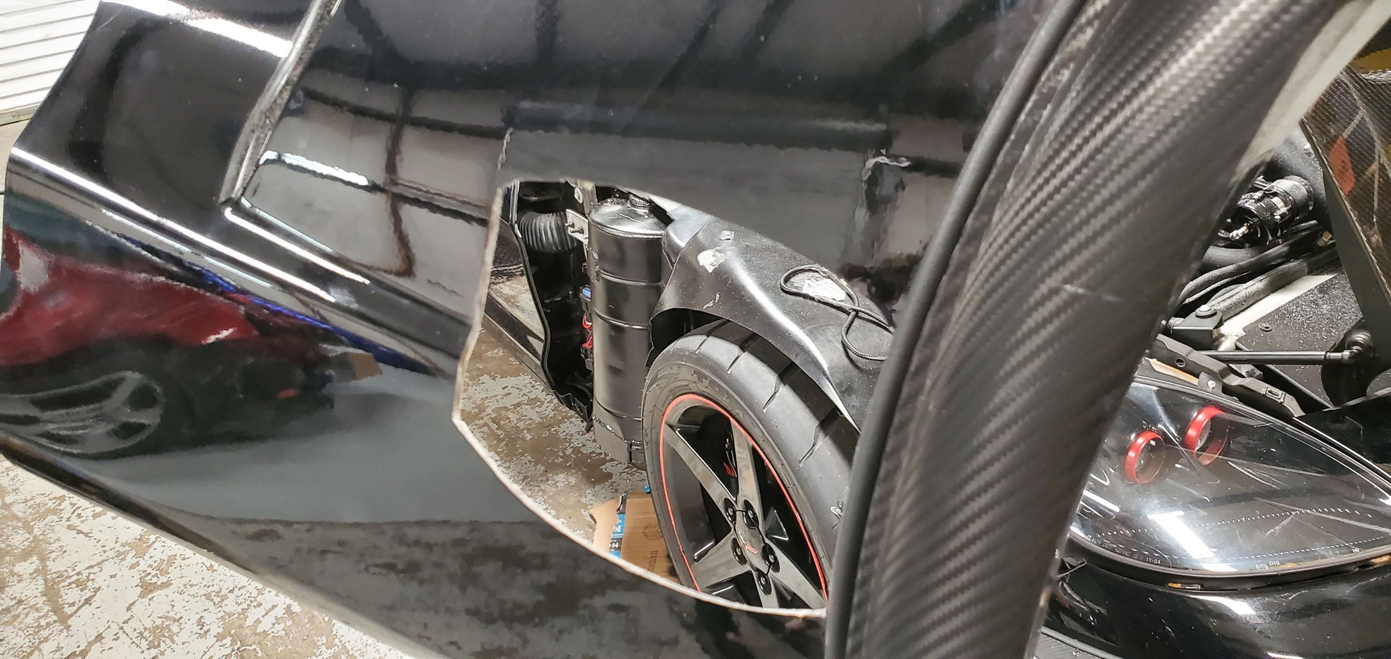

Vent cutout. The bottom was already opened to make room for the drysump tank
4.5 gallons of goodness
Stuck out just a bit

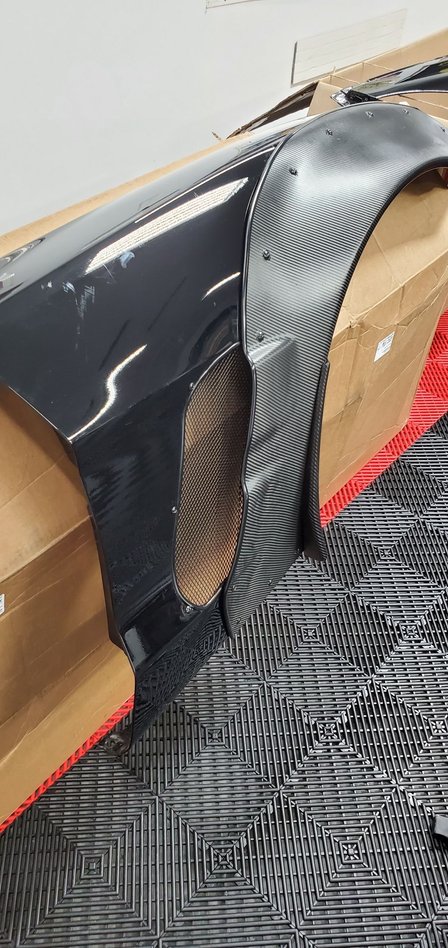

Needed a small window I was never a fan of, the new flares *should* cover this

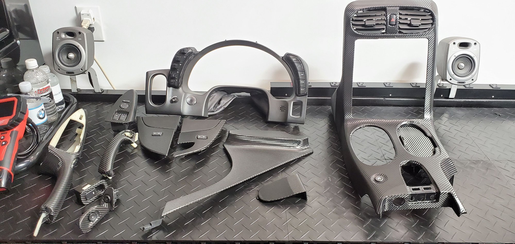

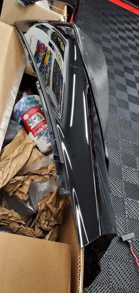

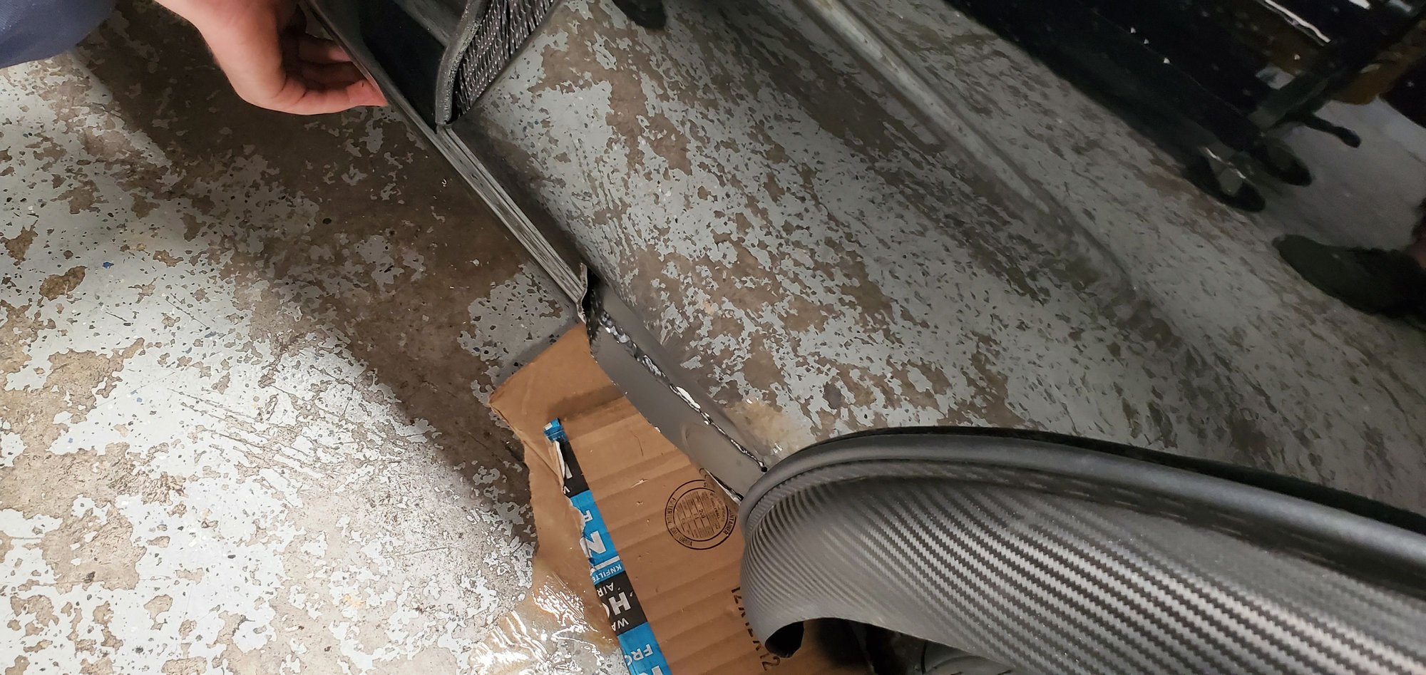

Wrapped the flares in 3M vinyl. Ive used a lot of the CF12 on my interior and covering exterior plastic
The other side
Lots of 3M
Phew it covered the hole
Added trim to protect the edges
Mounted with hardware now
