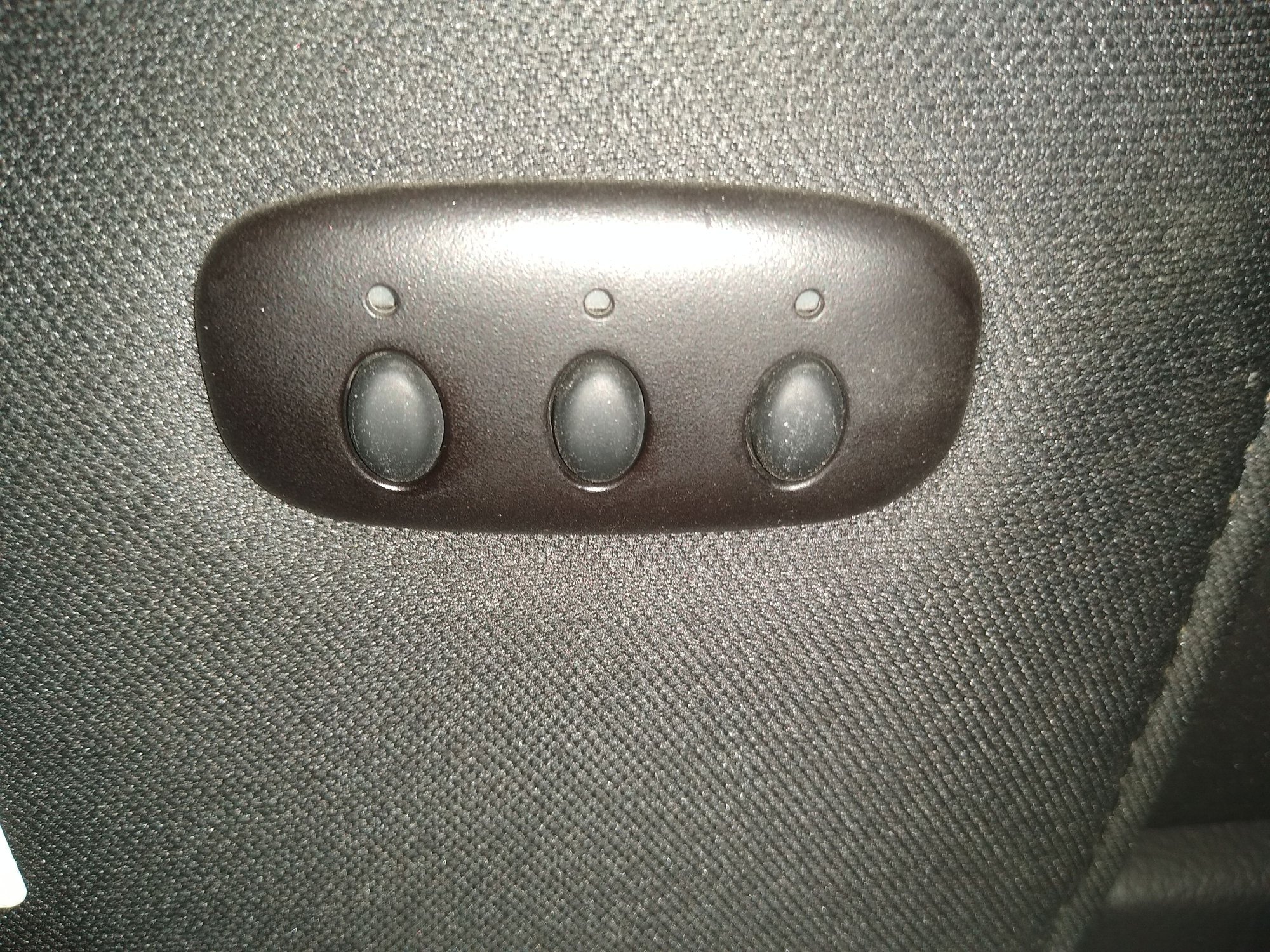

There are a lot of Homelink transmitters listed on ebay. I haven't checked Amazon. Make sure you are buying a Homelink transmitter and not a Lear Car-2-U. Homelink only has one light; Car-2-U has one light for each of the 3 transmitter buttons. The picture is of the Car-2-U transmitter in my 2012 Centennial GS.
