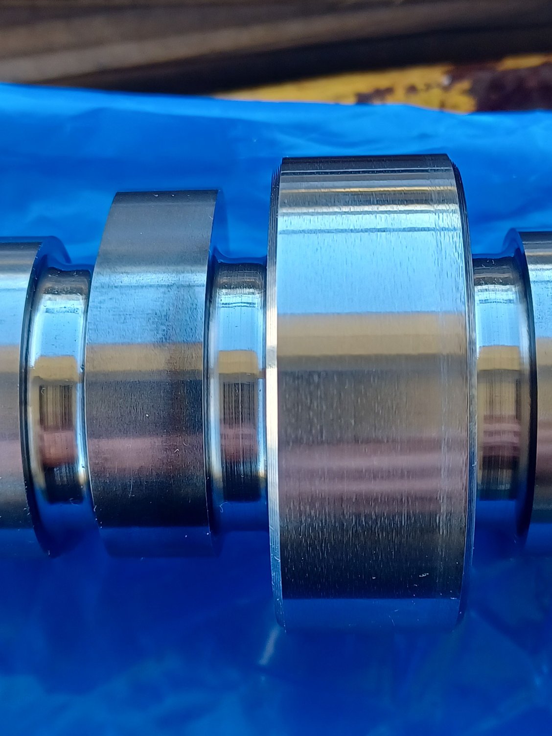

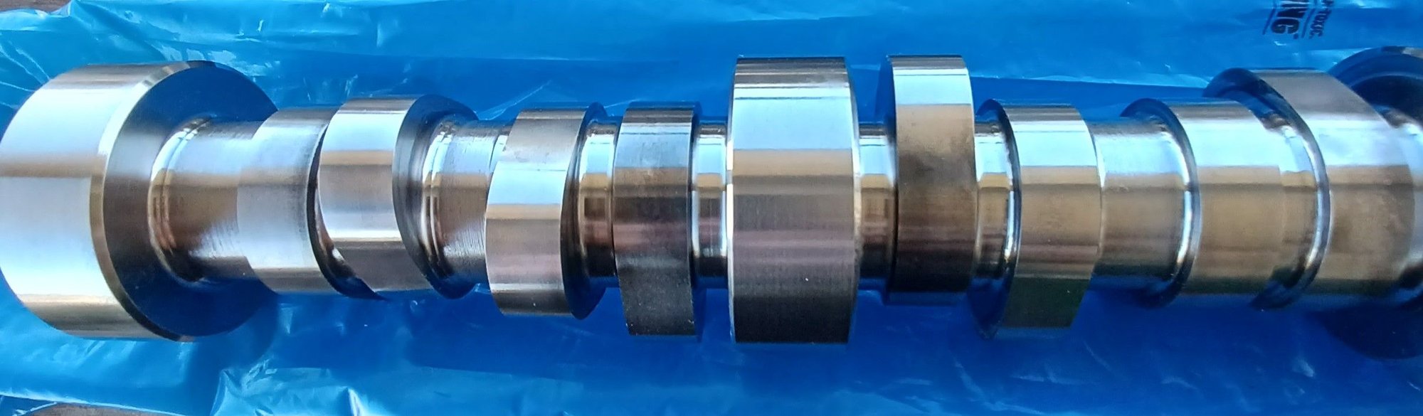

I have a new cam with discoloration on the lobes, it's not something that will wipe off. Opinions welcome.

Don't call the company you bought it from unless that's the same company that did actually grind the cam. Those are the folks that you need to ask some pointed questions. May be no cause for concern, but I'd sure like to hear it from the folks that produced the cam. Let us know what you find out.

old motorhead it was a amazon order for a GM 12638427 LS9 cam that was dropped shipped from the GM ACDelco Parts Distribution Center located at 5115 Pleasant Hill Road Memphis, Tennessee. Production date 2022. Nothing that would grab a nail on the lobes, just nasty looking for a new cam. Now there is one of the cam journals that i can slightly feel with my nail that looks like a single grove but not very deep. Guess I will send it back. This motor only has 4k miles on it.

The Ls9 cam will pass a sniffer test and will be easy on the valve train. That's about where its attributes end. Get a cam guru to spec you a cam and have your neighbor, Cam Motion, grind it. The only downside to having Cam Motion grind you a custom spec is it will cost a little more.

I don't like it. Looks like its been sitting around for a long time and picked up all kinds of debris and filth, and been attacked by the air.

I have the LS9 cam in my 2011 M6 GS with E-force. It is an excellent cam. And it will definitely extend the power curve in the upper RPM's and you won't lose much if anything in the lower and mid RPM's.
As far as the discoloration, it is likely just from the corrosion inhibitor that gets sprayed on it. I would not worry at all about it. Just spray the cam down with brake clean to make sure it is clean before install.
If the discoloration bothers you, you could just swap it out for a new one.
