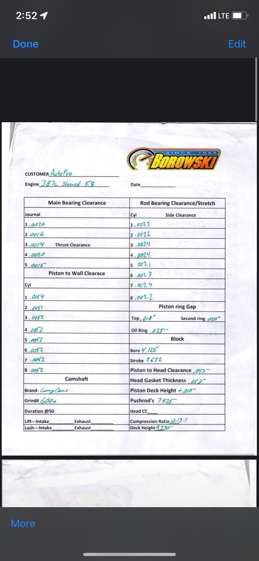

I’ve got a lifter tick and misfire and in the process of tearing down the heads for inspection on my LS3. I hope it’s not a worn cam lobe. I’ve posted the build sheets below. A video is also attached for diagnostic assistance.
Compression tests show 150-157psi on all cylinders.
1)What’s the easiest way to check the cam lobes?
2)Can you guys give me an oil recommendation for this hydraulic roller lifter build?
3)Should I be making more HP with this setup on 91 octane?
4) Best solutions for street use?
5)What do I do if it’s only a high rpm misfire and doesn’t hold the code?
6)Should I get a live scanner?
